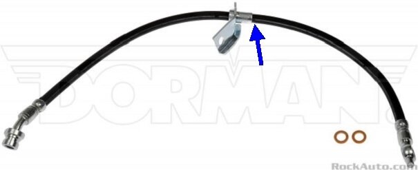

After driving for about 15 to 25 minutes the lug nuts are so hot you can't touch them. It's only the front ones and the mechanic is saying it's not the calipers or the hose. And it's not the hub bearing. What else could this be?

Is it only the lug nuts? If you check after driving the vehicle, is there excessive heat coming from the wheel? When your mechanic checked it, did the vehicle have a chance to sit and cool or did he/she have it when they were extremely hot?
As far as the bearing is concerned, normally, you will hear a humming sound when they are bad. The brakes make more sense, but in reality, they get hot when used and transfer heat from the rotors to the lugs and whatever is attached to them.
Let me know how/when it was checked. In other words, did the tech have a chance to see the vehicle when it was extremely hot?

When I felt it, I took it straight in there was heat coming from the whole area, but I didn't grab anywhere else to see. The lug nuts were so hot they would burn your fingers. They said they checked when it cooled down. But I'm thinking about getting a second opinion. Because I don't see where else the problem would be coming from. They said they checked the rotors, calipers and hoses. And I don't hear any noise as a bearing would put off either. Thank you for responding.

What needed to be done is, when it was hot, lift the front wheels off the ground to see if the tires are easy to turn or if there is excessive resistance. Heat causes things to expand. If that is happening, it will only be evident when hot. Once it cools, the calipers, rotors, and all heated components will contract and release.
Is it possible for you to check it that way?

I asked them to check them while they were hot, but they gave me the run around. So tomorrow when I get it back from having struts put on, I am changing both front rotor and calipers myself. I'm 99% sure that's what would be causing the lug nuts to get hot. There is no noise or anything, just hot as heck lug nuts. I think the mechanic just doesn't want to do it under my 30-day bumper to bumper warranty. Because as soon as I told him I'm buying them and doing it myself. Oh, he could do it for $200.00. No thanks I can do it. I'll let you know if that fixes the issue. And they have had my car for a week and just keep arguing with me.

I never met you, but I like your style. LOL Keep in mind, there are other things that can cause a brake caliper to hang up.
If possible, do what I suggested. When they are hot, lift the wheels off the ground and see if there is excessive resistance when turning the tire. If there is, open the bleeder on the brake caliper and see if you can easily turn it then. If you can, the rubber brake hose is the likely cause.

You're on the wrong track. Hi guys; I had to stick my nose in here before you waste your money and time. Do as Jacobandnickolas described to check if the brakes are locked up. You're right that it's the brakes that are generating the heat, but that's what they're supposed to do. When it's excessive like you're finding, it's because they're staying applied while you're driving.
I agree this has to be diagnosed while the brakes are hot, and the problem is occurring. When it does act up, stop on a slight incline, shift to neutral, release the brakes, and see if the car creeps downhill on its own. If it does not, place a block about a foot downhill from a tire, (so you don't look funny chasing after the car), then use a line wrench, (flare-nut wrench), to loosen the steel lines at the master cylinder. Hope the brakes don't release when you do that. If they do, there's two possible causes. The least expensive cause is the brake light switch is out of adjustment and is holding the brake pedal down a little. That will move the rubber lip seals in the master cylinder past the fluid return ports, blocking them. That keeps the brakes applied and they generate excessive heat. That heat migrates into the brake fluid in the calipers causing it to expand and apply the brakes even harder. On many car models you can identify that by pulling the brake pedal up with your foot.
My bigger fear is the brake fluid is contaminated with a petroleum product, including engine oil, transmission fluid, power steering fluid, axle grease, or penetrating oil. That will cause the rubber parts to swell, including those lip seals in the master cylinder. They grow past the fluid return ports, blocking them, same as if the brake light switch was holding the brake pedal down a little. The only proper repair for contaminated brake fluid is to remove every part that contains rubber parts, flush and dry the steel lines, then install all new rubber parts at the same time. If any rubber part is not replaced, the contamination will leach out of it and recontaminate the new fluid. This is where blindly replacing the calipers is the wrong approach until we know the fluid is okay. The first clue is the rubber bladder seal under the reservoir's cap will be blown up and mushy, and you usually won't be able to pop it back in place. This repair requires replacing the calipers, rear calipers or wheel cylinders, rubber flex hoses, master cylinder, combination valve assembly, and when used, the rear height-sensing proportioning valve, (that's mainly a minivan and pickup truck thing). That also includes the hydraulic controller if the car has anti-lock brakes, as it has rubber o-rings in it and chambers where the old brake fluid can't be fully removed.
I'm hopeful the brake light switch takes care of this, especially since both wheels are involved. When only one front brake acts up first, the rubber flex hose is the better suspect. It's shown in this photo. Any time there's a bracket crimped around the middle of the hose, (blue arrow), it's not uncommon for rust to build up in there until it constricts the hose. You can push brake fluid through that restriction with your foot, but then the fluid becomes trapped and can't release back up to the reservoir. When this happens, the brake will not release when loosening the steel lines at the master cylinder. Now you have to crawl underneath and open the caliper's bleeder screw on the wheel that's getting hot. If both are getting hot, you'll need to open the bleeder screws on both front wheels. Remember to have that block in place by a tire so the car doesn't try to leave you or run you over. You can also do this with the wheel and tire removed.
The other clinker to your planning on replacing calipers is you actually could cause the problem to go away, possibly only for a little while, but we want to know the real cause of this problem first. Years ago it was fairly common for crud and debris to build up inside the calipers behind the pistons. That wasn't a problem until you shoved the pistons back in to make room for a new set of pads. Doing so runs the pistons over that debris which acts like a wedge. When you apply the brakes, the fluid pushes the pistons out just a little, then, when you release the pedal that debris holds the pistons from releasing. A similar problem occurs when a ring of rust develops around the piston. The pistons slide through a "square-cut seal" that bends, or deforms slightly. When you release the brake pedal, that seal wants to straighten out. That is what retracts the piston a few thousandths of an inch to release the pads. When installing new, thicker pads, you have to push the piston all the way back in. That runs the ring of rust under the square-cut seal and prevents it from releasing the piston.
Both of these problems only show up after someone popped in a new set of pads. That is a sign of a do-it-yourselfer, not a professional. At the very least, if that is what is going to be done, use a large flat-blade screwdriver to gently pry the piston back to its fully retracted position before unbolting or removing the caliper. You should be able to do that with one hand. If you have to remove the caliper, then use a c-clamp to force the piston in, as many people think is the normal procedure, you have a sticking piston. You should never have to resort to using that much pressure. If you do, that caliper is never going to release on its own. As far back as the late '80s it was standard practice with a professional brake job to disassemble calipers and rebuild them. Today professionally rebuilt calipers with a warranty are so inexpensive, rebuilding them only makes sense when only rebuild kits are available, and you know how to do it.

Put a new rotor, calipers on and the car listed above (SE model) lug nuts are still getting hot. I asked my mechanic about the hoses, and he said they are good. When I took it back today, he used a temperature gun, and the lug nuts was ready 127 to 134. And he is telling me that they are supposed to be hot.

By nature, there are going to get hot. However, I wouldn't think you should feel the heat radiating from them. Not being there makes it difficult for me to make a determination. If he tells you its normal, chances are it is. I know they get hotter from the brake use.
Have you been able to check if there is any excessive drag when turning the wheels?

I didn't do the test, but they did all the work. Then once I bought the rotors and calipers, they decided to change the bearings. And I'm still under my 30-day bumper to bumper warranty that's supposed to cover all mechanical failures. I shouldn't have had to pay for anything. The only thing they didn't change is the brake hose even though the first time I took it back he said he was going to put new ones on. I told them that the inside could be damaged so guess I'll see what they say Monday. But the lug nuts are so hot they burn your fingers you can't grab them but two seconds.

LOL... I'm in PA and ready to move, I get tired of winter. LOL As far as the hoses are concerned, when they fail, you can force brake fluid through them to actuate the brakes. The problem is when you release the brakes. There isn't enough force for the fluid to return causing them to hang up.

It's in the shop getting new brake hoses, I'm hoping to get it back tomorrow or Friday.

I will. Some people are saying it's normal for the lug nuts to get hot. So, we shall see because everything will be new. The only reason I let the shop do the hoses is because it's covered so why do it myself, lol. But thank you for checking in, hopefully tomorrow I will get it back.

I got told Hyundai Elantra lug nuts do get hot, lol. But there not as bad as they were now I'm dealing with a clunking noise on the passenger side front. And I know it's not the struts because those just got replaced. Now I'm wondering what that could be lol. If you have a Facebook look me up Destanie Nowell.

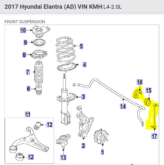

It happens when I hit a bump or any rougher surfaces. And I understand the no social media lol.

The first things I would check would be the stabilizer links and make sure the sway bar is tight and the bushings are good. I'm trying to think of what they may have done by replacing the brake hoses, but there isn't much.
Don't laugh but check to make sure the wheels are tight. LOL
I attached a pic below and highlighted the links and bushings to check. Also, make sure there isn't a loose wheel.
Social media isn't a good thing when one is a teacher. Ugh!!! I can only imagine how bad that could end up.
Let me know what you find.
See pic below.

Thank you, I'll check those and see. If it's not that could it be the control arm?

If there is a worn bushing, yes it can make noise. If you lift the front off of the ground, see if there is any play in the wheel.

Well, I found out the clunking noise was a broken bottom motor mount. At least it is getting fixed.

You're not a pain, lol. It was the hydraulic upper mount that was broken. And as I would drive the motor would move so good thing, I took it in, lol. But I got it back yesterday evening and so far, it is running great. Every now and then I smell a weird smell, but I think it's the new brakes, rotors and calipers at least, I hope.
