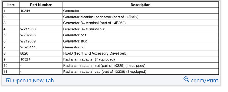

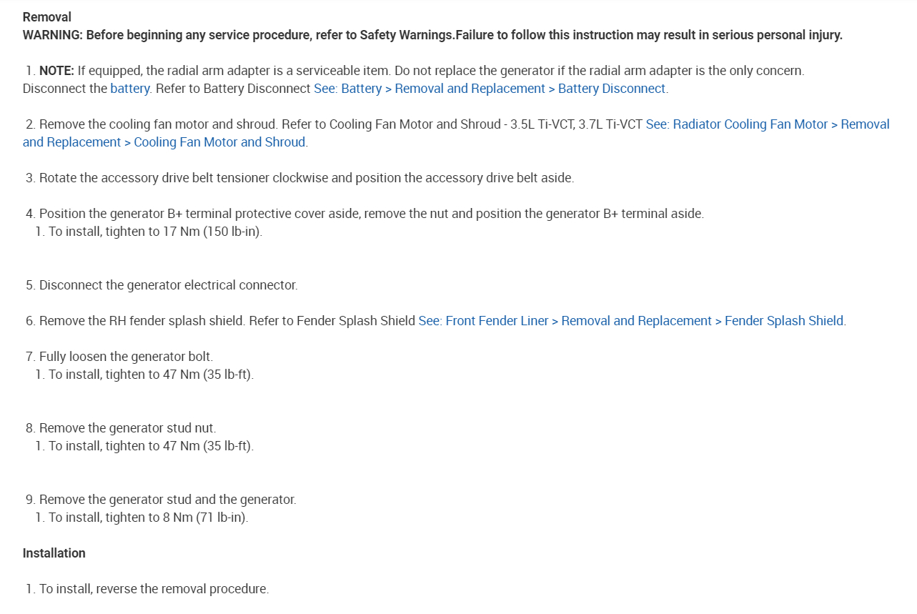

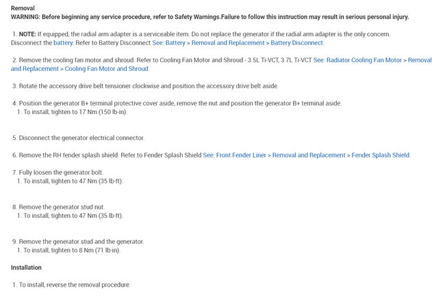

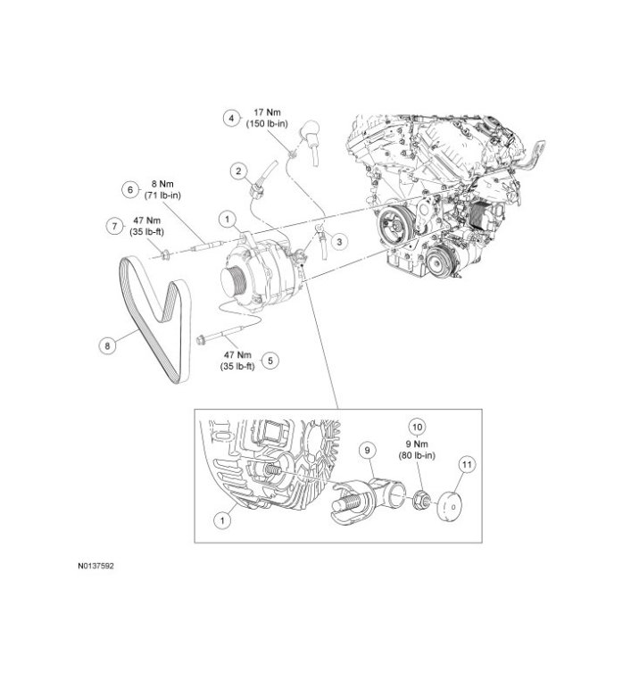

Yes, a bad alternator can cause the battery to go out. I would replace the alternator with a Motorcraft rebuild. Here is a guide to help walk you through the replacement with instructions below to show you how on your car:
https://www.2carpros.com/articles/how-to-replace-an-alternator
