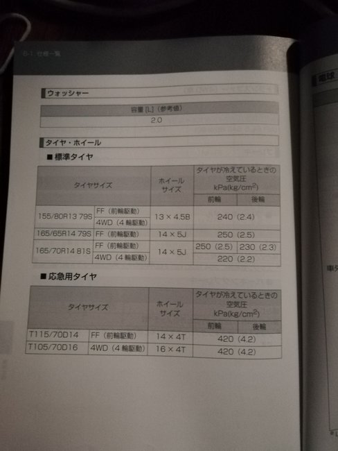

This the page of instruction manual where manufacturer guidance regarding tire replacement has been given. If there are such power issues why manufacturer provide an option to tires with that size?

Japanese like most vehicle manufacturers do not print owners manual specific for one model and for your vehicle, there is 1.3 liter version. The recommendation for the tire pressure is according to the OEM tires fitted and does not necessarily mean is applicable for your vehicle.
When vehicle lacks power you need to accelerate harder to get to speed and that is one main cause of increased fuel consumption.
