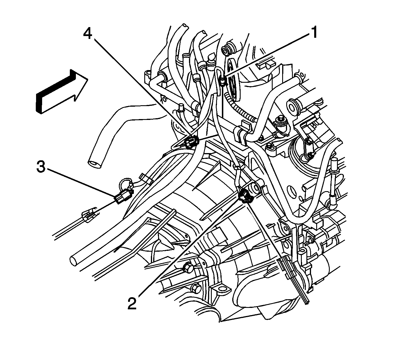

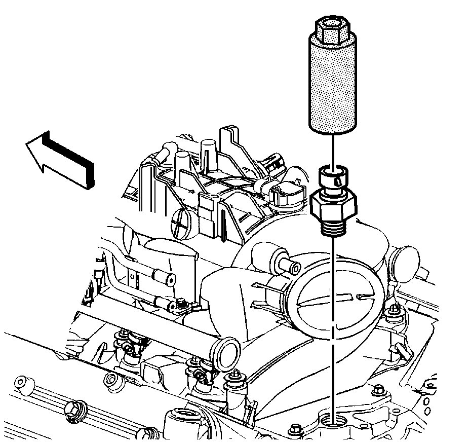

If you feel the pressure switch is the problem, here are the directions specific to your vehicle for replacing it. All attached pictures correlate with these directions.
____________________________
ENGINE OIL PRESSURE SENSOR/SWITCH
Engine Oil Pressure Sensor and/or Switch Replacement
^ Tools Required
- J 41712 Oil Pressure Switch Socket
Removal Procedure
1. Remove the intake manifold.
2. Disconnect the oil pressure sensor electrical connector (1).
3. Using J 41712 or equivalent, remove the oil pressure sensor.
Installation Procedure
1. Apply sealant to the threads of the oil pressure sensor. Refer to Sealers, Adhesives, and Lubricants for the correct part number.
Notice: Refer to Fastener Notice in Service Precautions.
2. Using J 41712 or equivalent, install the oil pressure sensor.
^ Tighten the sensor to 35 Nm (26 ft. lbs.).
3. Connect the oil pressure sensor electrical connector (1).
4. Install the intake manifold.
