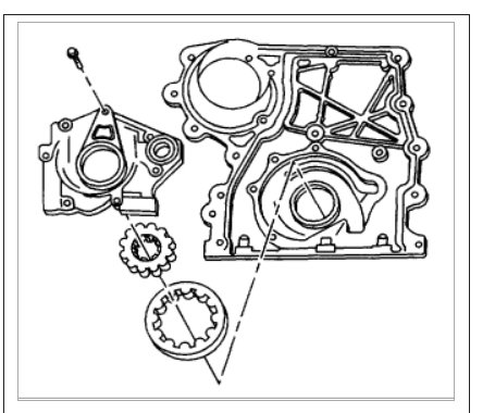

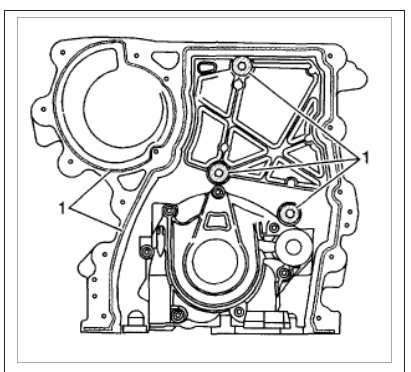

Hi im new to the site and was wondering if anybody can tell me what I should do, My wife was driving the car and the car started to sputter and the low oil pressure light came on and it also said to turn engine off. I was told to replace the oil pressure switch, Its right beside the oil filter so I did, I took it for a test ride and seemed fine. My wife was driving today and it did the same thing sputtered and low oil light came on. Please does anybody have any clue on what I should do or have had the same problem? Yes I checked the oil did and it was full, I even took it in for an oil change when it didn't need one for a few month.

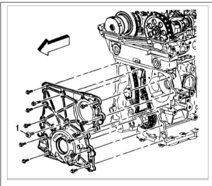

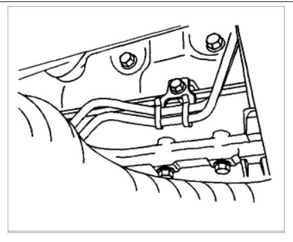

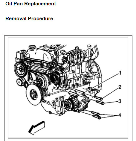

I would suspect a faulty oil pump. If pump starts to fail then there will not be enough oil to lubricate internal parts properly. Here are some diagrams (below) on how to do the job.
You will need to pull the front balancer and timing cover to get to the pump.
https://www.2carpros.com/articles/how-a-harmonic-balancer-works

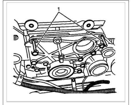

Install the front cover bolts, tightening the center bolt last (1).
Tighten the front cover bolts to 10 Nm (89 inch lbs.)
I would check the oil pump pick up as well because if there is a sludge in the engine it will plug the inlet to the oil pump.

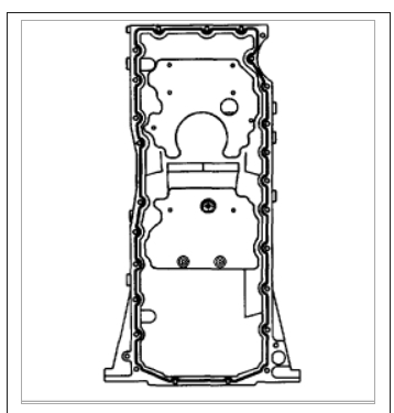

I have the same problem. I have had the car at several shops and finally the dealer. I had the oil changed, which helped for a day. I next had the sensor changed, worked for 3 or so days. I had a master mechanic look at it. He ran he engine for an hour and a half on his manual gauge. Although the cars oil pressure ran low, he said it never went below spec. He told me the engine was going! No knocks, no noise, no nothing. I finally brought it to the dealer who ean complete diagnostic check. They not only found nothing, they couldn't get the problem to even occur while there. They ended up resetting the computer and since last sept. When I picked it up I have not had a problem. Until today. Everything else about the envoy is great! I have read that higher viscosity oil may help or even solve the problem in the summer months. This is the first summer I have the car so maybe its the heat. Then I went ahead and took the oil pan off and sure enough sludge. Now clean I have no more problems.
The 2004 envoy has about 128k. Thanks
