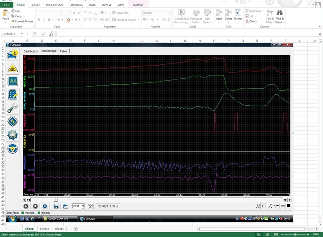

From cold and on tick over voltage drops from 14.3v, to 12.2v, after about 4 minutes. A few milliseconds later the rpm drops from 1100 to circa 500 (recorded on a diagnostic tool). This lasts a few seconds then voltage returns to 14.3, RPM surges and then stabilises around 1000. It may happen a couple of times whilst getting to temperature, but once at operating temperature is fine.
I have changed the coolant sensor, bank 1 oxygen sensor, throttle control body and the MAF sensor. I have also checked for vacuum leaks. There are no error codes.

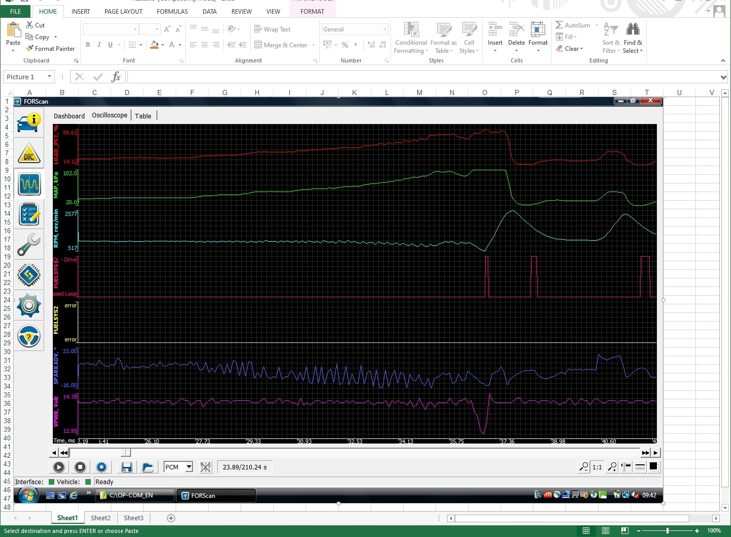

It is a 1.25 (UK spec) which is the same engine as the 1.6, just with a smaller bore. It has the later electronic throttle, which has the IAC incorporated into the throttle control body, which I have changed. The voltage drops a couple of milliseconds before the RPM, as the vehicle warms up, which suggests a short to me, as something is activated as the engine gets to temperature. I have run it with a spare coolant sensor attached, it obviously leaves the 'choke' on thus keeping the revs high and the voltage drop never happens. Again suggestive of a circuit being opened as the vehicle reaches operating temperature.
attached is a screenshot of it happening from my diagnostic tool

When you get the voltage drop, where are you getting that reading?
Nov 18, 2020 at 12:19 PM
MIKE GLADWIN
Forscan diagnostic readout via the OBD2 port.
Nov 18, 2020 at 3:49 PM
  • 110,236 POSTS
I'm questioning if it has something to do with the alternator itself. Does it seem like it is consistent timing when it happens and the voltage drop is the same all the time?
