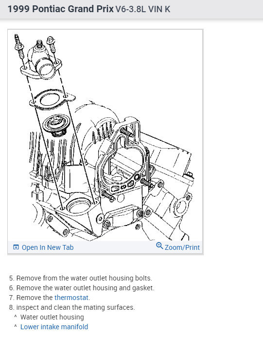

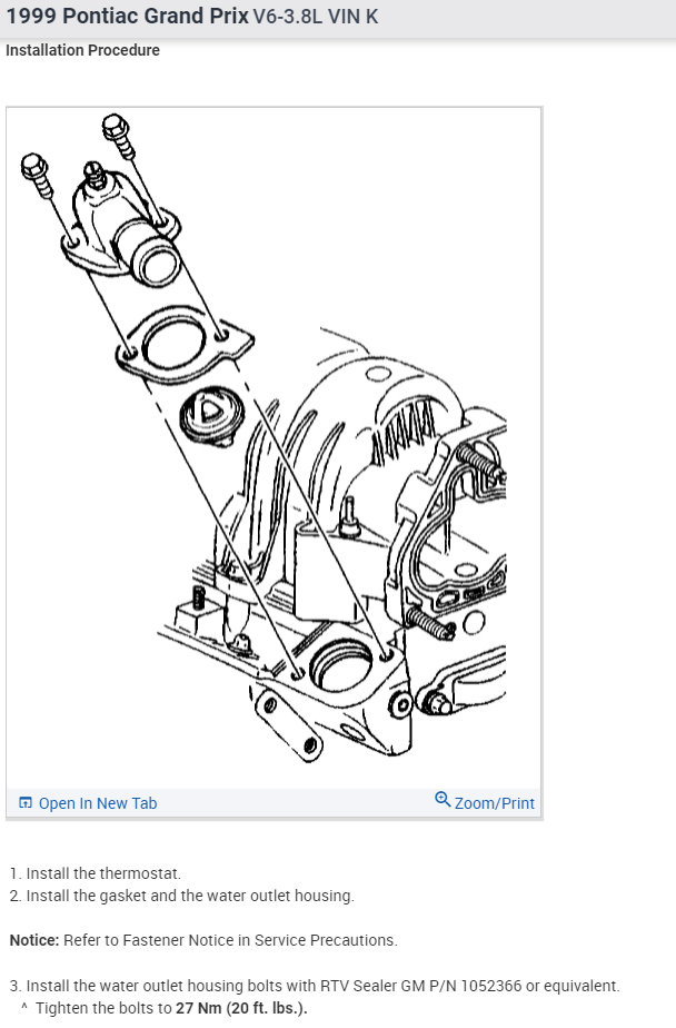

This could be due to a stuck open thermostat.
If the thermostat fails in stuck open position, it will not allow the engine to reach operating temperature. Which will lead to the heater not being able to blow warm/hot air due to the coolant being lower than idea temperature.
Usually this will be noticeable on the temperature gauge, as it will not reach the operating temperature range on the gauge.
The operating temperature for this engine is 188F to 206F. So, if the engine is not reaching that temperature, it could be due to a stuck open thermostat.
https://www.2carpros.com/articles/how-an-engine-thermostat-works
