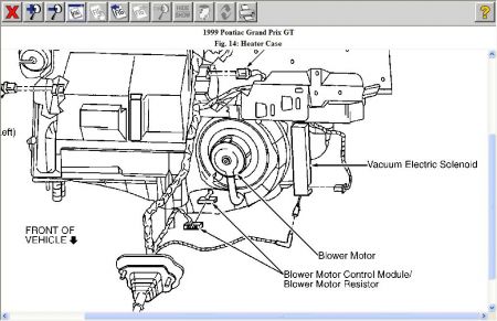

i own a 1999 Pontiac Grand Prix and the heater motor only blows on high what may be the problem and what is the easiest way to repair

Find the blower motor resistor and replace it-its located below right side of dash

Do you have a picture of where the resistor would be located

There you go
