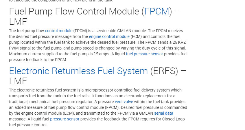

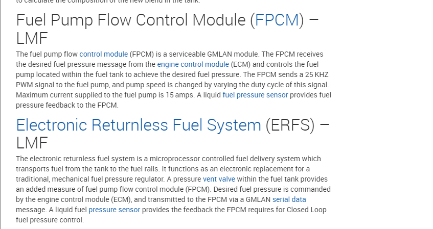

I am also attaching the info you requested on this system but basically it is just an electronic regulator that allows pressure to bleed off depending on what the ECM is commanding.
So, let's start with the code and then we can get the testing or a better idea as to what the issue is.
