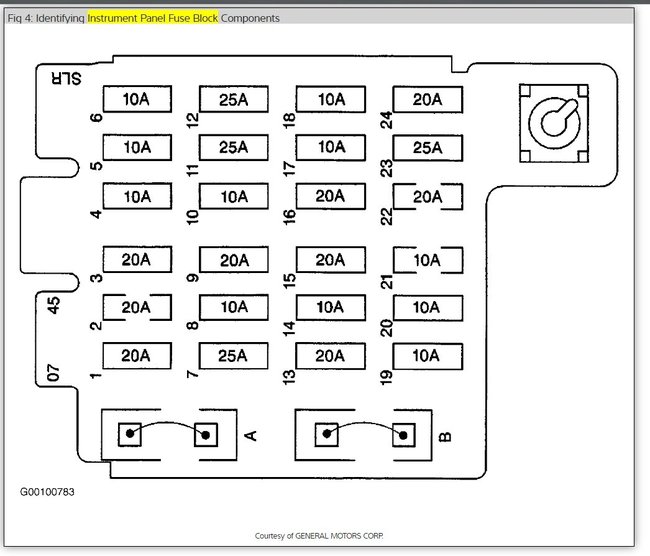

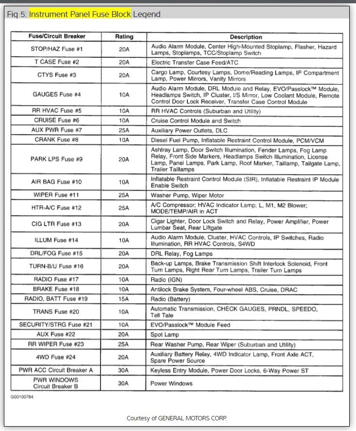

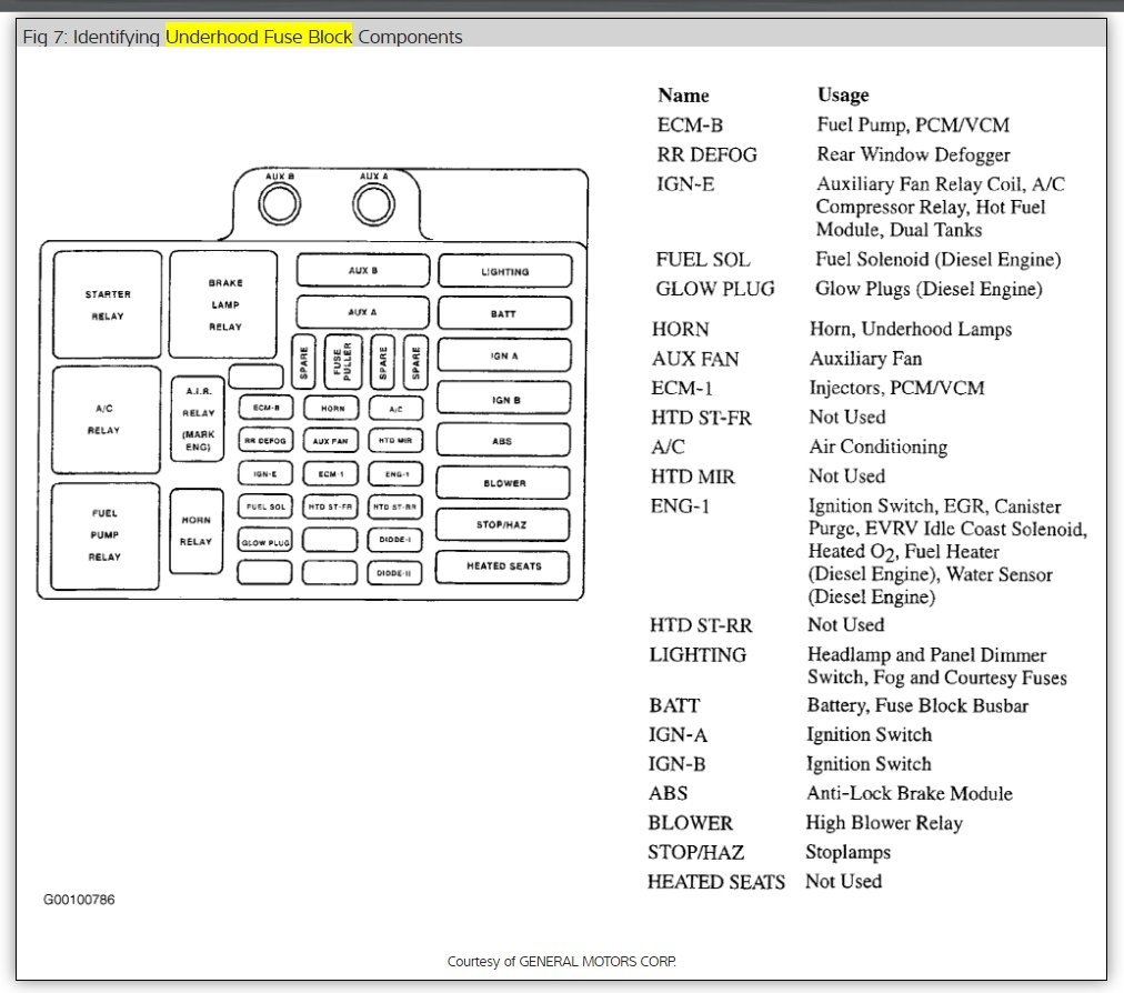

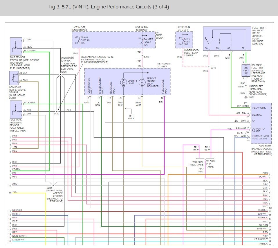

The truck died a couple of months back and I determined the fuel pump wasn't working. I replaced the relay and the pump. Now the pump is not working again. I also replaced the ignition control module. When I turn the key to the on position, the theft deterrent system makes a double clicking noise. I can't recall if that is normal. With the key on, I have closed the contact on the relay and still don't get the fuel pump on. The fuses are all good. I suspect that this is either the theft deterrent system or the ignition cylinder. How do I determine where the fault is before I pour more money into parts. Thanks for any help.

Does it crank or turn over? While its turning over is the scurity light on? Theft sys disables the starter
I need your engine size for a wirring diagram for the pump and if you have duel tanks

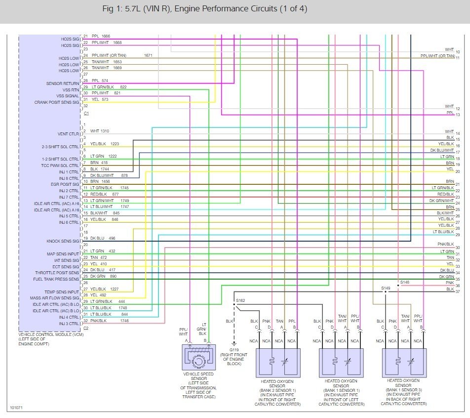

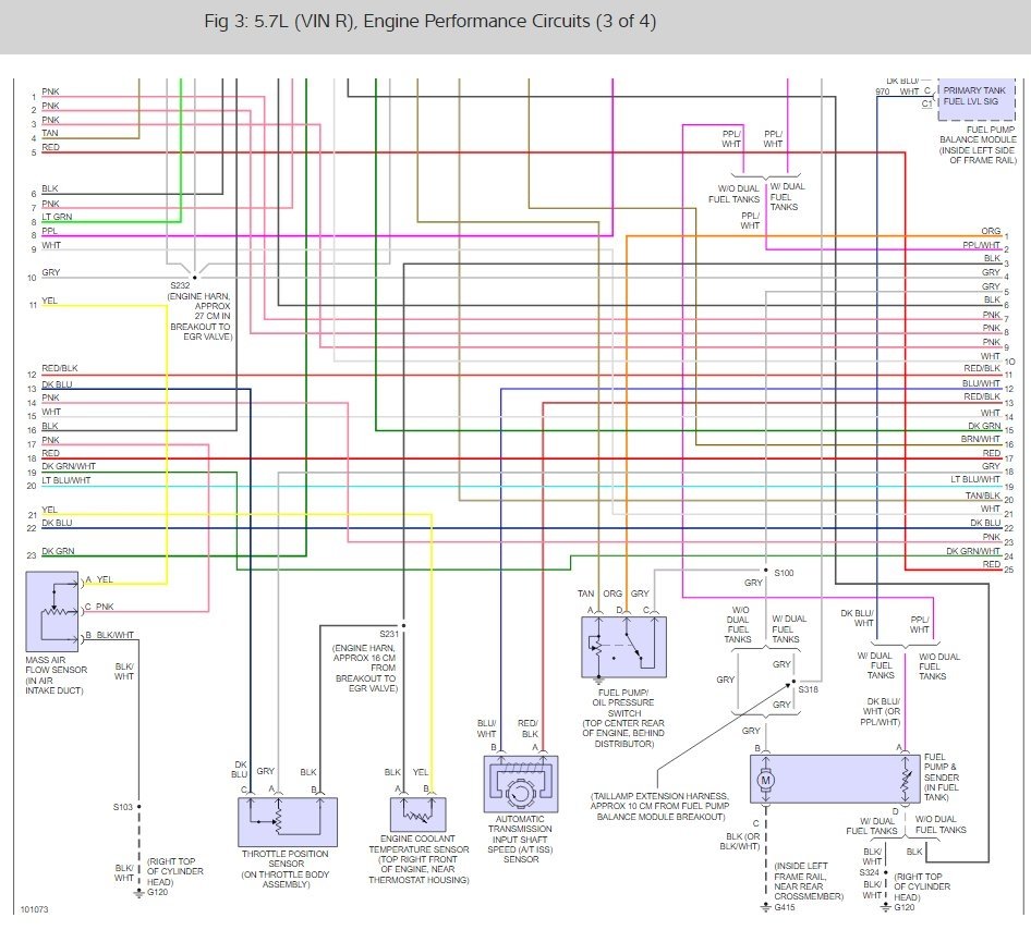

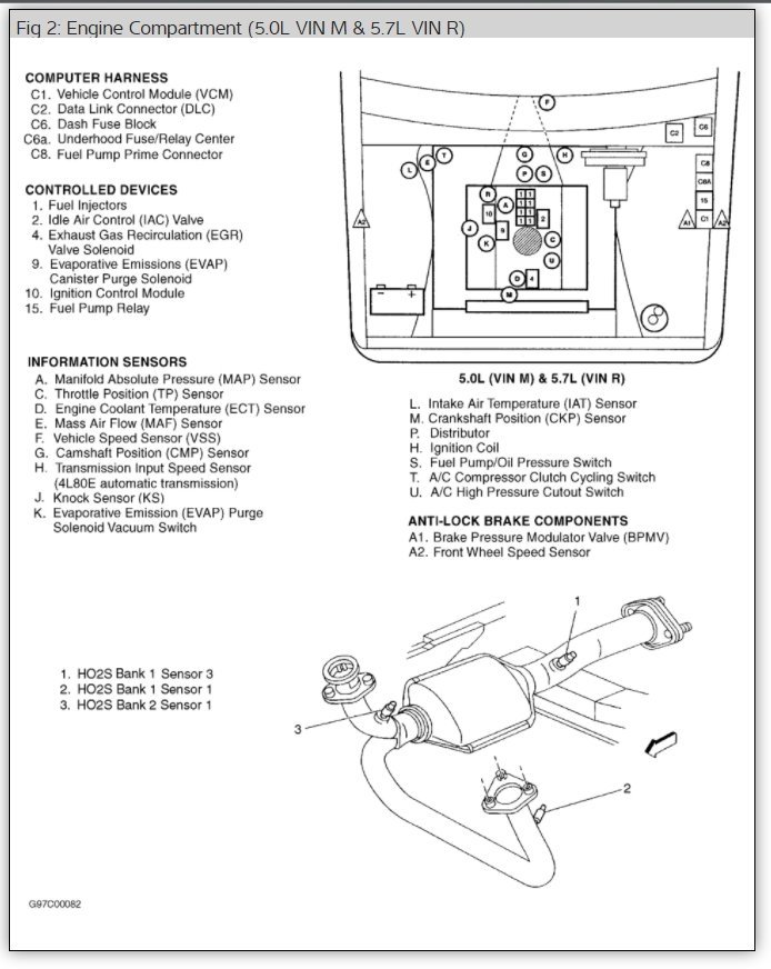

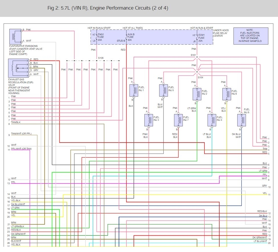

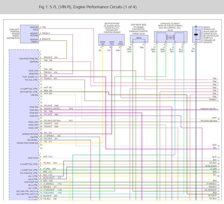

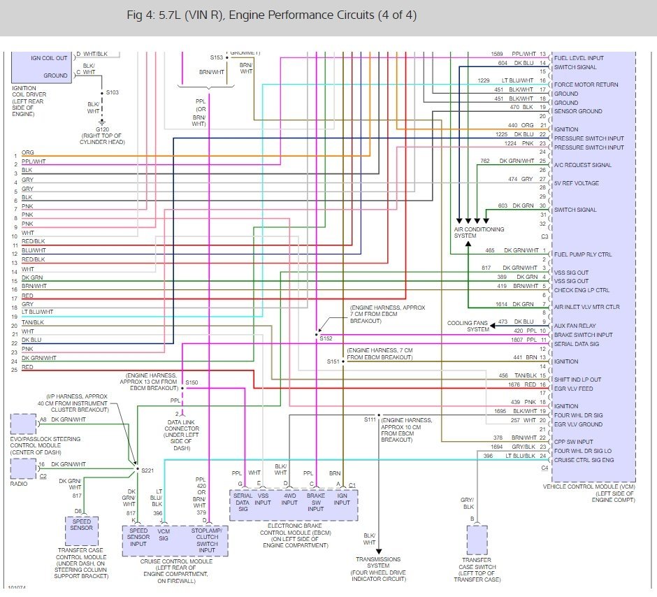

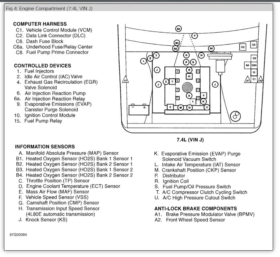

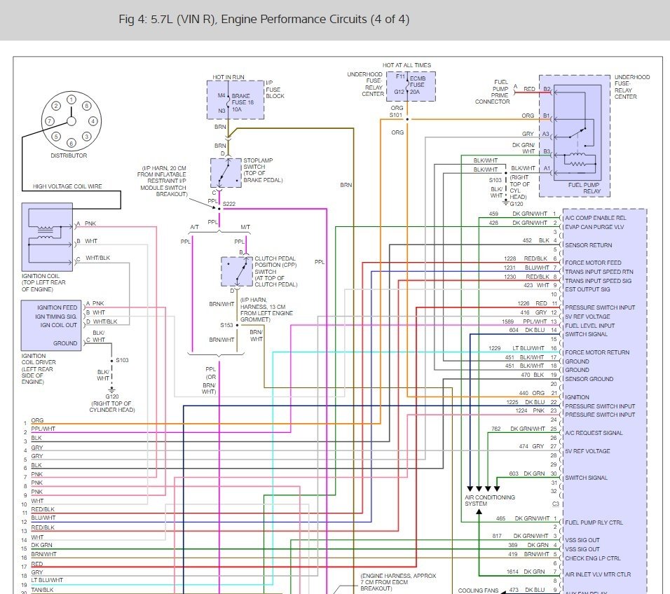

It sounds like the fuel pump relay is not working or there is a power supply issue. Here are some guides to help you test for the problem along with a fuel pump wiring diagram (below). Test to see where you are loosing the power from.
and
I gave you all of the engine wiring diagrams in case it could help.
Please run some tests and get back to us so we can continue helping you.
