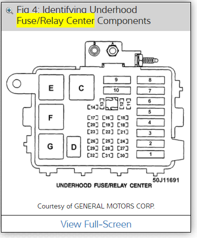

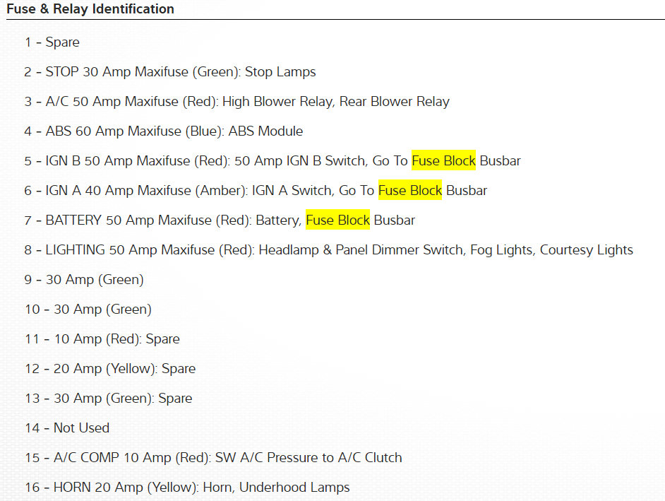

Where is the fuel pump fuse located?
Feb 15, 2010 at 11:10 AM
  • 75,992 POSTS

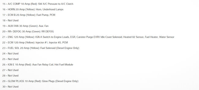

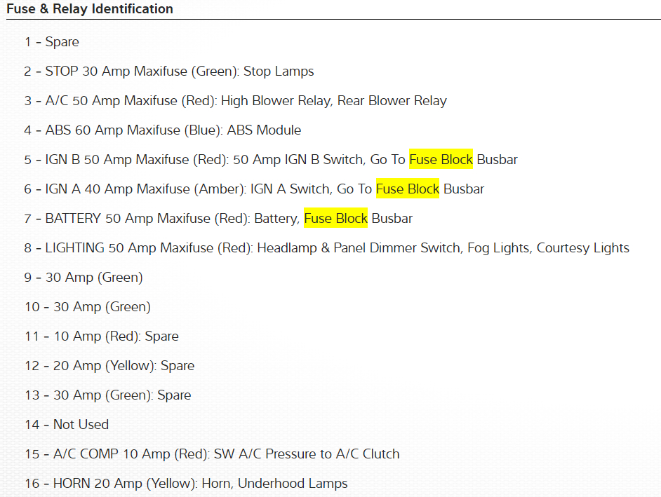

The fuel pump fuse (IGN E) is located in the PDC under the hood here is a guide to help test for power and the fuse location below.
Feb 15, 2010 at 11:25 AM
ASCLARCH
I was driving and the suburban quit at a stop.I found the 25 amp fuel pump fuse blown replaced it. Tried to start nothing. I looked for other fuses and found the ECM 10 amp fuse blown also. I replaced this too. It started right up. Go to shut it off after it runs for 10 minutes and it won't shut off with the key. I tried 3-4 times and finally pulled the ECM fuse. I tested 3 times and does the same thing. I unhooked the battery to reset and same thing. If I pull the ECM or INJ A/B fuse it will die but the key does nothing. The switch seems to work the radio and tach (aftermarket hooked to distributor and fuse box) shut off with the key. The guages stay on when key is in off engine running. I pulled the ignition module out from under the dash and could start it but not shut it off with it. While it was running I pulled the wire plugs out of the module and it countinued to run. It should have stopped with the wires unhooked I believe????
