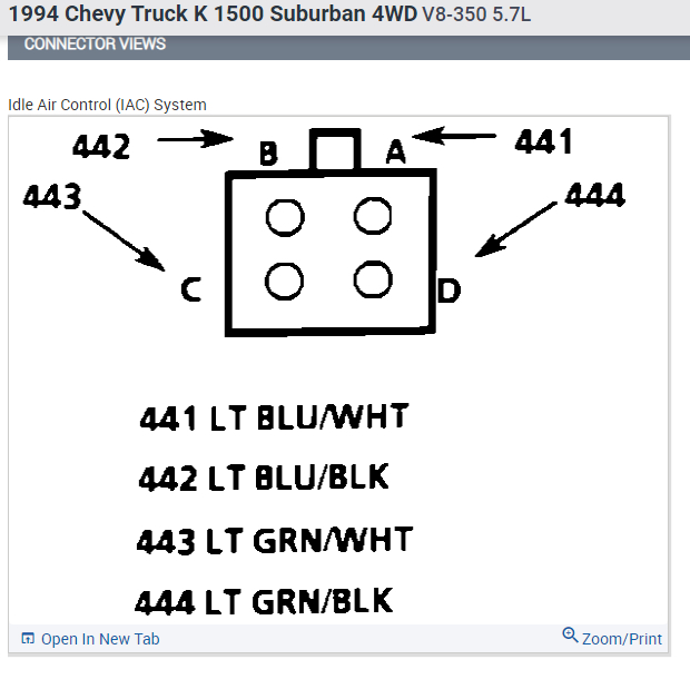

My SUV seems to have moments where it stalls or if I don’t give enough gas it will shut off on me at times. I have a 6 inch lift kit on it and 35 inch tires and I have a lack of power in the engine. I thought it may be because of that but do to the stalling of the engine and severe lack of power going up hills I believe there’s something else wrong. It has a new engine in it and new transmission but still is not providing the power I had hoped for. I can get decent power in the low gears but once I start to drive above 25 acceleration is a joke and makes it hard to get up to 70. Going faster than 70 is a prayer. That can make it tough out here on the California freeways. Just replaced fuel pump and filter. Every once in a while the engine will make a pop noise while trying to accelerate.

Does the vehicle have rough idle or low idle?

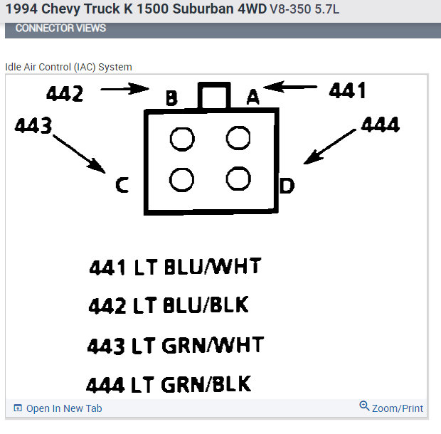

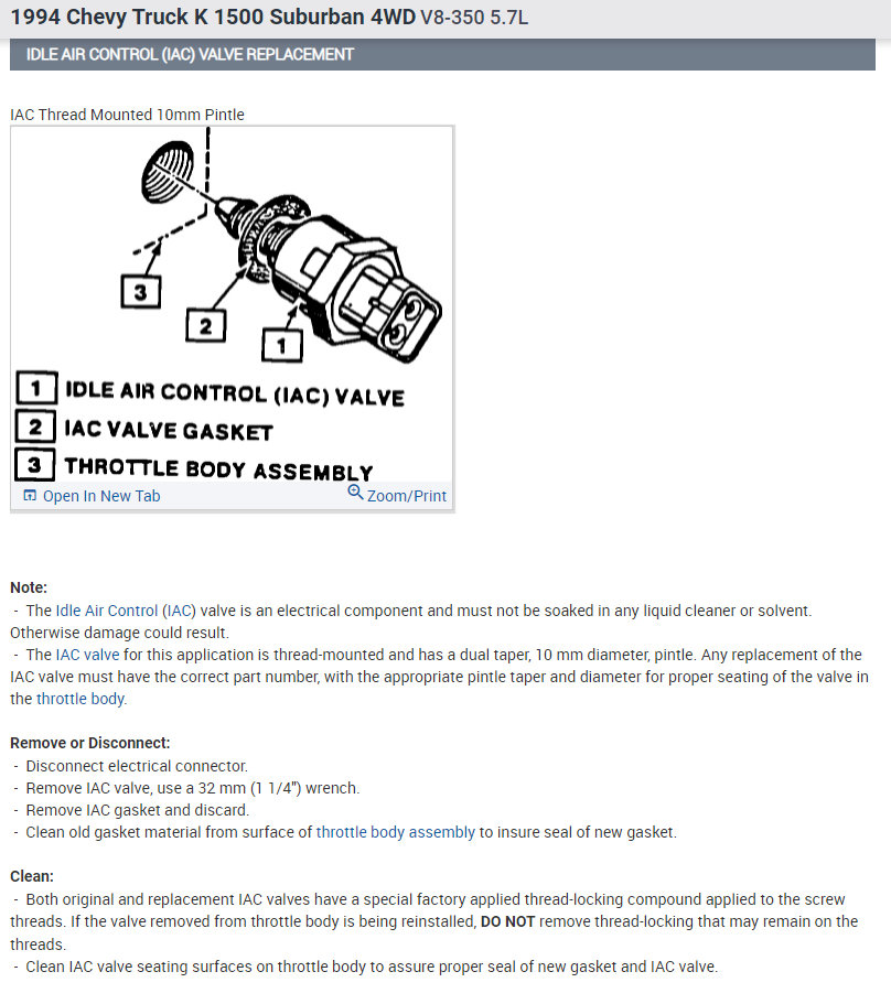

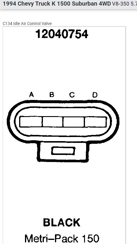

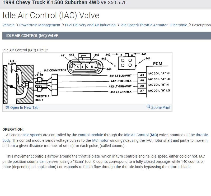

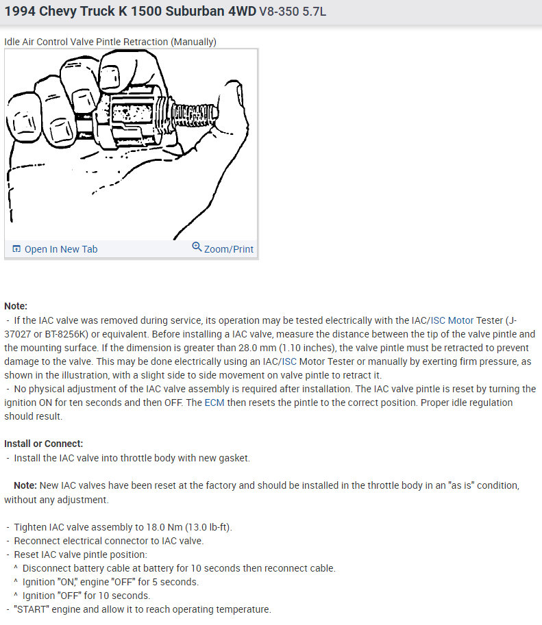

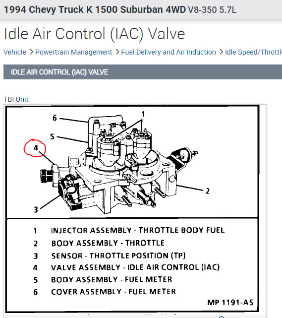

You could have a faulty idle air control valve. Over time the IAC valve can get dirty and get clogged, which can impact your idling.
You might be able to clean it out and improve the idle quality. The IAC is located on the side of the throttle body (see diagram below).
It will also be a good idea to clean out the throttle body while you are at it (if it appears dirty).
https://www.2carpros.com/articles/how-a-idle-air-control-valve-works
https://www.2carpros.com/articles/idle-air-control-valve-service

Thanks for the ideas! The idle is pretty smooth and doesn’t seem low enough to notice by ear. I don’t have a tachometer to see if it falls within specs but seems okay. I will look into the IAC as it seems pretty quick cheap and easy.
