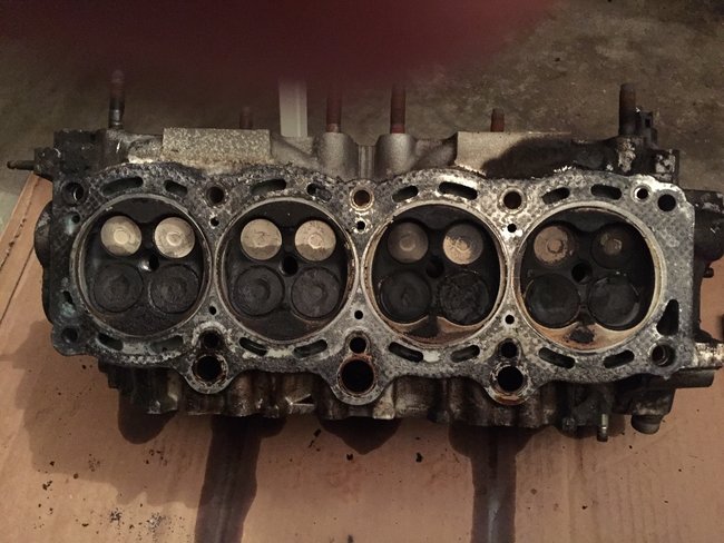

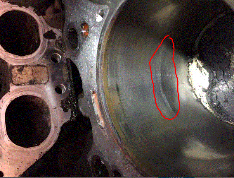

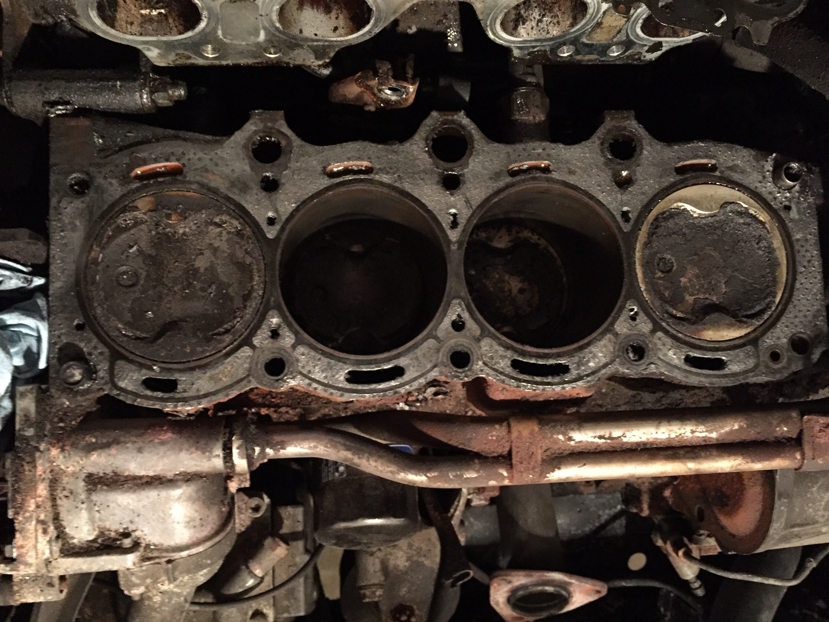

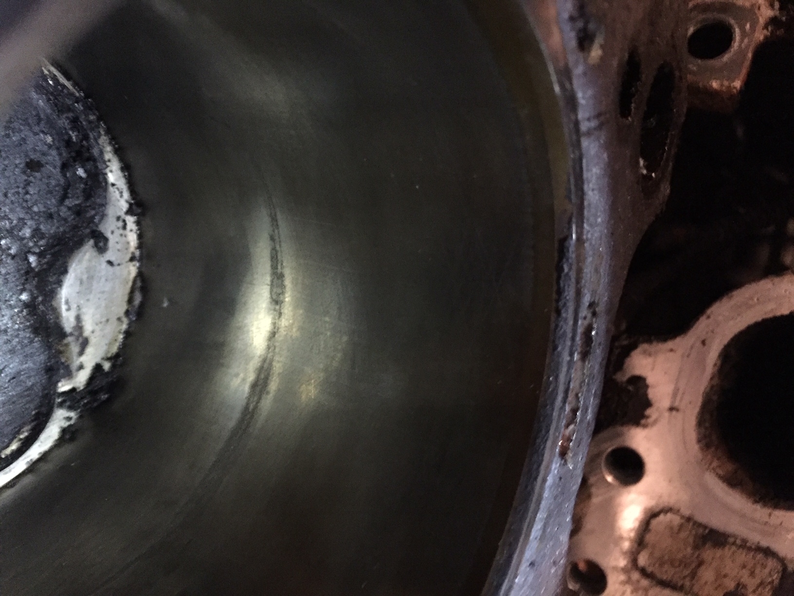

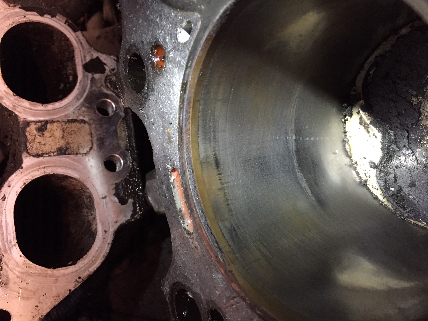

Symptoms: Has to crank a few seconds longer than usual to start, low end power poor. Highway cruising fine. Checked compression: 192, 187, 70, 55. No oil in coolant and no coolant in oil. Assumed classic head gasket breach between cylinders 3 and 4. Pulled the head. Despite the high mileage, the gasket looked perfectly fine. Other observations: lots of carbon on and around exhaust valves and piston heads. Valve train extremely clean. Cylinder walls look to be in good shape, still faint cross-hatching visible. Not sure what to make of this.
Feb 22, 2020 at 2:41 PM
  • 110,194 POSTS
That is really low. If there is no indication of a gasket issue, confirm nothing is warped as far as the cylinder head and block. If they are true, then you need to make sure the carbon build up isn't allowing the valves to stick slightly open.
When you did the compression test and found the low compression, did you also perform a wet compression test to see if there was any change?
Based on what you have already done, I assume you checked for damage such as a crack in the head or block. If that isn't the case, you may need to have it tested.
If possible, upload a couple pics of what you are seeing so I have a better idea. Because of the mileage, a wet compression test would have check if it was related to the compression rings. Let me know if you did that. Also, let me know if there was any noise from the engine before you did the work.

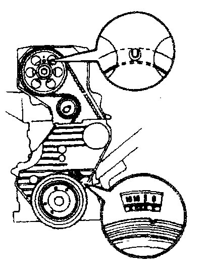

One last thing. By chance did you confirm there wasn't a timing issue? I attached a pic below of the timing marks. I don't know if you check it prior to disassembly.
Feb 22, 2020 at 5:07 PM
GREGGF
  • 5 POSTS
Hi Joe,
Thanks so much for your reply. Unfortunately, I didn't do the wet test. I figured what are the odds two adjacent cylinders would have low compression? I regret not doing it. Aside from rough idle, no unusual sounds during operation. I haven't had a chance to clean up the head to look for any visible cracks, will do tomorrow. Also, didn't see anything in the visible cylinders. The timing was spot-on when I set the cam/crank position before pulling the head. Attached images of the head and block - not great because of poor lighting. Low compression cylinders are the right two.
Thanks again,
Gregg
Feb 22, 2020 at 6:20 PM
  • 110,194 POSTS
Interesting how clean the outside of the last piston is. Did you clean anything off it? By the way, I totally understand why you thought gasket. It would make perfect sense. Like you, I see nothing obvious. Once you get it cleaned up, I would confirm there isn't carbon holding a valve slightly open, check for cracks and get a good straight edge and check if it appears warped.
Let me know what you find.
Feb 22, 2020 at 6:36 PM
GREGGF
  • 5 POSTS
Thanks again Joe! Okay, I took a fresh look this morning at the block and head and think I may have found a hairline crack in the number three cylinder. It's very hard to photograph but I attached two images. The walls are very uniform in finish except around the one horizontal portion shown. Is this what a crack might look like? I wish I could get in there with magnification.
Gregg
Feb 23, 2020 at 5:24 AM
  • 110,194 POSTS
That is a tough one. Can you feel the imperfection? Looking at the pictures, it does look like a crack, but it is difficult to tell. Is it only in the one cylinder? If it is, that wouldn't justify why two cylinders are low. I hope I'm looking at the right spot. I copied one of your pics and circled what I am looking at in the pic. Let me know if I am correct.
Feb 23, 2020 at 7:37 PM
GREGGF
  • 5 POSTS
Hi Joe,
Yes, what you circled is exactly what I was referring to. The center portion of the "line" can be felt/catch a fingernail. I rotated the crank and sure enough #4 has the same thing in almost exactly the same place - about midway up the back of the cylinder insert. Neither cylinder 1 or 2 have this.
Gregg
Feb 24, 2020 at 4:07 PM
  • 110,194 POSTS
Ugh, that isn't good news. I suspect you are correct. It's interesting that two of them did the same thing nearly at the same place.
I don't know if you plan to replace the engine, but here are the directions if you want them. Be prepared, they are extensive.

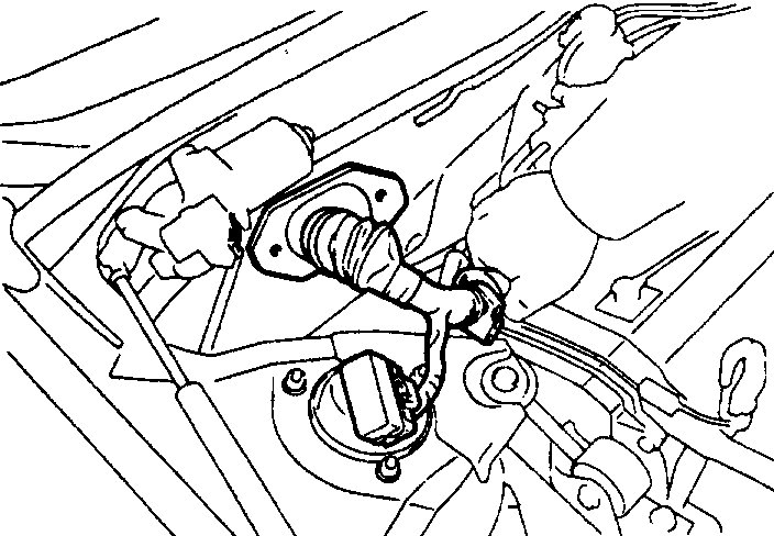

1. DISCONNECT NEGATIVE (-) TERMINAL CABLE FROM BATTERY
CAUTION: Work must be started after 90 seconds from the time the ignition switch is turned to the LOCK position and the negative (-) terminal cable 1s disconnected from the battery.

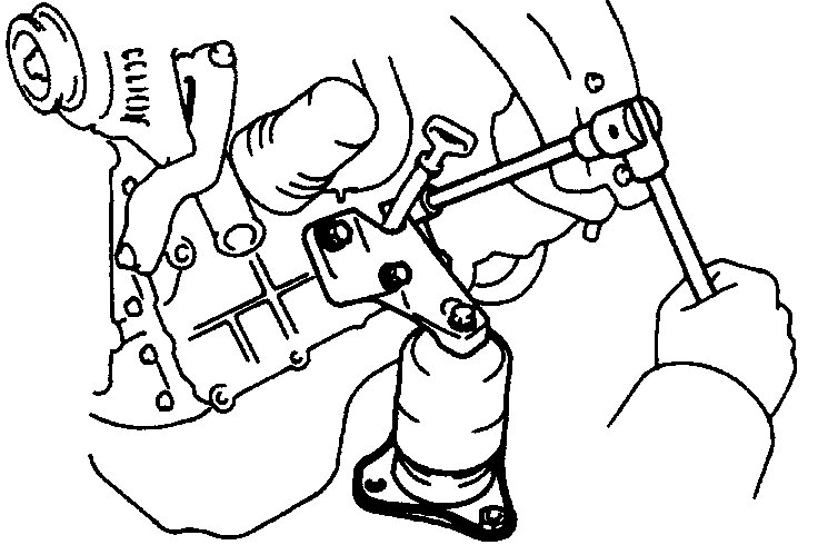

7. DISCONNECT ACCELERATOR CABLE FROM THROTTLE BODY
8. A/T: DISCONNECT THROTTLE CABLE FROM THROTTLE BODY

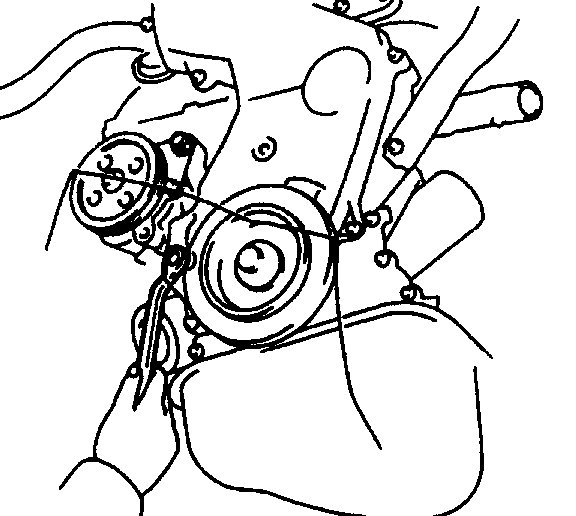

9. REMOVE AIR CLEANER ASSEMBLY, RESONATOR AND AIR CLEANER HOSE
(a) Disconnect the intake air temperature sensor connector.
(b) California only: Disconnect the air hose from the air cleaner hose.
(c) Loosen the air cleaner hose clamp bolt.
(d) Disconnect the 4 air cleaner cap clips.
(e) Disconnect the air cleaner hose from the throttle body. and remove the air cleaner cap together with the resonator and air cleaner hose.
(f) Remove the element.
(g) Remove the 3 bolts and air cleaner case.

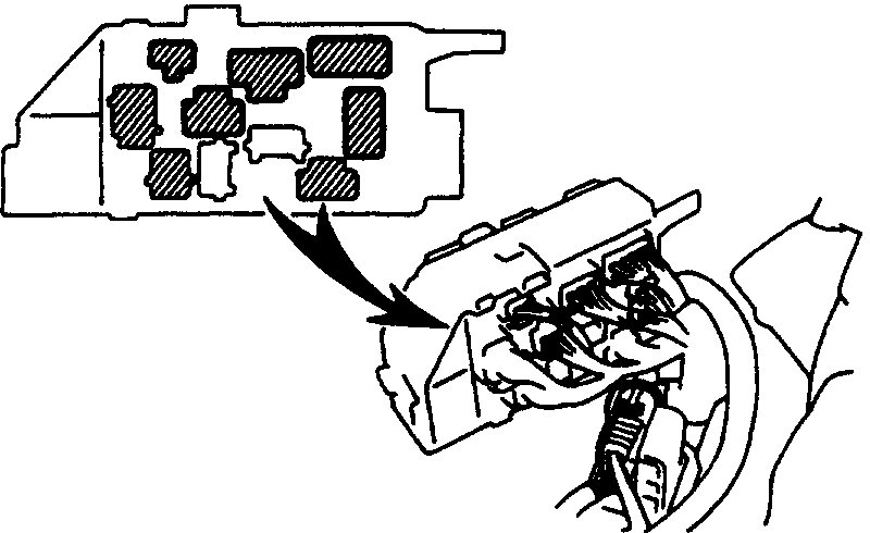

12. DISCONNECT WIRES AND CONNECTORS
pic 6
(a) Remove the engine relay box. and disconnect the 5 connectors.
(b) Connector from LH fender apron
(c) Disconnect the following connectors:

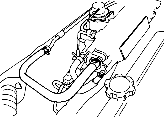

13. DISCONNECT HEATER HOSES

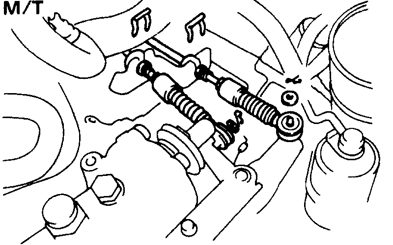

17. M/T: REMOVE CLUTCH RELEASE CYLINDER WITHOUT DISCONNECTING TUBE
- Remove the 4 bolts, release cylinder and tube from the transaxle.

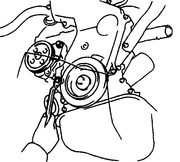

21. w/ A/C: REMOVE A/C COMPRESSOR WITHOUT DISCONNECTING HOSES
(a) Disconnect the A/C compressor connector.
(b) Remove the drive belt.
(c) Remove the 3 bolts, and disconnect the A/C compressor.
HINT: Put aside the compressor, and suspend it from the radiator support.
pic 18

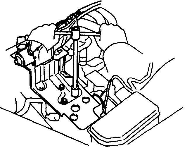

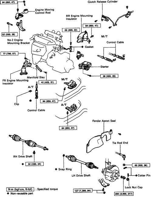

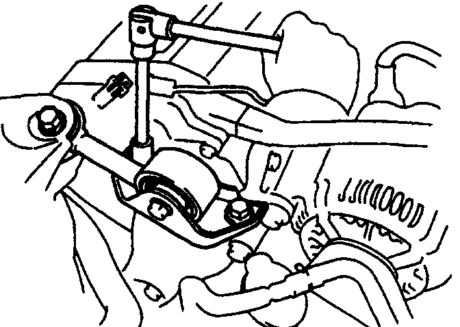

25. DISCONNECT LH ENGINE MOUNTING INSULATOR
pic 20
M/T: Remove the 3 bolts, and disconnect the mounting insulator.
pic 21
A/T: Remove the 4 bolts, and disconnect the mounting insulator.
pic 22

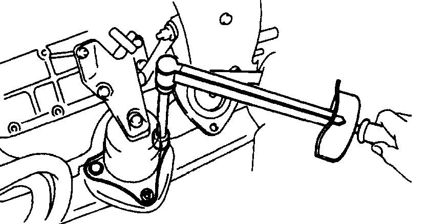

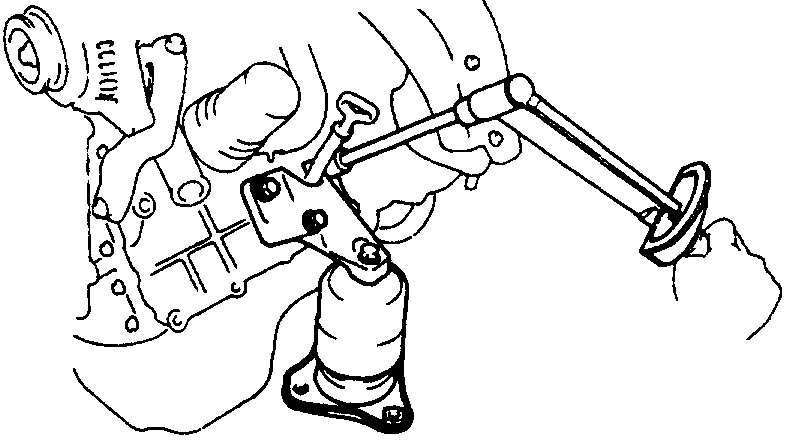

26. DISCONNECT RR ENGINE MOUNTING INSULATOR
(a) Remove the hole plugs.
(b) Remove the 3 nuts, and disconnect the mounting insulator.
pic 23

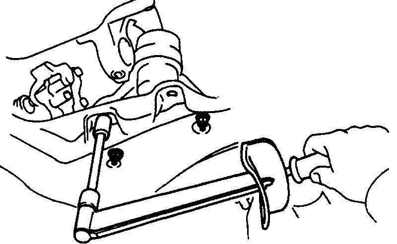

27. DISCONNECT FR ENGINE MOUNTING INSULATOR
- Remove the 3 bolts, and disconnect the mounting insulator.
pic 24

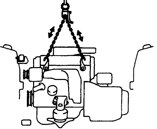

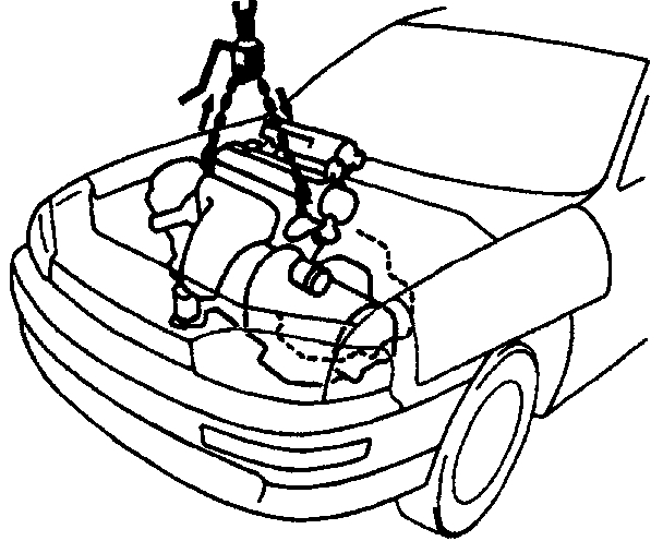

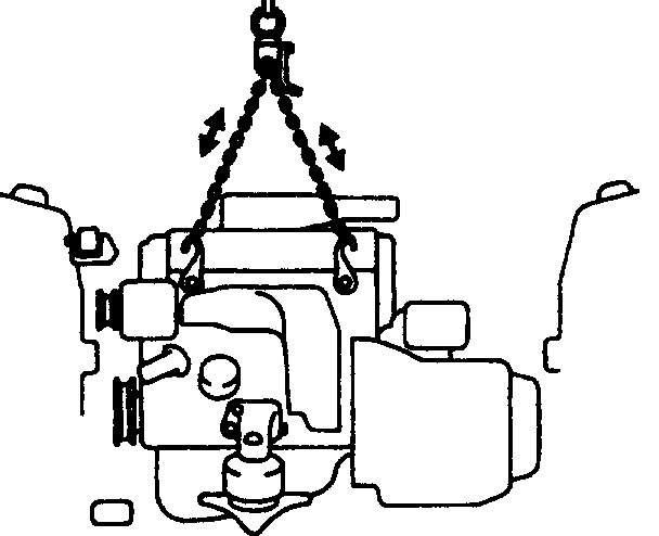

28. ATTACH ENGINE SLING DEVICE TO ENGINE HANGERS
pic 25

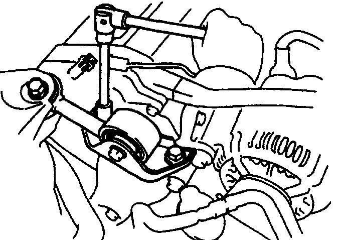

29. REMOVE ENGINE MOVING CONTROL ROD
- Remove the 3 bolts and control rod.
pic 26

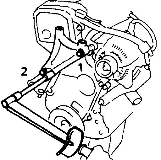

30. REMOVE ENGINE AND TRANSAXLE ASSEMBLY FROM VEHICLE
(a) Lift the engine out of the vehicle slowly and carefully.
NOTICE: Be careful not to hit the PS gear housing or park/neutral position switch (A/T).
(b) Make sure the engine is clear of all wiring, hoses and cables.
(c) Place the engine and transaxle assembly onto the stand.
31. A/T: REMOVE STARTER
32. SEPARATE ENGINE AND TRANSAXLE
pic 27
33. REMOVE NO.2 RH ENGINE MOUNTING BRACKET
- Remove the 3 bolts and engine mounting bracket.
pic 28
34. REMOVE FR ENGINE MOUNTING INSULATOR
(a) Remove the bolt, nut and manifold stay.
(b) Remove the 4 bolts and mounting insulator.
pic 29
35. REMOVE RR ENGINE MOUNTING INSULATOR
- Remove the 4 bolts and mounting insulator.

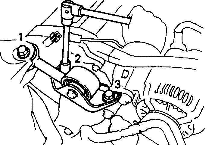

(a) Temporarily install the engine moving control rod with the 3 bolts in the sequence shown.
(b) Tighten the 3 bolts in the sequence shown.
Torque: 64 N.m (650 kgf.cm, 47 ft.lbf)

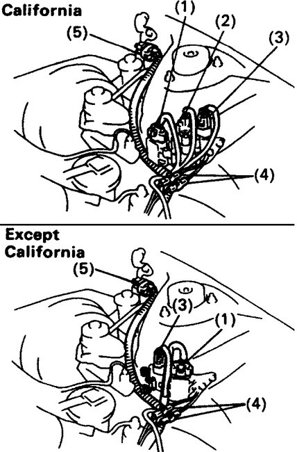

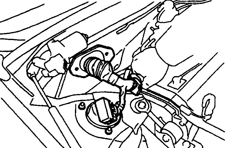

(c) Install the engine relay box.
(d) Connect the following connectors:

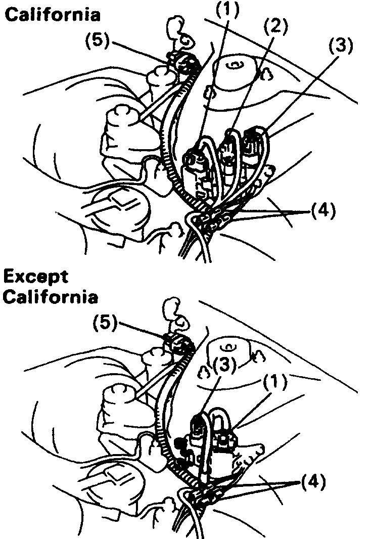

pic 53
(1) Igniter connector
(2) California only: Ignition coil connector
(3) Noise filter connector
(4) 2 ground straps from LH fender apron
(5) Connector from LH fender apron
pic 54

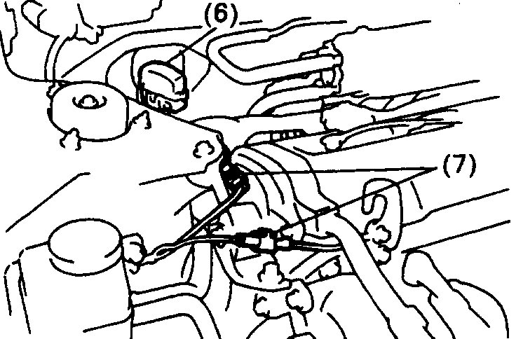

(6) Data link connector 1
(7) 2 ground straps from RH fender apron
(e) Connect the MAP sensor connector.

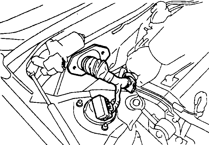

25. INSTALL RADIATOR
pic 55
26. w/ CRUISE CONTROL SYSTEM: INSTALL CRUISE CONTROL ACTUATOR
(a) Install the actuator and bracket with the 3 bolts.
(b) Connect the actuator connector.
(c) Install the actuator cover.
pic 56

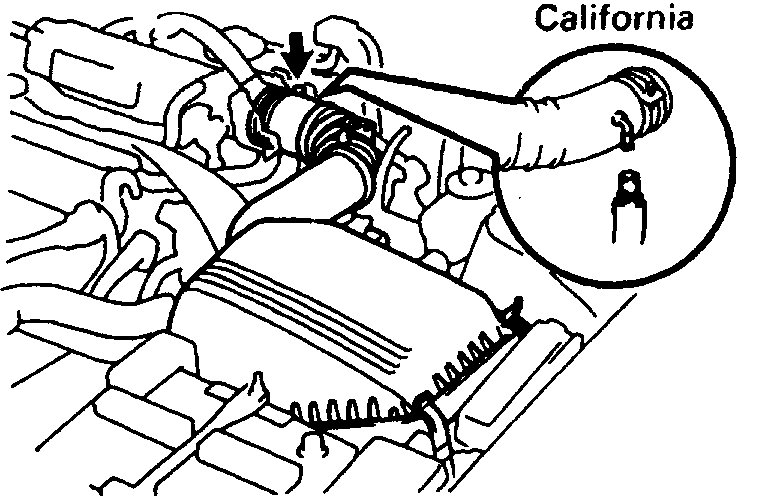

27. INSTALL AIR CLEANER ASSEMBLY, RESONATOR AND AIR CLEANER HOSE
(a) Install the air cleaner case with 3 bolts.
(b) Install the element.
(c) Connect the air cleaner hose to the throttle body.
(d) Install the air cleaner cap together with the resonator and air cleaner hose.
(e) California only: Connect the air hose to the air cleaner hose.
(f) Connect the intake air temperature sensor connector.

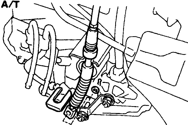

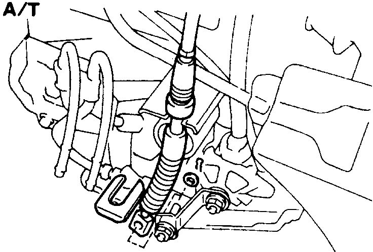

28. A/T: CONNECT AND ADJUST THROTTLE CABLE

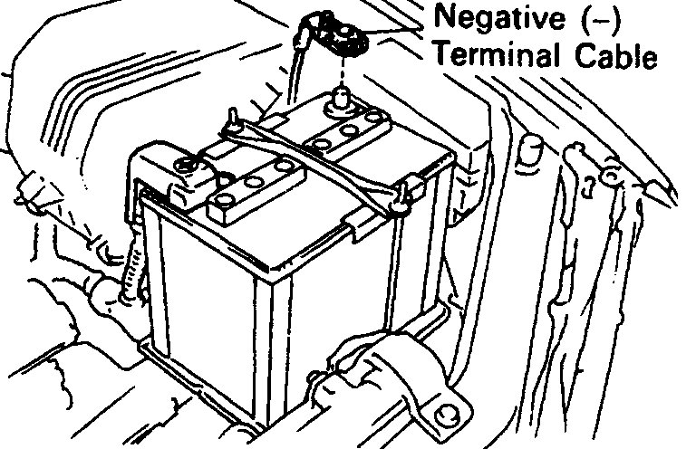

32. CONNECT NEGATIVE (-) TERMINAL CABLE TO BATTERY
