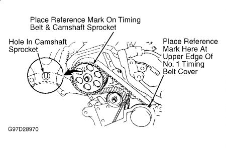

Does low compression in each cylinder mean timing belt problem?

That's a possibllity does engine run? What are comp. readings? Think there is an view port in T cover put crank at TDC then see cam mark. see diagram
https://images.2carpros.com/forum/automotive_pictures/198357_Grafic_3_49.jpg
