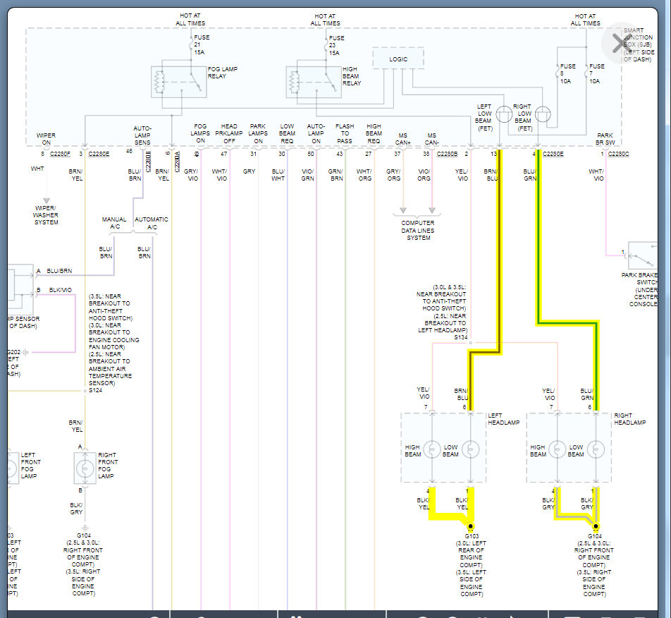

Low beam headlight are dim
2012 FORD FUSION
110,000 MILES • 2.4L • 4 CYL • 2WD • AUTOMATIC
TALHA KAMRAN
I have the car listed above SE model.
Low beam lights are so dim that i did not cover 20 meters in front of car.
High beams are fine nothing wrong with them.
May 9, 2021 at 10:37 AM
Here is a guide that will help with this issue:
https://www.2carpros.com/articles/one-headlight-is-dim-or-dull

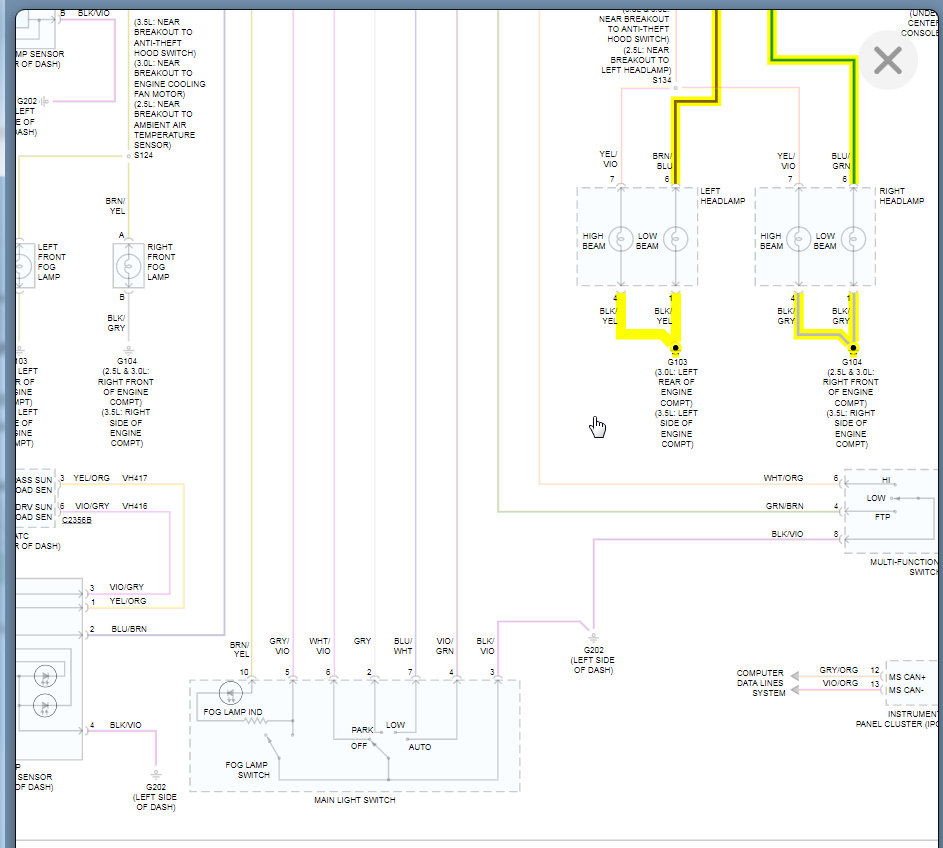

I would suggest checking the voltage on the highlighted wires just to find out if you have 12 volts going to the low beam bulbs.
Normally this is a ground issue but the high beams share the ground so it is unlikely. More likely is a the FET that is used in the Smart Junction block.
Please run through this material and let us know what questions you have. Thanks
