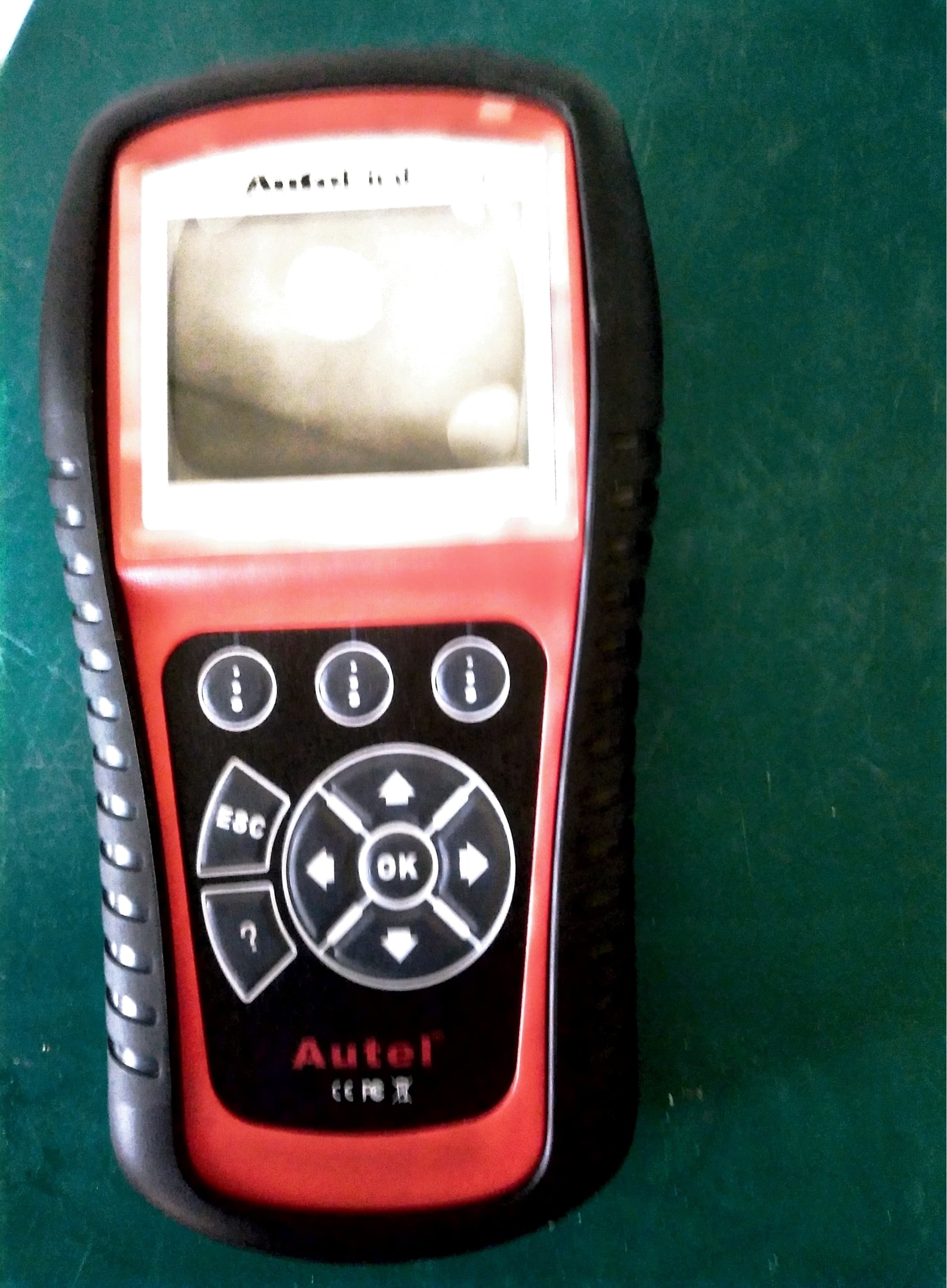

Good day, I just took delivery of the scanner now. Is there any prior I need to know before I start scanning? Can I also use it to detect if the key is working or not? Any special directives? Thanks
Jun 1, 2023 at 2:14 AM
MAMIRORO SMITH
  • 83 POSTS
Good morning, I plugged the device but it reads ' failed to connect' 'link error'. What should I do?
Jun 1, 2023 at 9:23 PM
MAMIRORO SMITH
  • 83 POSTS
The scanner reads ISO 1411 -2, KWP 2000, SAE. In the end, it showed 'failed to connect ' linking error. What does it mean, what should I do? Thanks
Jun 1, 2023 at 11:02 PM

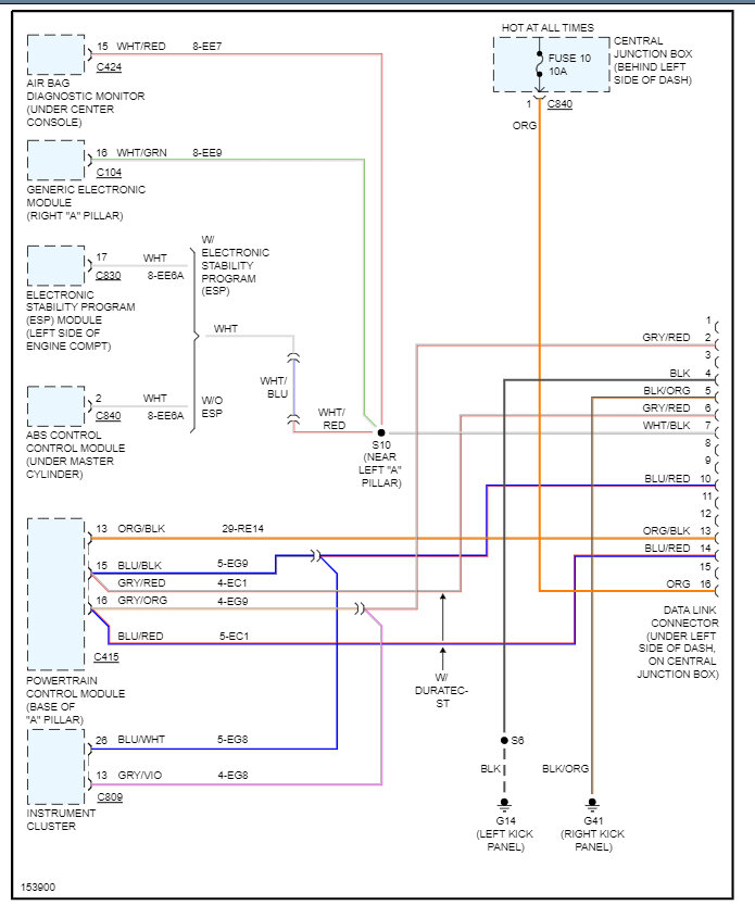

  • 55,256 POSTS
Try the scanner in a different car to confirm the scanner is working. Next check the fuse #10 in the fuse panel on the left side of the dash. Here is the wiring diagram for the data connector so you can see how it works. I would check the connector ground as well.
This guide can help:
Please go over this guide and get back to us.

MAMIRORO SMITH
  • 83 POSTS
Maybe because I have not registered the scanner. I am contacting the support team but there has been no positive response yet. I need to scan QR code before I register. I don't see I can scan QR code. I continue with the registration but i failed to submit.

  • 83 POSTS
The autel scanner was tried on another vehicle. It was communicating but it didn't read any codes. The menu displayed. What I have realized is, I might right or wrong but the most important thing right now is how to ensure that data link communicator DLC is communicating with the PCM. If that is not in place, I wonder how the previous mechanic was able to program the key he claimed he had programmed. From the software manual I have, it states that ' the ISO 9141 communication network will not function if the wire is shorted to the ground or battery voltage. Also, if one of the modules on the ISO 9141 communications network loses power or shorts internally, communication to that module will fail. I am suspicious of the starter relay K22 C1017 in the CJB. How do I test relays. Do you think it is internal short that has made the DLC not to communicate. If the DLC is communicating, then the key can be programmed and the car get running. You can review this and state your opinion. I am glad you help. Thanks
