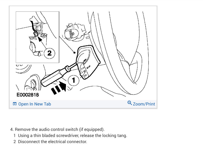

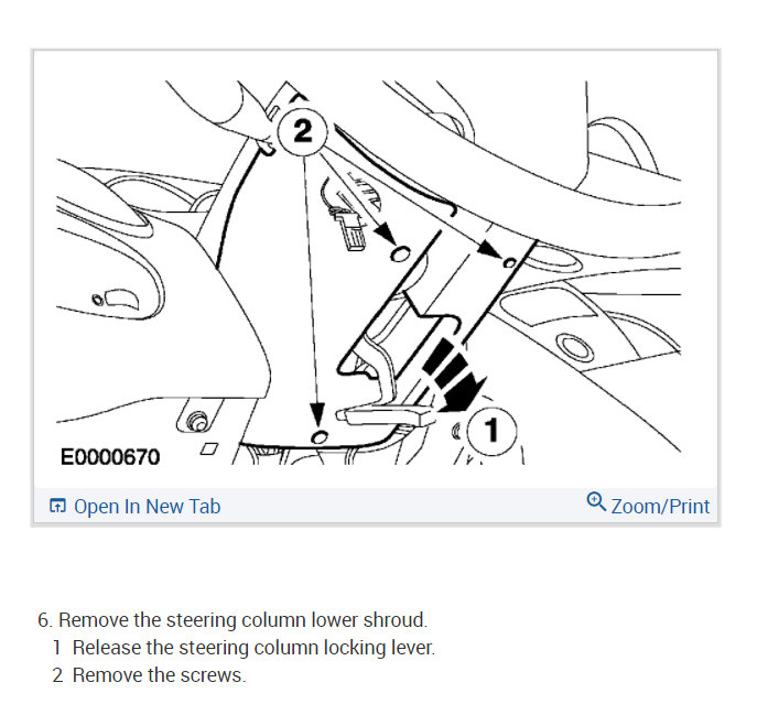

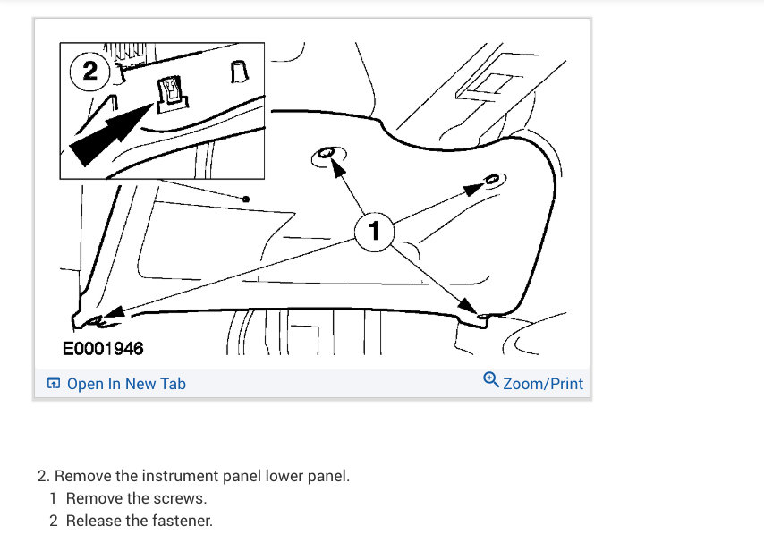

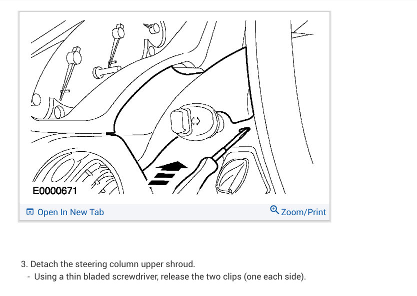

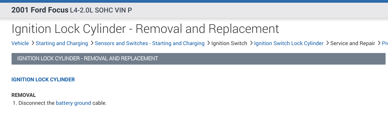

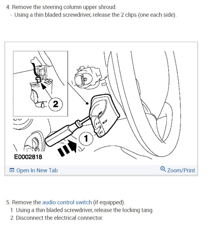

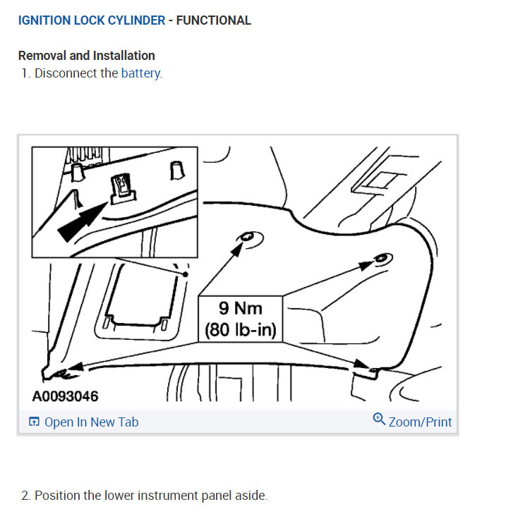

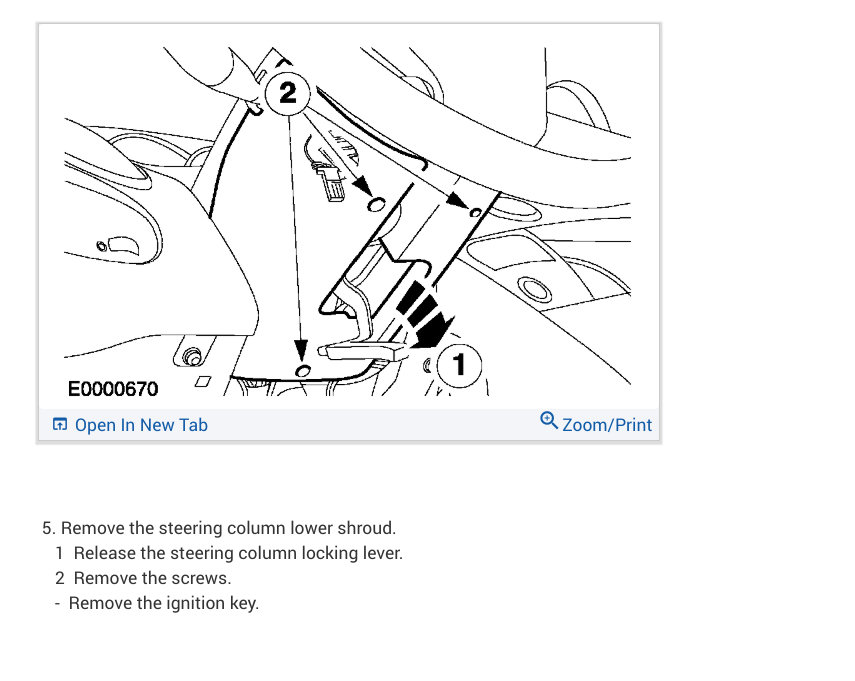

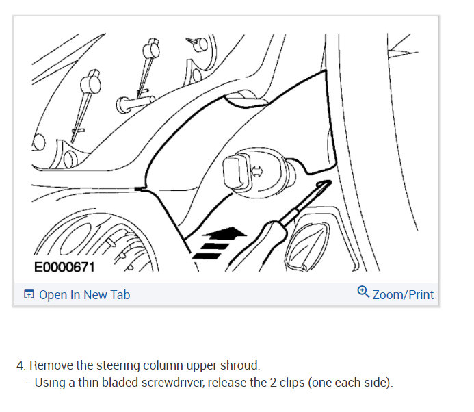

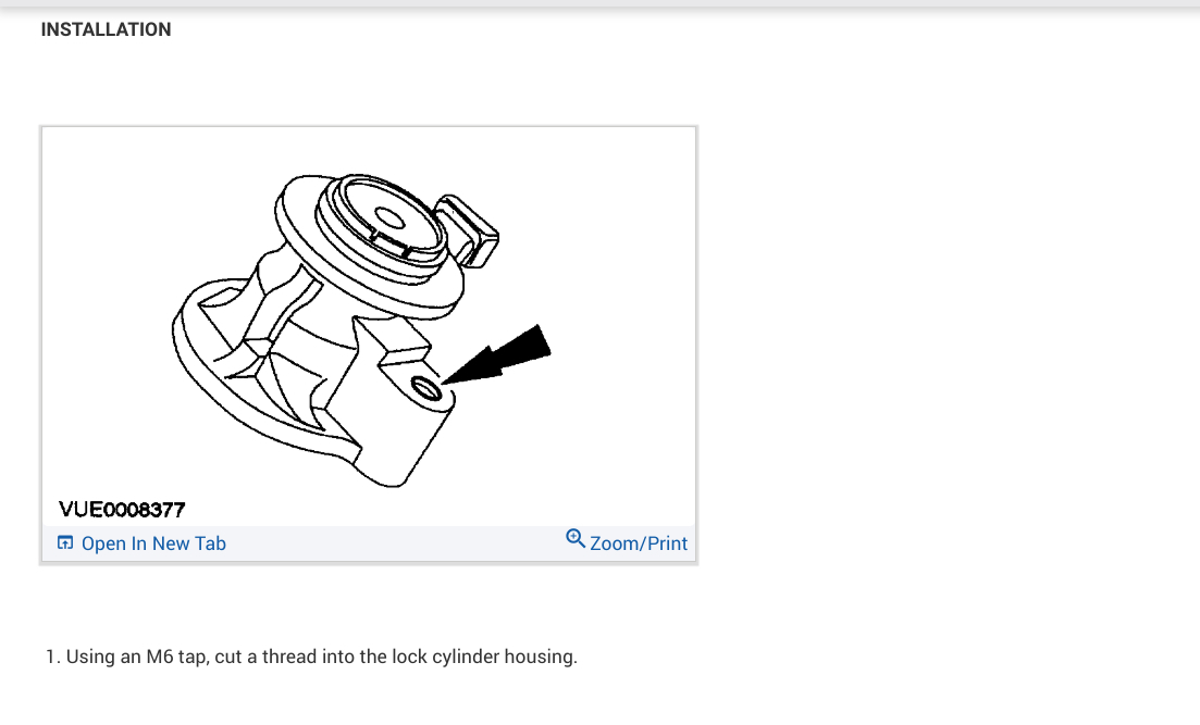

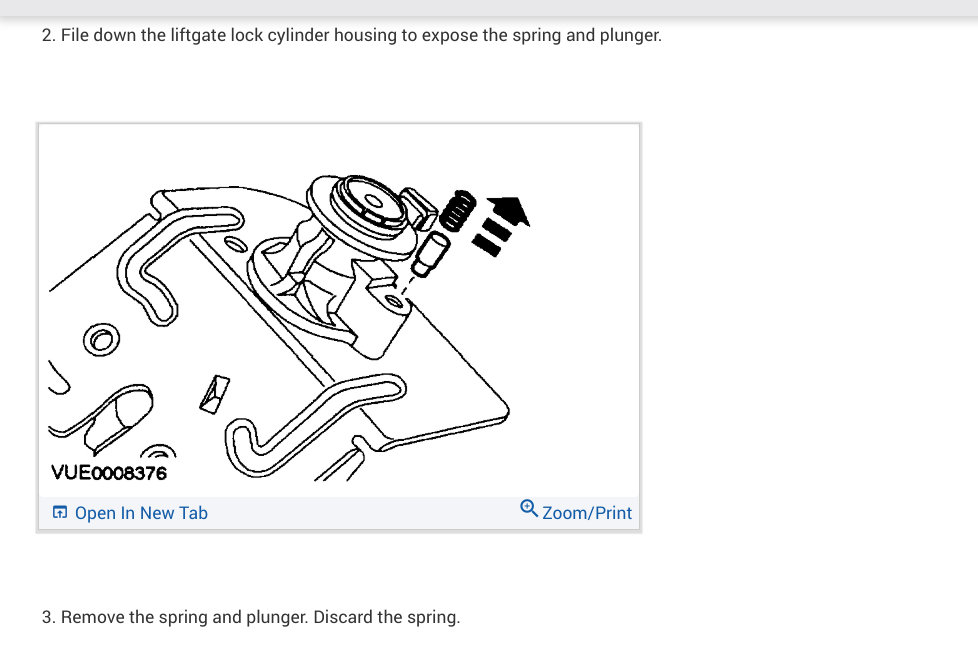

SCGRANTURISMO
  • 4,897 POSTS
I have included the information that you requested in the diagrams down below. Please go through this guide and get back to us with how everything turns out. I hope that this helps you out.
Thanks,
Alex
2CarPros
Dec 15, 2020 at 8:14 AM (Merged)

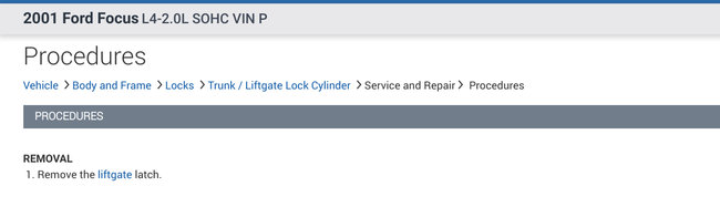

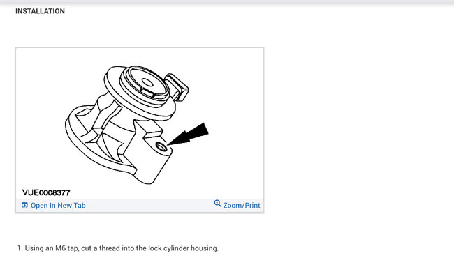

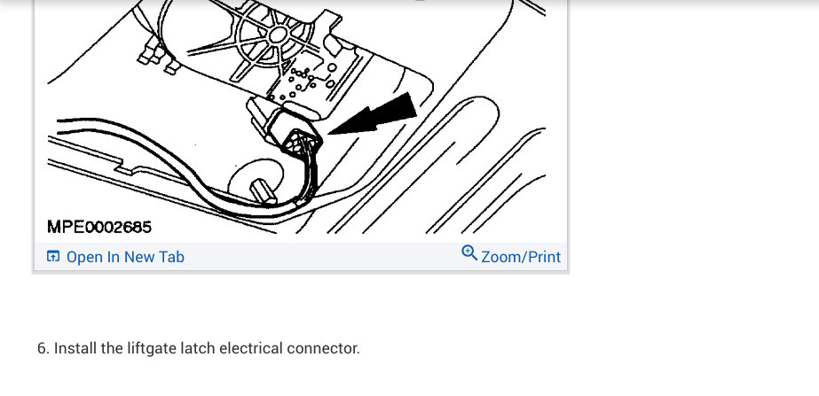

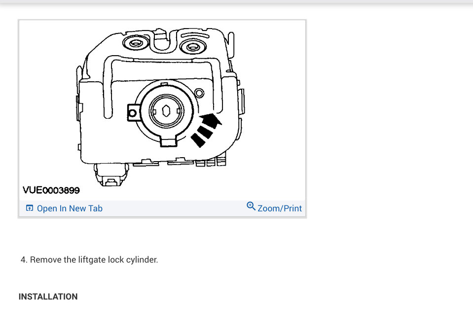

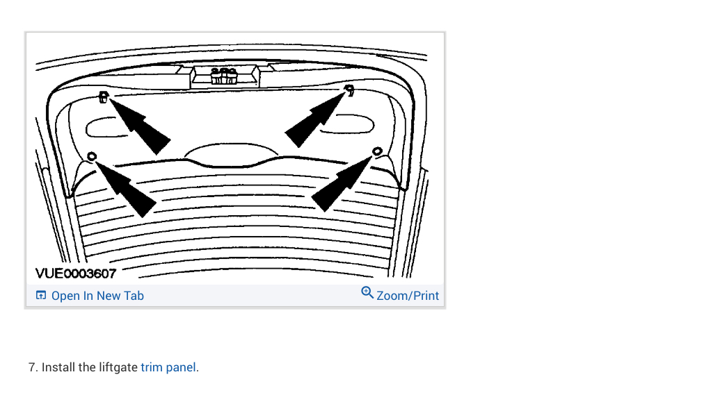

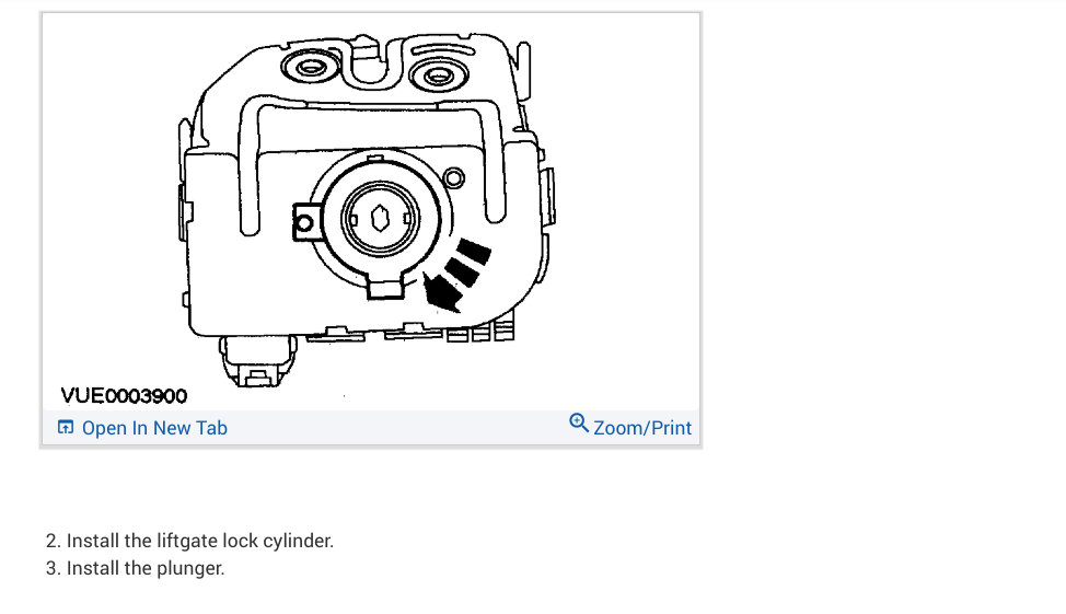

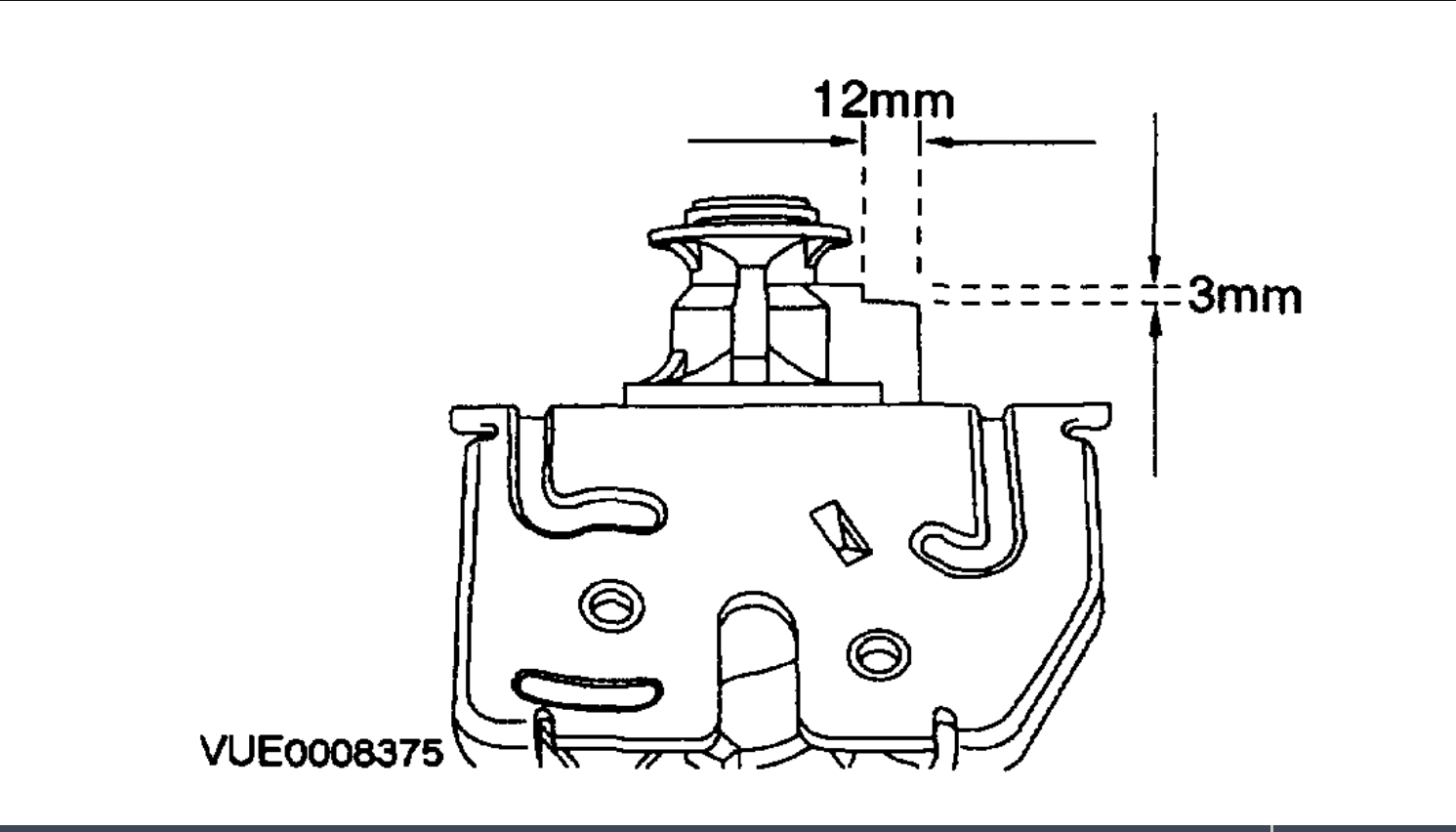

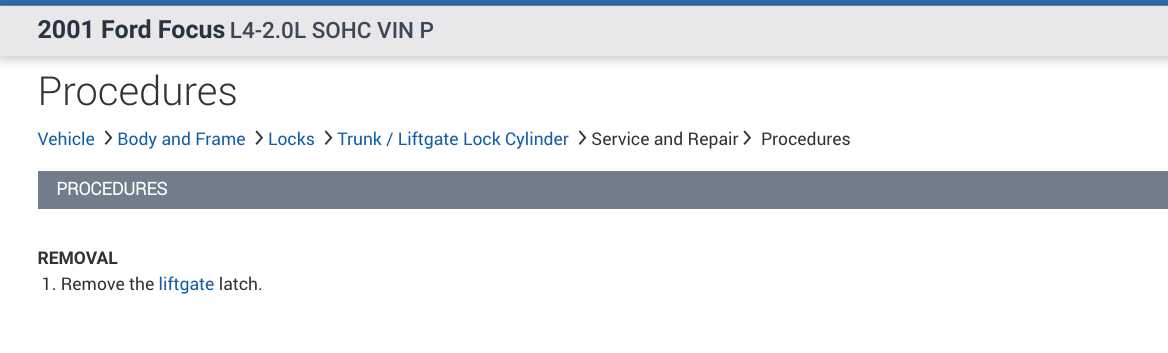

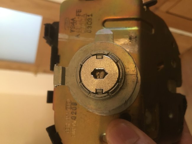

HARRYDESOUZA
I think the wording of the problem may have misconstrued the problem. So I have decided to attach an image of the lock cylinder that I would like to disengage from the assembly.
SCGRANTURISMO
  • 4,897 POSTS
Hello again,
I'm sorry. Is this the trunk lock cylinder that you are replacing?
Thanks,
Alex
2CarPros
HARRYDESOUZA
Yes. I would like to replace the lock cylinder with mine which has a key.

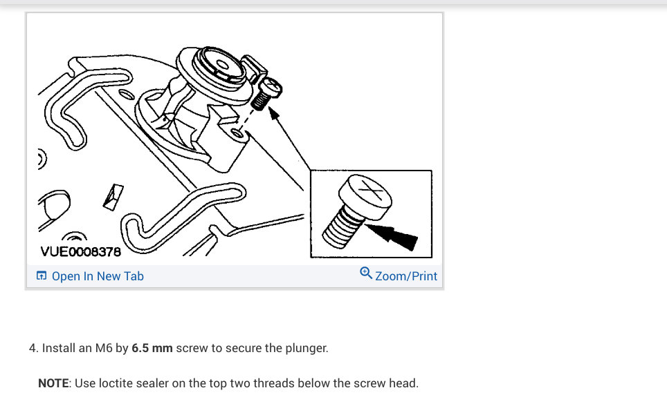

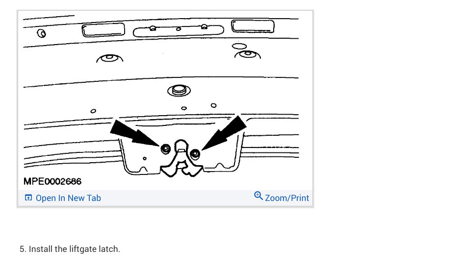

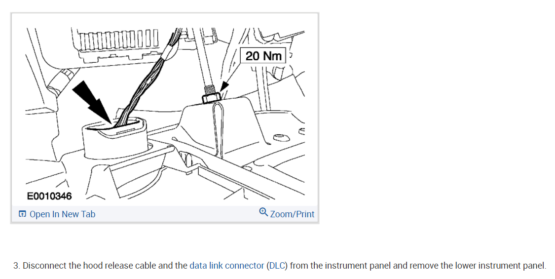

SCGRANTURISMO
  • 4,897 POSTS
Hello again,
Okay, sorry about that. In the diagrams down below I have included the instructions from the vehicle manufacturer on the removal and installation of the trunk's lock cylinder on your vehicle. Please go through this guide and get back to us with how everything turns out. I hope that this helps.
Thanks,
Alex
2carPros

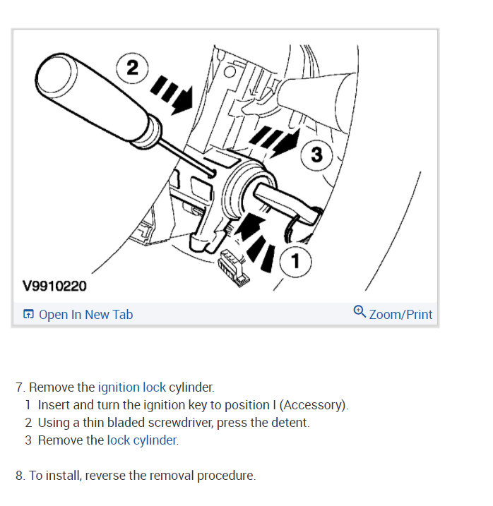

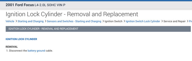

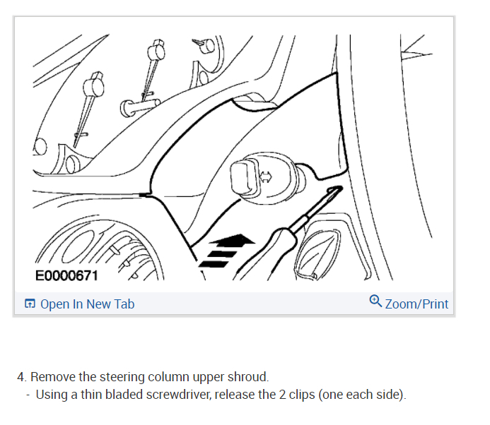

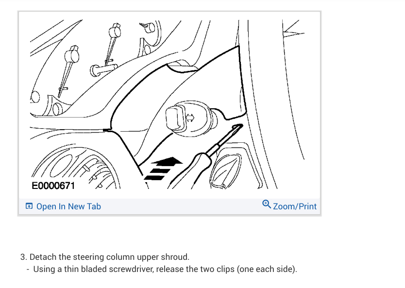

ROGERSBUICK
i need to know how to remove/replace ignition lock cylinder
Dec 15, 2020 at 8:24 AM (Merged)

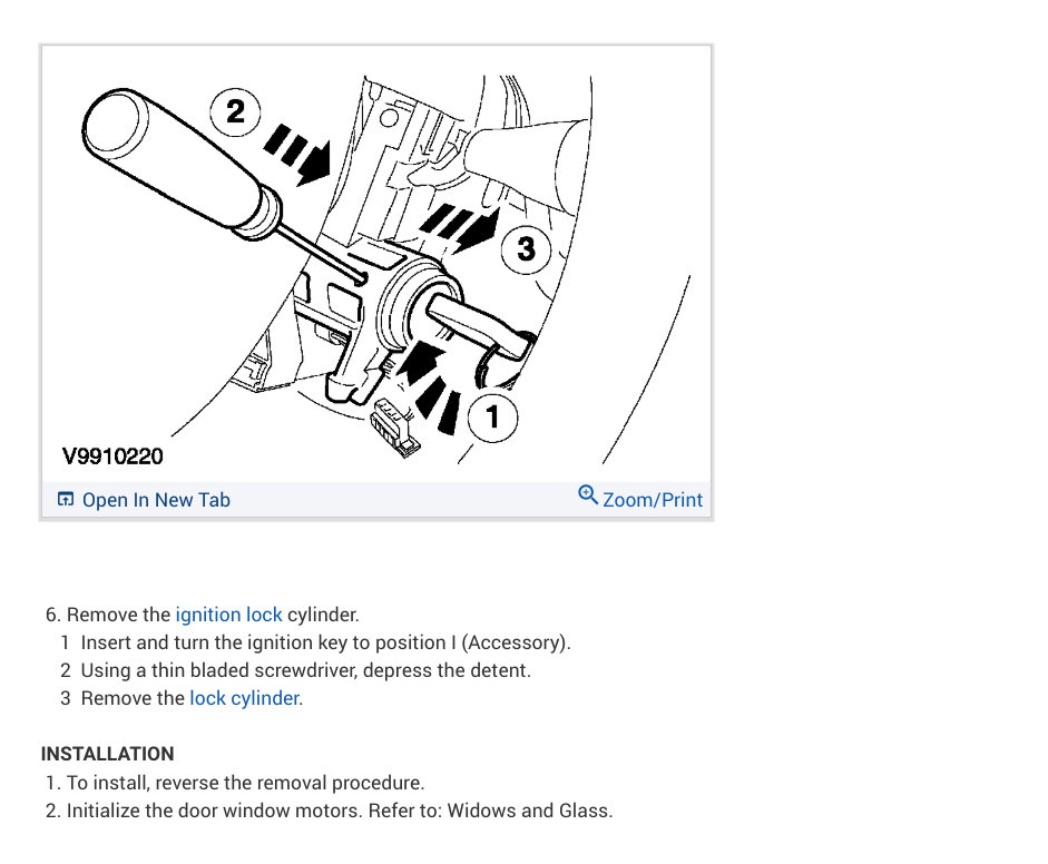

MERLIN2021
  • 17,250 POSTS
IGNITION SWITCH Removal & Installation Disconnect negative battery cable. Remove lower steering column cover. Using a thin-blade screwdriver, release 2 clips from steering column upper shroud. Release steering column locking lever (if equipped), remove 3 screws and ignition key. Disconnect ignition switch electrical connectors. Remove ignition switch retaining clips. Remove ignition switch. To install, reverse removal procedure.
When you buy the cylinder Get it at Ford, have them set the tumblers to your key, this way you can avoid the expense of programming the new key.
