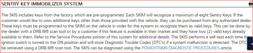

Bought the car my friend lost the key have a new key cylinder. how do I program it to the car or what else do I need to use that key cylinder?

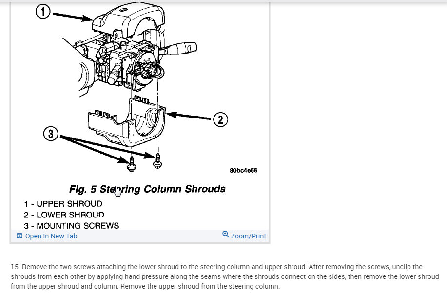

Here are the instruction on how to change out the ignition lock and key cylinder. you will need to get the parts from the dealer so they can programm the new unit to your car. please bring your VIN number. Check out the diagrams (below). Please let us know if you need anything else to get the problem fixed.

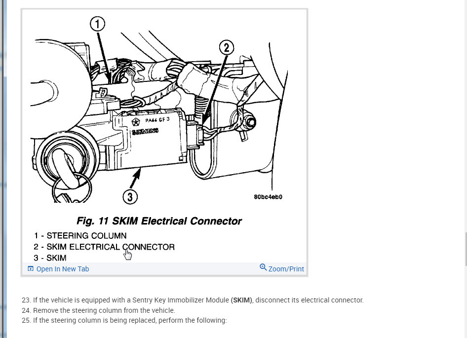

MARIAA

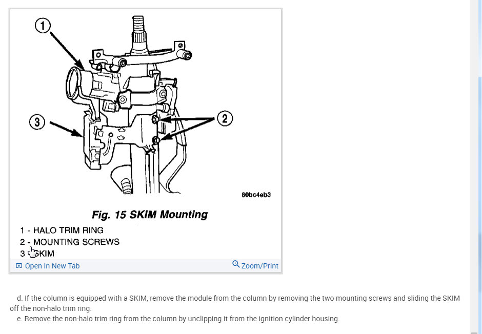

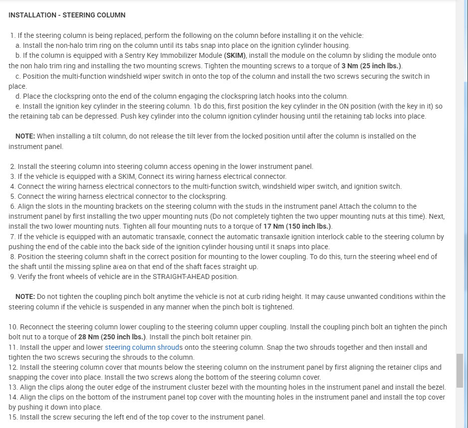

I had to replace the steering column and the key from the new steering column will not work. How do I program or so it will because I lost the key to the old steering column?
May 7, 2021 at 4:34 AM (Merged)
DANNY L
  • 5,648 POSTS
Hello, I am Danny.
I found this article relating to your vehicle if it is equipped with the Sentry Key Immobilizer System (SKIS) and have attached a picture. It was available as a factory installed option. Since you have changed the column and have a new key(s) it needs to be programmed with a DRBIII scan tool. Hope this helps and let me know if you have any further questions.
Danny-

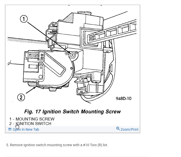

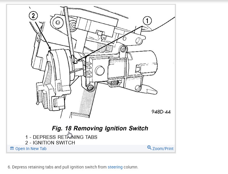

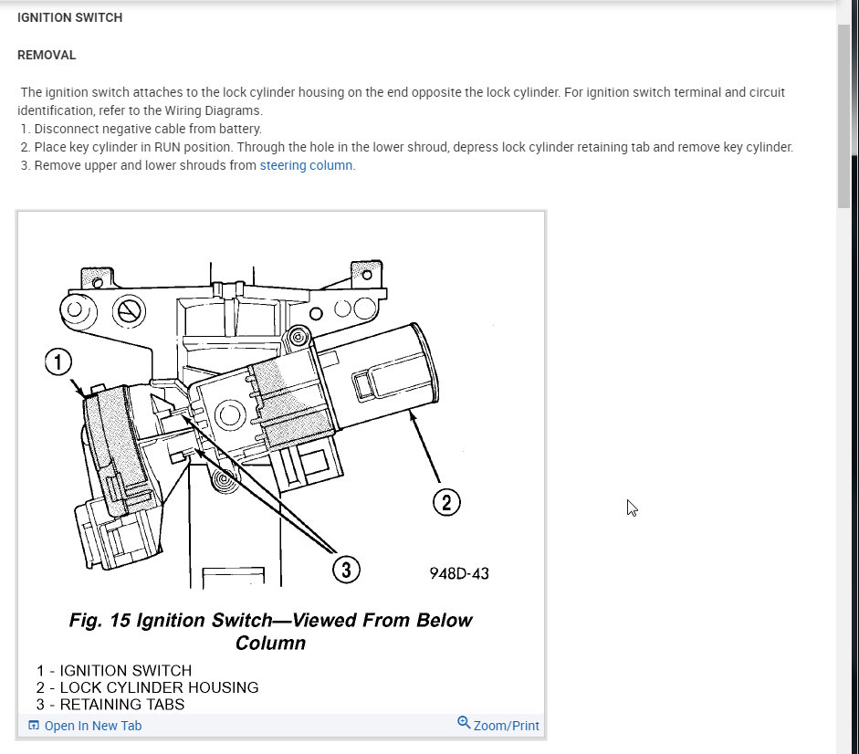

BOWEN ROGERS

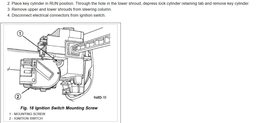

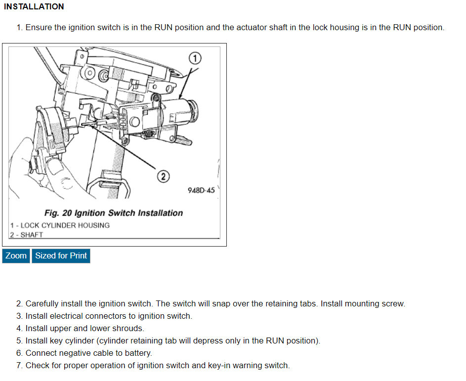

Car listed above is an SXT model.The first part of my ignition that controls the wheel is still on while my key is out and the rest of the car is off, and it’s preventing me from getting the key all the way in to turn the car on fully. I’ve tried shimming the wheel while turning the key, I’ve tried multiple keys, I’m not sure at this point how to reset the lock cylinder so that I can turn the car on and I haven’t been able to find any information to a case like this online.
May 7, 2021 at 4:36 AM (Merged)

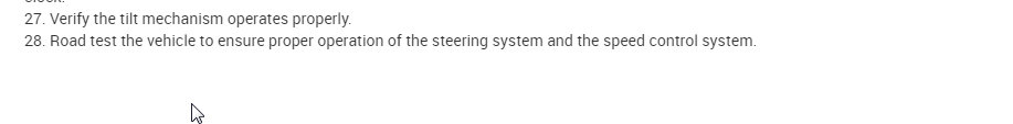

Just so I understand this, the ignition is not turning all the way in either direction but the key still comes out? If so, it sounds like this ignition switch has failed and needs replaced. If I understand this correctly, I attached the process of how to do this.
Let me know if I got this wrong. If so, maybe get a video of the issue so we can see what is happening. Thanks

I got the old one out and am trying to put the new one in, but the old one would not turn to the on position. so how do I heterogeneous it to go all the way in?
May 7, 2021 at 4:37 AM (Merged)
  • 55,224 POSTS
The switch must be timed correctly so it can be assembled. If you have troubles please take a video of the trouble so I can see whats going on, upload it to the site here.

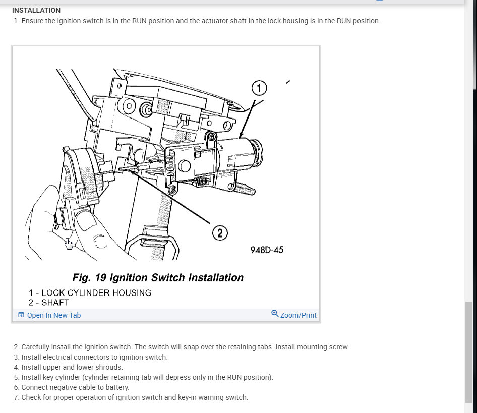

Here is the compete guide on how to change the switch out.

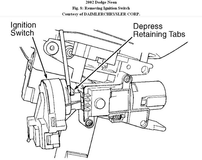

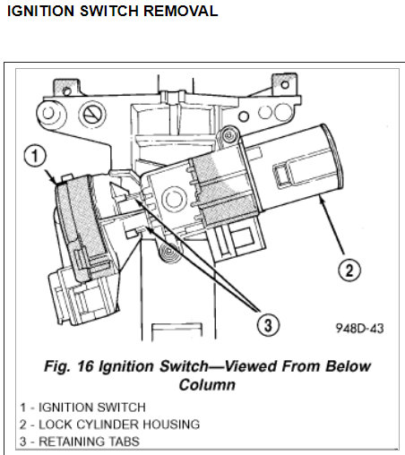

TLSMITH

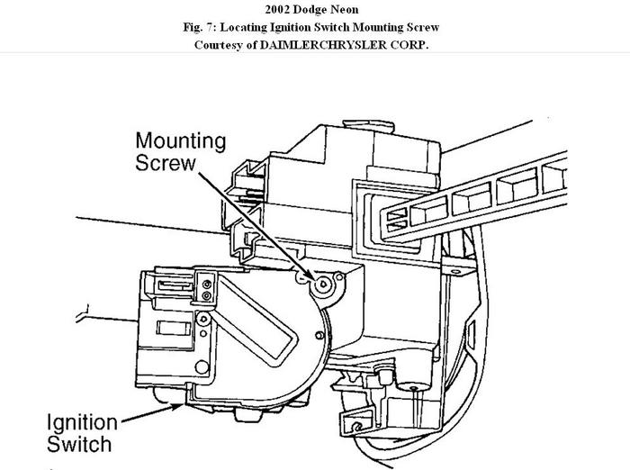

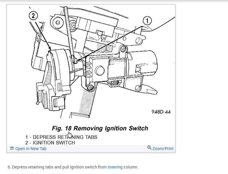

How do you replace an ignition switch on a 2002 dodge neon?
KHLOW2008
  • 41,814 POSTS

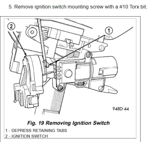

IGNITION SWITCH
Removal
1. Disconnect negative battery cable. Turn ignition switch in RUN position. Through hole in lower shroud, depress retaining tab and remove lock cylinder. See Fig. 6 .
2. Remove upper and lower column shrouds from column. Disconnect ignition switch harness connector. Using a Torx bit, remove ignition switch mounting screw. Depress retaining tabs and pull ignition switch from steering column. See Fig. 7 and Fig. 8 .
Installation
Ensure ignition switch and actuator shaft are in RUN position. Carefully install ignition switch. Switch will snap over the retaining tabs. To complete installation, reverse removal procedure.
© 2008 Mitchell Repair Information Co., LLC.

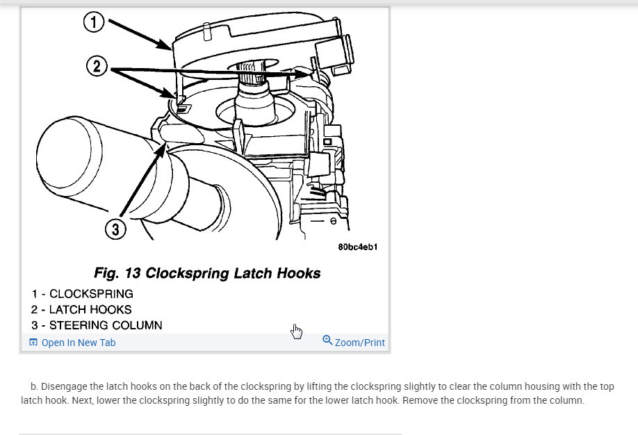

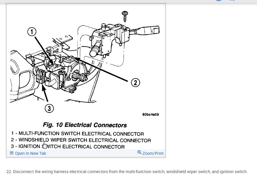

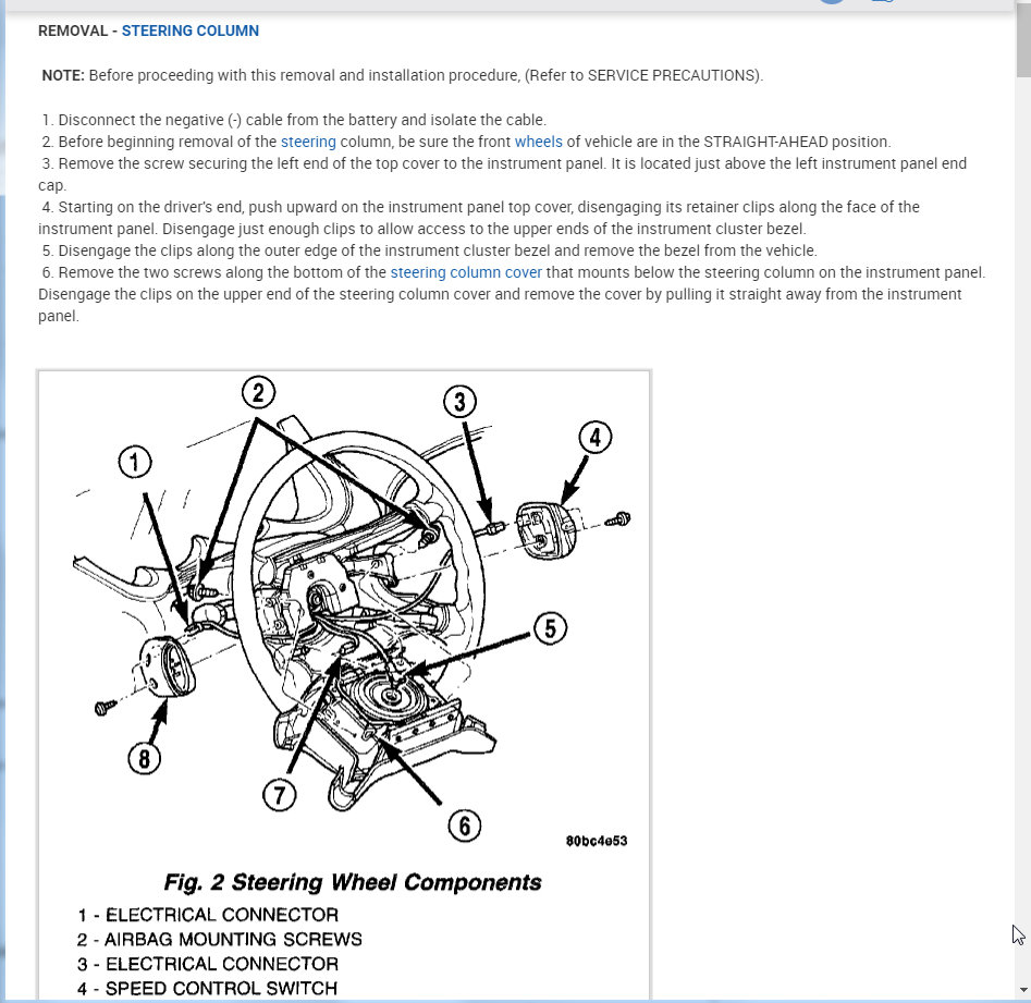

LAELLARKIN

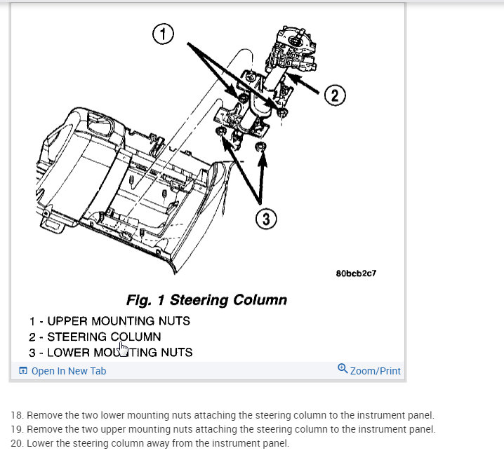

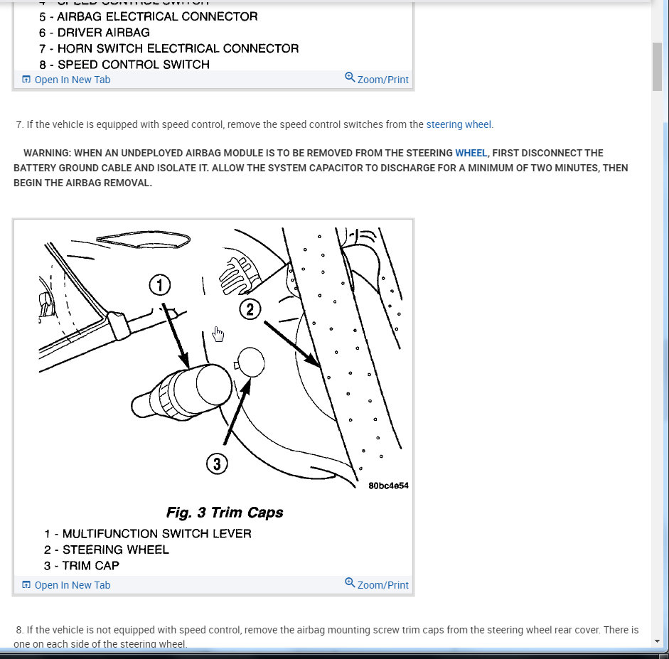

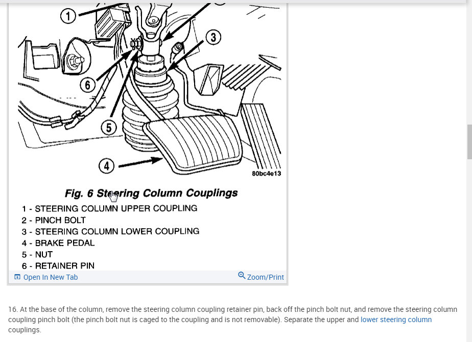

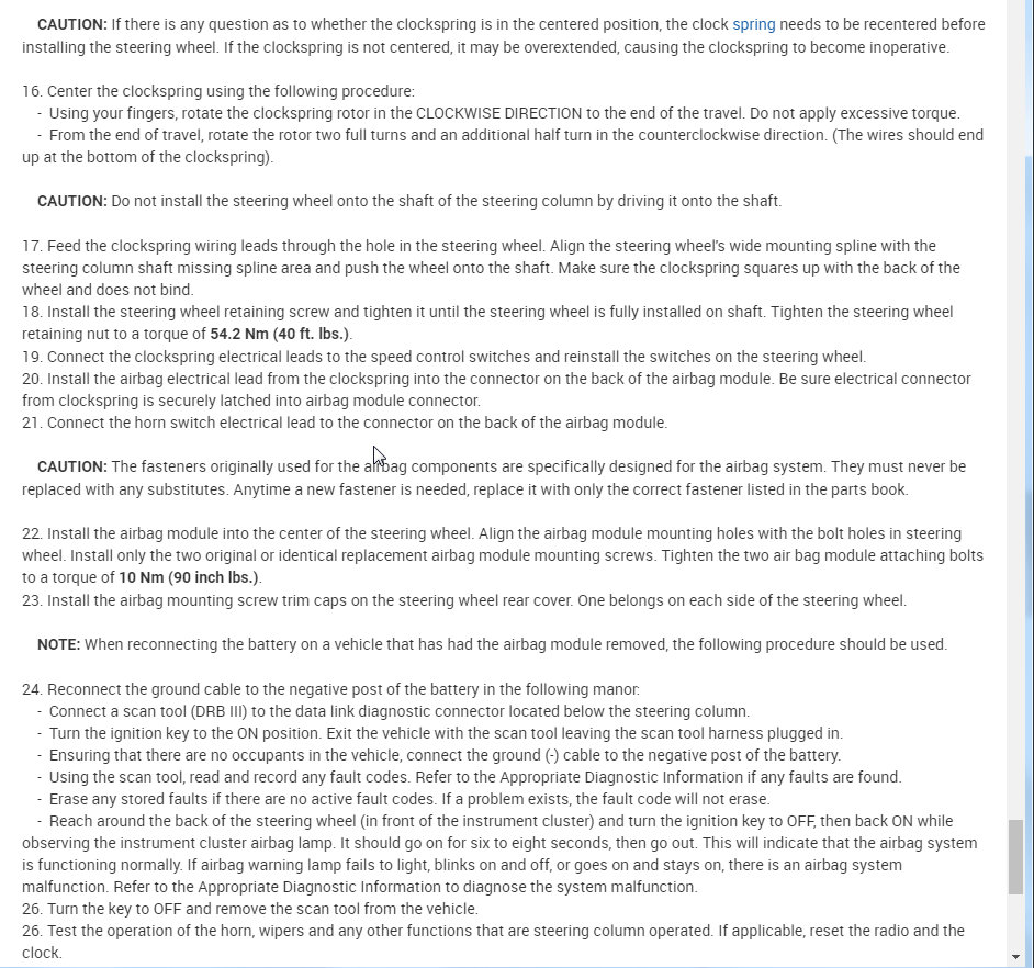

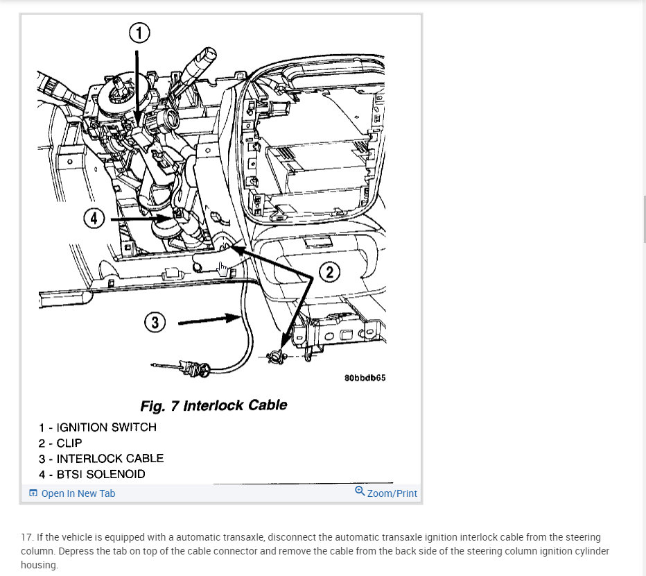

My car was stolen a few weeks ago and somehow by luck or miracle was found and back in my possession and not in as bad of condition as I had expected it would be when I recovered it. but one big issue is apparently while it was gone the ignition switch was pushed in and then started with a screw driver since they didn't have the key. And has not yet been replaced because within 24-48 hours of having the car back it was still able to turn on and off but will no longer start or turn over. I know it needed replacing no matter what obviously but it wet from starting up one day then to nothing the next? At first wasn't doing anything for me but now you can hear it trying to turn over again but has had no luck. Actually sounds like it's almost shutting off on me or something. when it does like it's turning really slowly or doesn't have enough power but battery and connectors seem just fine and should be working.

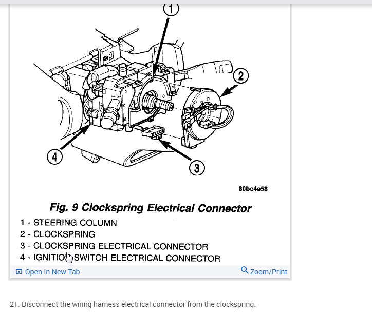

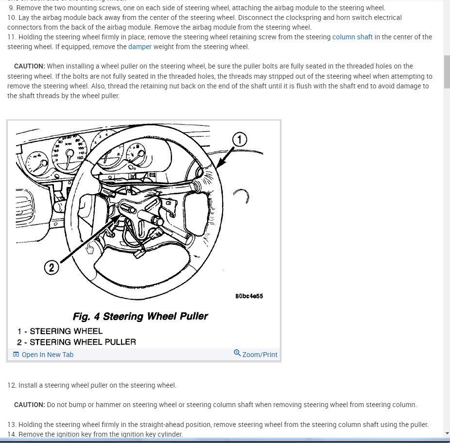

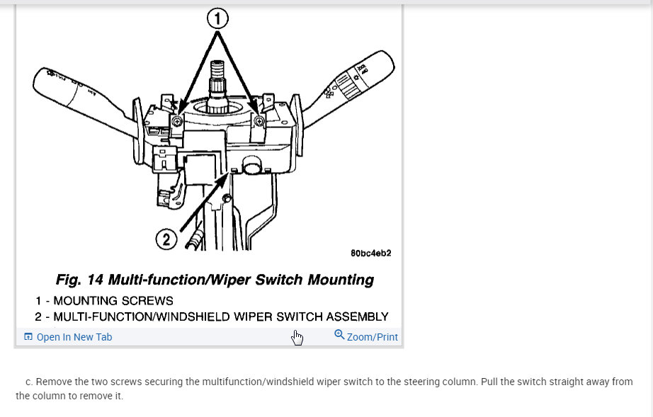

I suspect you have two possible issues. First does sound like a weak battery. So I would charge it or replace it. It that solves the starting issue then you are good to go. if it doesn't then you are going to need an ignition switch. However, I suspect you have both as an issue.
I included the process for removing the steering column. That is how you get the ignition switch out (step 25). You may be able to get to it with completely removing the column but I think this is a vehicle that it does need to be removed. It has been a while since I did one so I can't remember.
JLCH4444
My car won't turn off when you remove the key it keeps running. I am able to reinsert the key and play with turning it back and forth to get it to turn off. I need to know how to fix it, can I do it myself, if not will it be expensive? I do not have much experience fixing anything with cars and my husband is even less help
CARADIODOC
  • 34,367 POSTS
Probably a defective ignition switch, based on your dandy description. It's a common failure item, but not for this symptom. I was surprised by a recent post where the person said the switch took care of his problem, and it was under 50 bucks.
Replacing the switch isn't hard if you can follow the directions in the service manual. You'll need to release the lock cylinder and put it into the new switch. It's much harder to describe than to do. The switch is held in with three tamper-proof torx screws, so you'll need a special screwdriver bit. The Snapon, Matco, Mac, and Cornwell tool truck guys can supply those.
With the right tools at hand, the job takes about 20 minutes.
The lock cylinder should be inspected too. There is a round cam on the end, about 5/8" in diameter. When the cam cracks, it doesn't turn the ignition switch far enough. The very common symptom is the dash lights come on like normal but the starter won't crank the engine. It might crank if you turn the switch real hard, but you risk breaking the key. If this is the cause, the engine should turn off if you run the switch all the way back to the Accessory position. There is a repair kit available to replace just the broken cam.

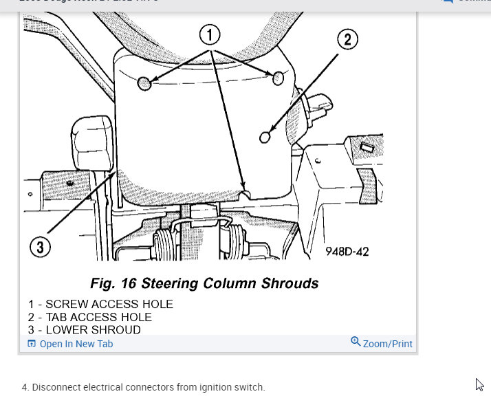

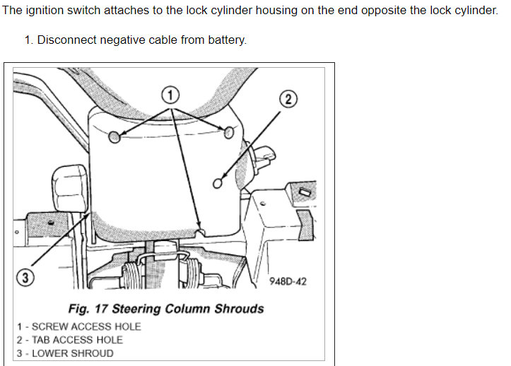

When it doesn't turn off as expected, observe if the radio display is still on. If it is off, the ignition switch moved far enough that the engine should be off too, so suspect a defective switch. Here are the instructions in the diagrams below to show you how to replace the ignition switch. Check out the diagrams (Below). Please let us know if you need anything else to get the problem fixed.

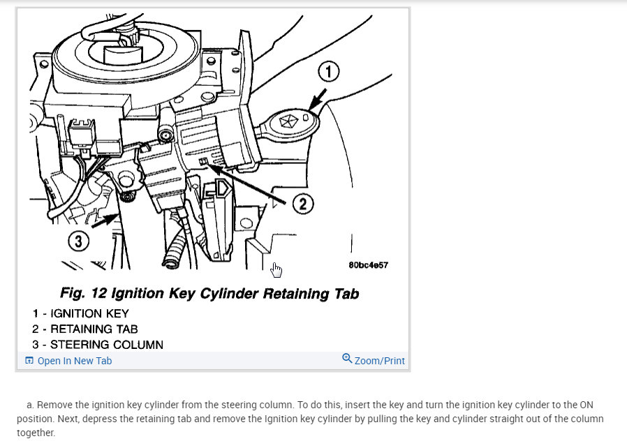

GENEWHORL

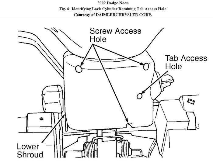

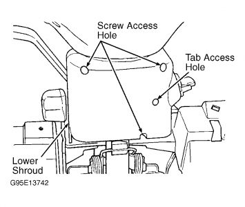

1998 Dodge Neon Sport. I need to change the ignition cylinder. The old one keeps getting locked where you cannot turn the key. Can you tell me how to take out the old cylinder and install the new one.
May 7, 2021 at 4:38 AM (Merged)
BMRFIXIT
  • 19,053 POSTS
if you can turn the key this is what you can do
Removal
Disconnect and isolate negative battery cable.
Turn ignition on.
Using hole in lower shroud, depress lock cylinder retaining tab.
Remove key cylinder.
Installation
A tab on ignition switch aligns with a notch in lock cylinder housing. A slot in end of ignition switch fits over shaft in end of lock cylinder housing.
Use ignition key to rotate lock cylinder to align ignition switch with lock cylinder housing.
TLCOLLINS
how do you take out and replace the key tumbler
BMRFIXIT
  • 19,053 POSTS
Disconnect the battery place key in run position through the hole in lower shroud depress retaining tab remove lock cylinder
https://images.2carpros.com/forum/automotive_pictures/99387_neon96_1.jpg
