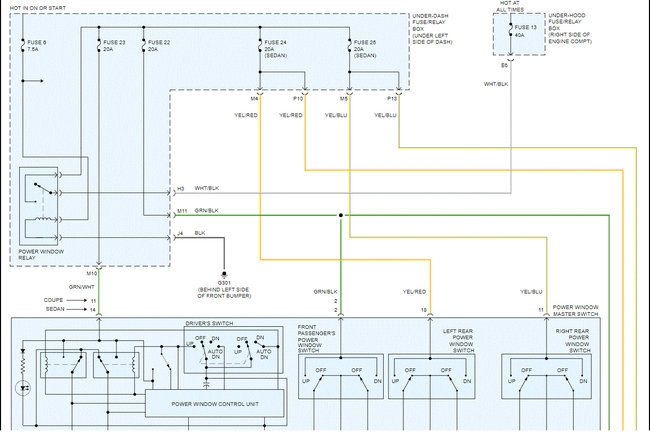

Hi, the right front window motor and the left rear window is not functioning when the switch is pressed. I tested for power at the motors with the switch pressed but I found none. I have checked the fuses, they are okay. I don't know if I can get the circuit diagram.
Feb 24, 2021 at 4:29 AM
  • 110,240 POSTS

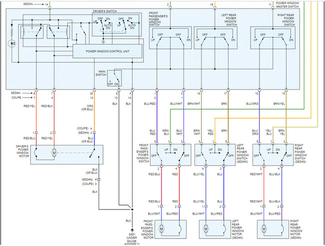

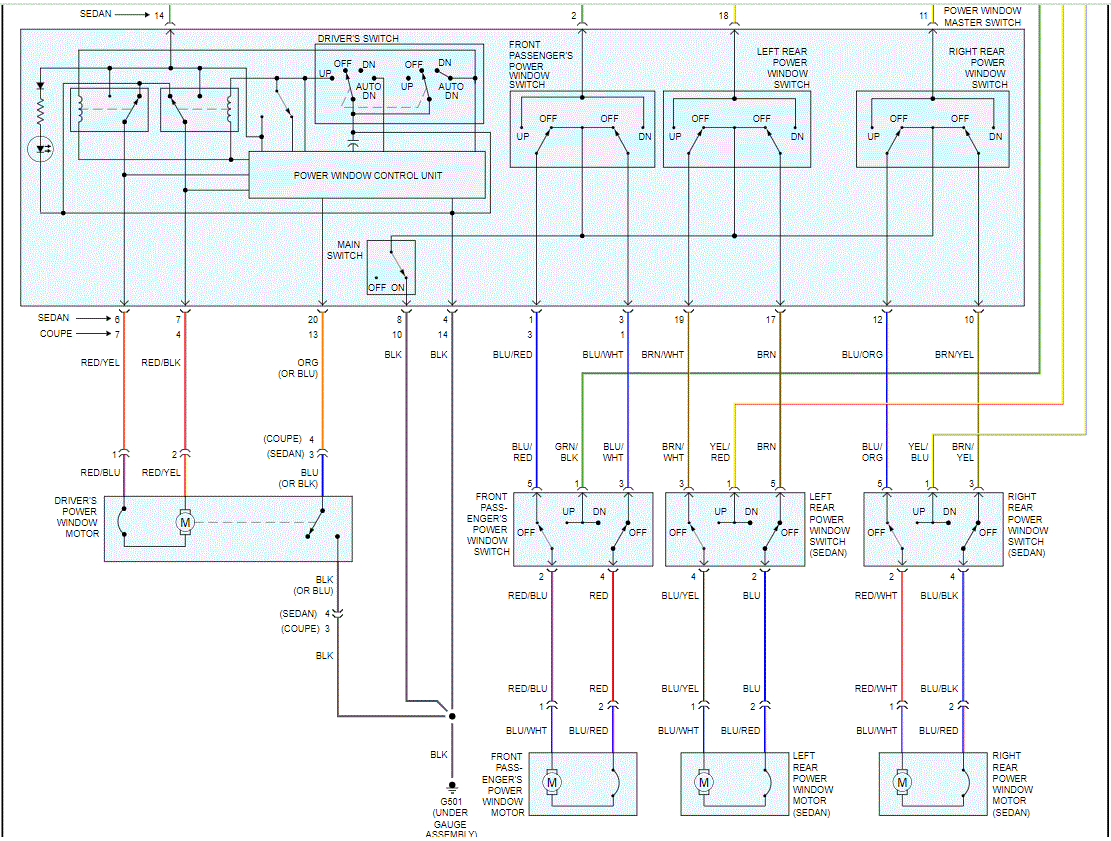

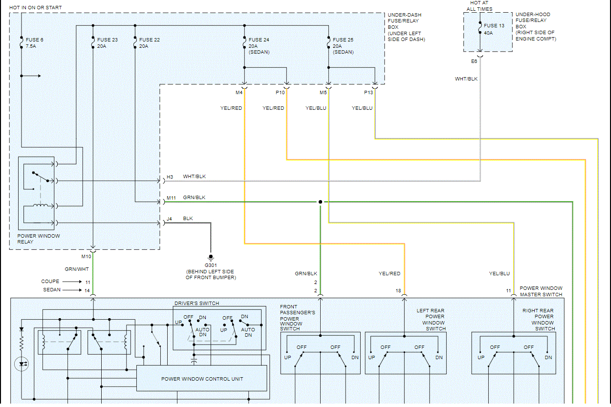

First, I attached the wiring schematic for the power window circuit. There are several fuses that are involved. Also, there is a power window relay. All fuses and the relay are located under the dash in the fuse/relay box.
In addition to just checking fuses, confirm there is power both in and out from the fuse. Here is a link you may find helpful:
Next, check the window relay. If there is another relay with the same part number, switch them to see if it makes a difference. If there isn't, here is a link that explains how to test a relay:
When you checked for power, did you check both wires at the motor? Based on the direction (up or down) requested, one wire at a time will get power. Here is a link to help with testing wiring:

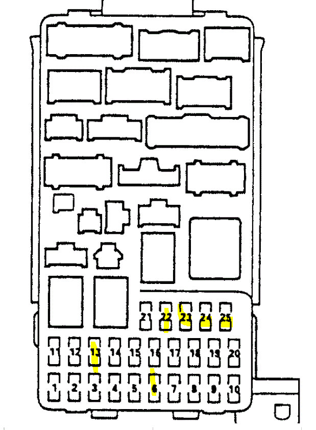

Check all fuses I highlighted in the pics below in pic 3.
