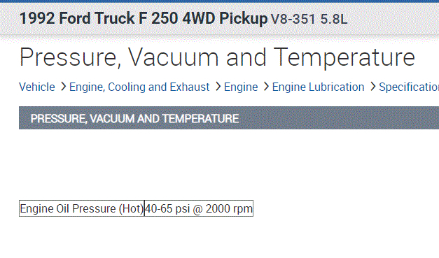

Here is what I would suggest. Contact a local parts store and ask if they have a mechanical oil pressure gauge that you can borrow. Many parts stores lend tools.
Once you get one, remove the new sending unit and install the mechanical gauge. Start the engine and see what is indicated using the mechanical gauge.
By doing this, it eliminates the possibility of an electrical issue causing the low reading. IF you look at the attachments below, they provide the manufacturer's pressure specifications.
Do this and let me know what you find. Also, since it happened after the oil change, just check to make sure nothing was left disconnected or accidentally disconnected such as wiring or vacuum hoses.

See pic below.

I was just wondering if you received my reply from earlier this week. Some additional information. When I rechecked the pressure with the mech. gauge, it was 30psi upon startup, cold then slowly dropped to 20psi and then the needle started extremely fast bouncing from 20 to 0. It then settled after a few revs and warmup to about 10psi. I have attached two links to videos of this.

I did as you suggested and connected a pressure gauge, I put together with parts I had. At cold idle I read 25psi. After a short time, it began to drop which at one point was rapidly bouncing between 20psi and 10psi. Once reaching operating temperature. it was about 7psi and if I increased the rpm it went to near zero. I don't know if the flexible hose I used was too large an ID (1/4" +/-) and with that much air between the block and gauge caused the rapid pulsing? But one thing I did discover is that the shop used 5W30 instead of 10W30. I am attaching two links to show the pressure gauge readings (a few seconds of video each).
