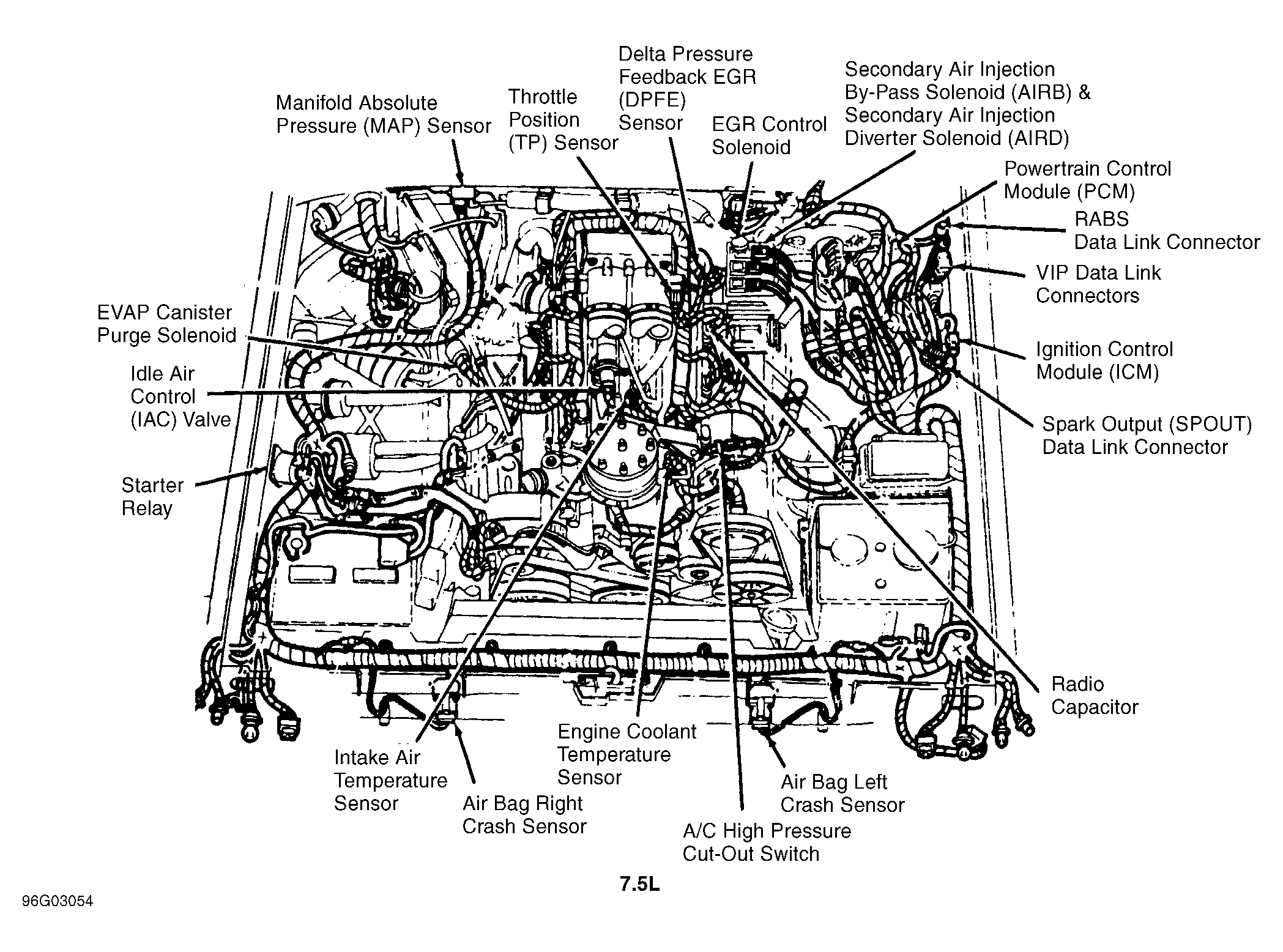

I just test drove a local for sale 1994 f250 4x4 460 efi.
it has an exhaust leak on the passenger side at back. power seems lacking for a 460. the owner is willing to let me have a shop look at it before we settle. other than compression check, and clogged converter....what am I looking for?
can exhaust leak cause the power loss?

2CARPRO JACK
  • 11,533 POSTS
possible depending on how close it is to the oxygen sensor it can mess with the mixture reading.Problem is with those 460's is that the break exhaust bolts, then they harden from the heat and can be extremely difficult/expensive to have removed.Have seen instances where the head had to be removed to get the bolt out, and the cats for those are a little pricey as well
Jul 29, 2020 at 5:52 AM (Merged)

ENGINE ADJUSTMENTS - 7.5L -1996 Ford Pickup F250
Page 1 of 1
IGNITION TIMING
NOTE:
Depending on model, Pickup uses EEC-IV or EEC-V system. EEC-IV PCM
has 60-pin connector. EEC-V PCM has 104-pin connector. See the
ENGINE/VIN ID article for correct application.
With Federal Emissions (EEC-IV)
1.
Set transmission in Park or Neutral. Turn A/C and heater off. Connect inductive timing light to engine. With engine off, unplug in-line SPOUT connector (Yellow/Light Green wire near
distributor), or remove shorting bar from the double-wire SPOUT connector. Start and warm engine to normal operating temperature. DO NOT start engine with remote starter switch; use
only ignition key.
With engine at idle speed, check/adjust initial timing to 10 degrees BTDC. Turn engine off. Reconnect the single-wire in-line SPOUT connector or reinstall shorting bar on double-wire
SPOUT connector. Start engine. Verify timing advances beyond initial setting. Remove test equipment and reconnect all components.
2.
All Other Models (EEC-V)
Ignition timing on models equipped with EEC-V is not adjustable.
IBJACK
Like I asked before ....if my timimg was off wouldnt it act like this all the....and wouldnt my computer make adjustments for that
RIVERMIKERAT
  • 6,106 POSTS
IF you have the EEC-V computer, yes. If you have the EEC-IV, MAYBE, if the timing isn't off too far. But checking the timing willalso tell you if the chain is loose, because you will see the timing mark bouncing around, which is something the computer can't compensate for.
Also check the fuel pressure at the regulator.
