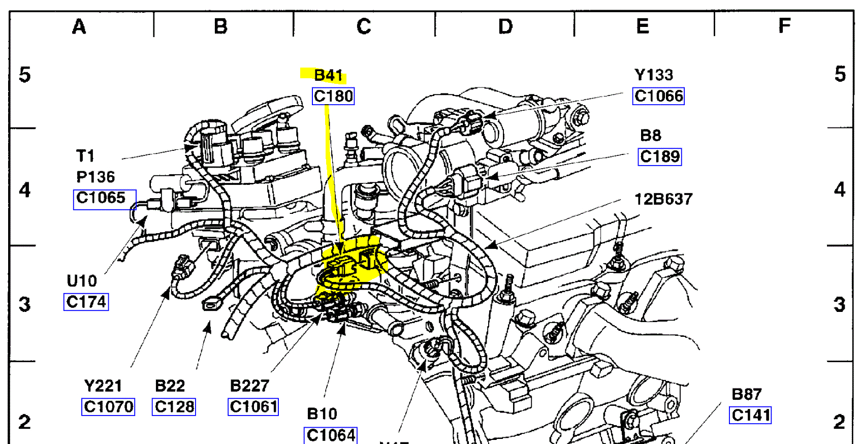

The code, P0343, isn't identified for this vehicle. Could you have possibly transposed numbers? Also, a P0343 is related to a camshaft position sensor (sensor A) input voltage being high. Your vehicle only has one camshaft sensor, so it wouldn't be identified as A.
I did attach a pic below showing the location of the sensor on your vehicle. Make sure it is fully connected and wasn't damaged by anything.

See pic below.
