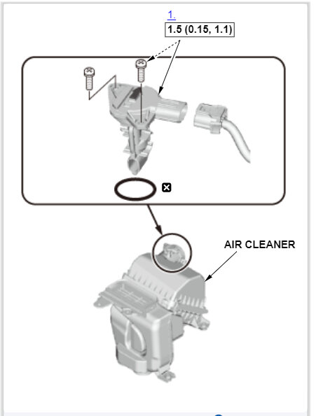

The flashing check engine light indicates the misfire is happening at that time. It certainly could be related to the mass air flow sensor.
Disconnect the MAF sensor and drive it. Does it do the same thing?
The MAF is on the air filter box. See pic below. Try what I suggested and let me know the results. Also, the engine is either a 1.5 turbo or a 2.0L non-turbo. Please confirm that for me.
See pic below.
