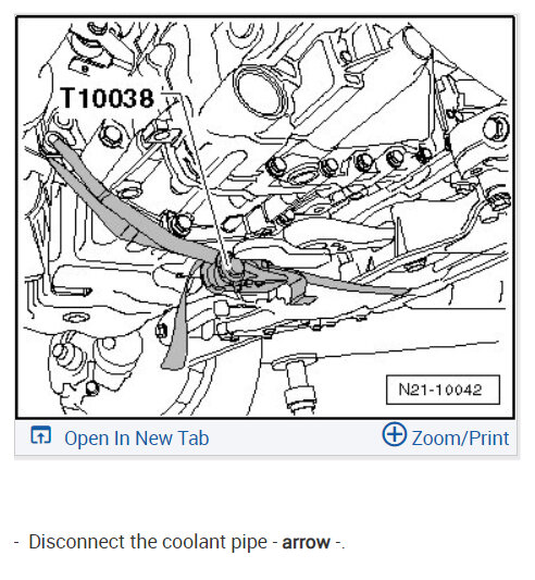

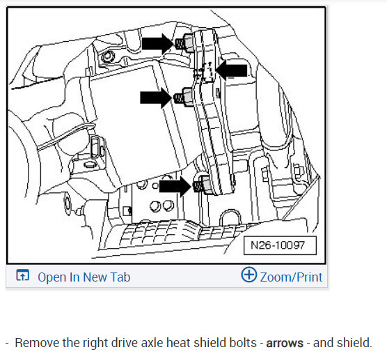

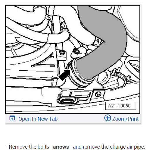

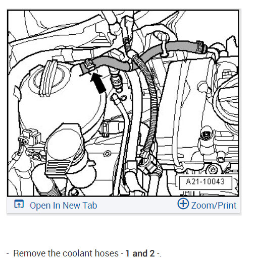

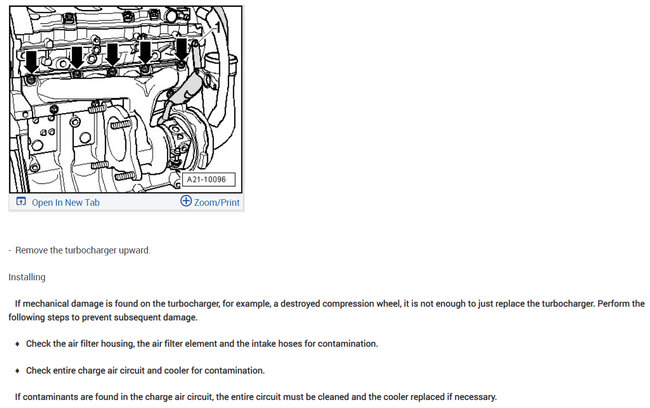

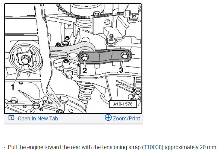

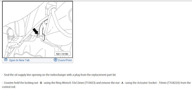

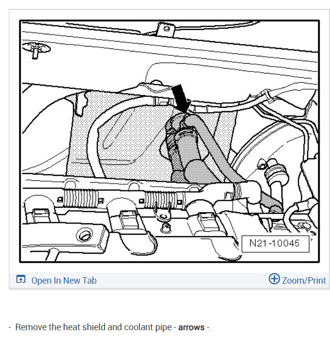

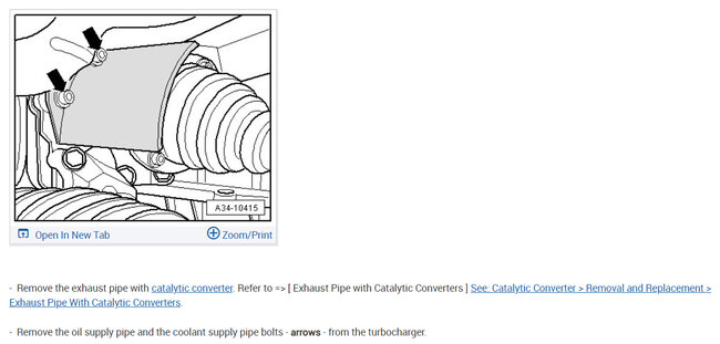

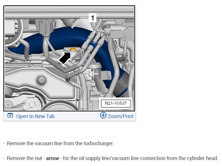

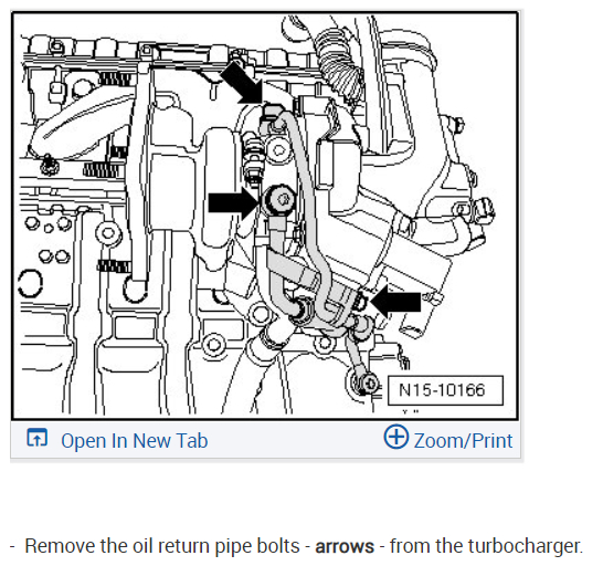

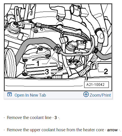

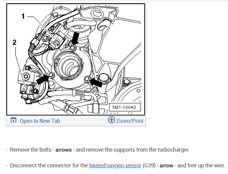

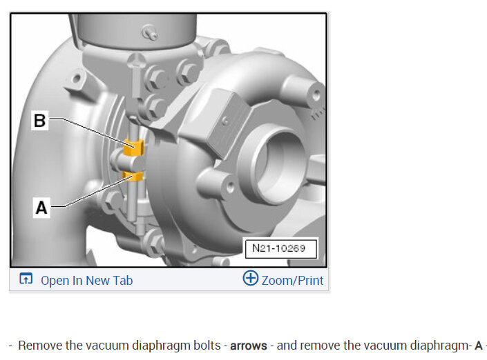

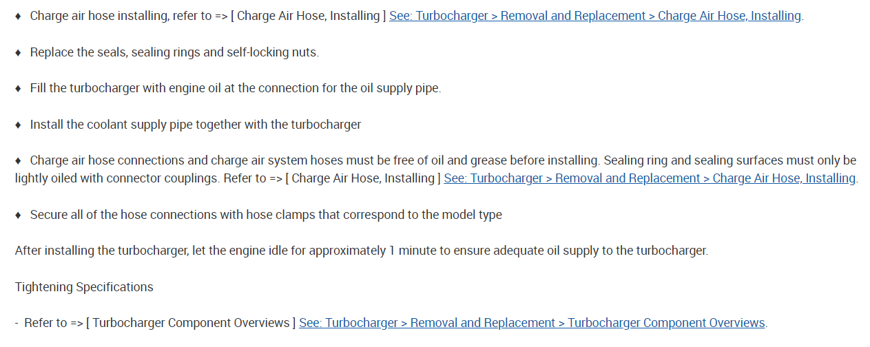

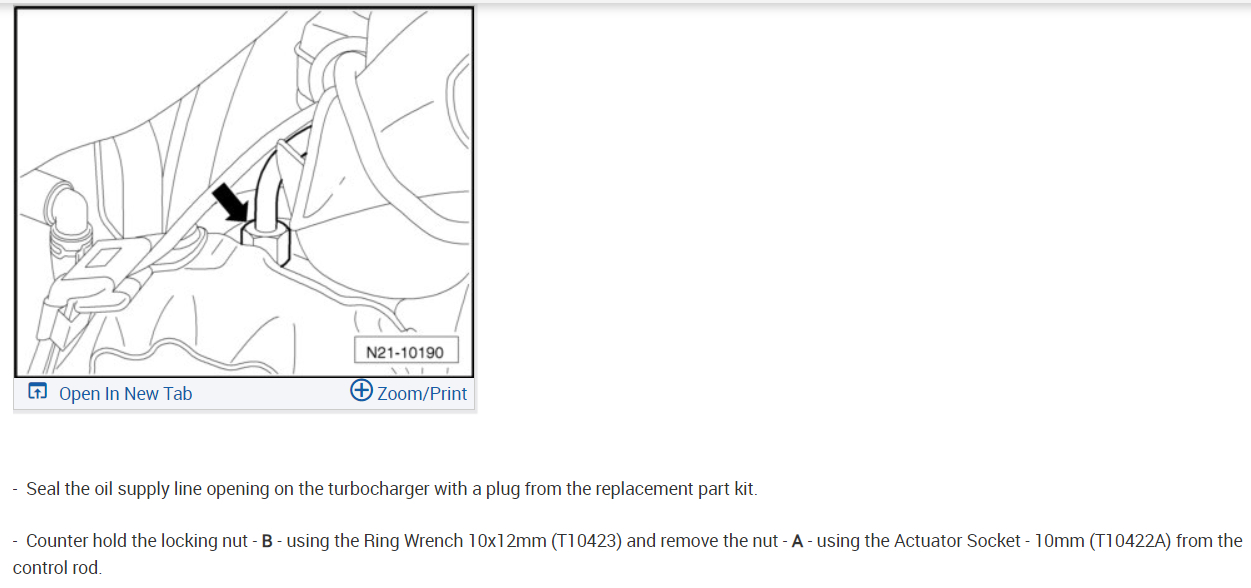

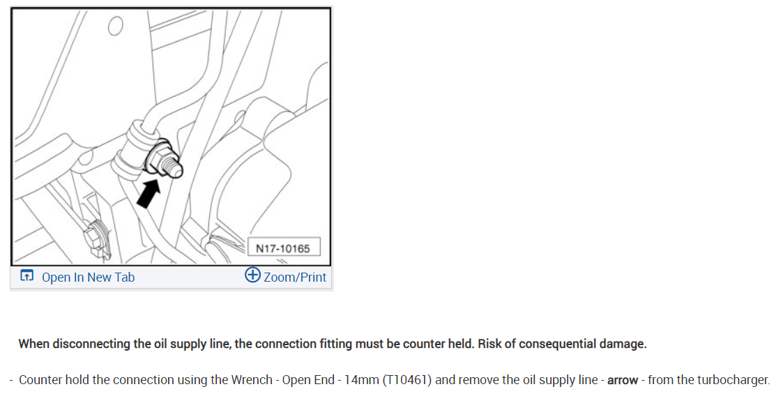

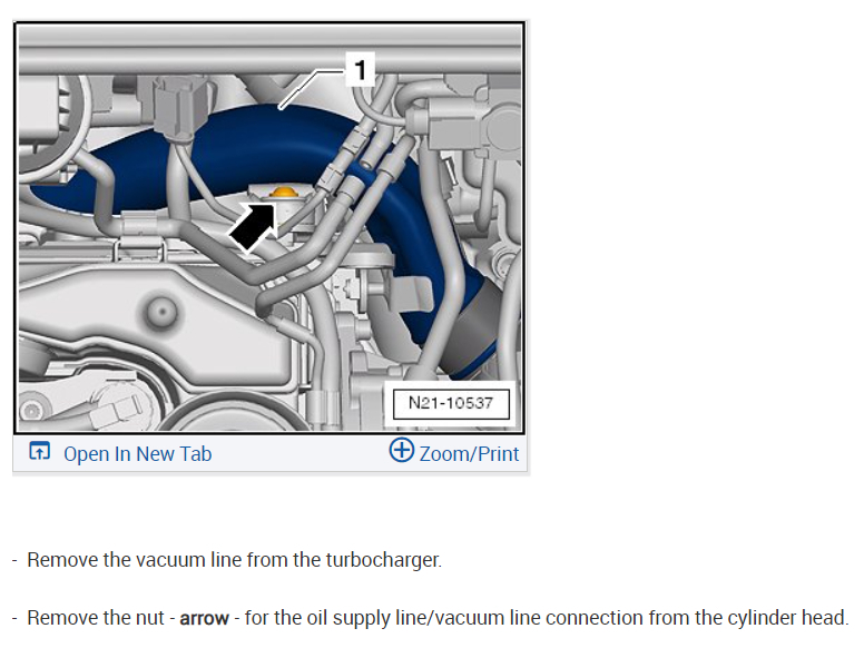

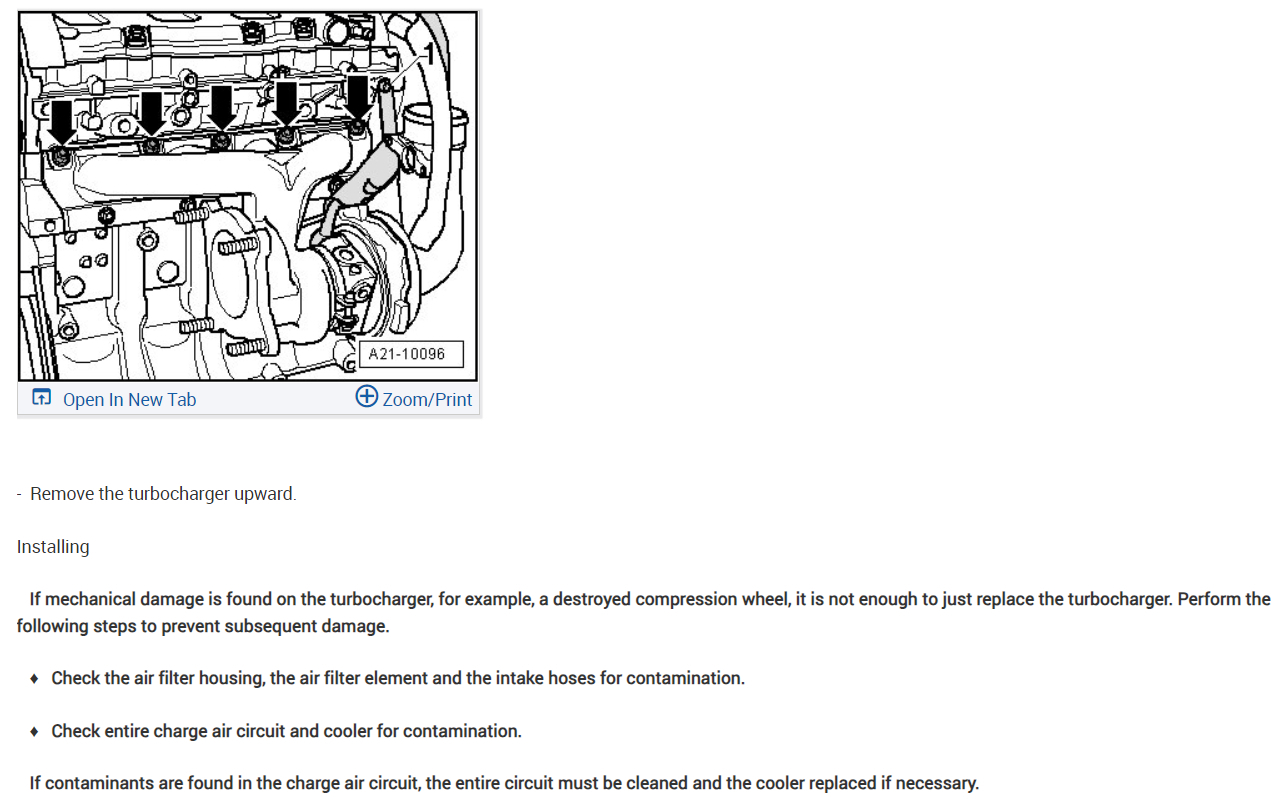

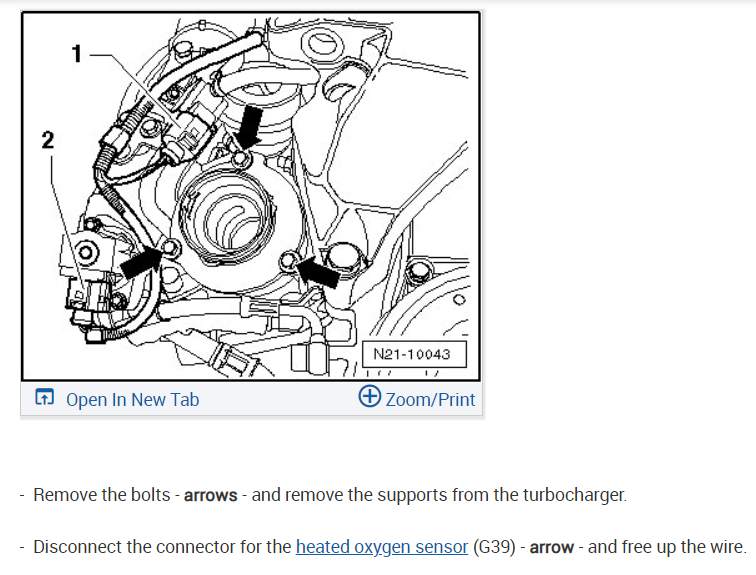

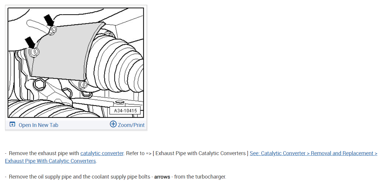

It sounds like the turbo is going out or the exhaust system is partially clogged. I would use this guide to test the catalytic converter and we should run the codes as well. Also please remove the inlet or outlet of the turbo to check the turbo main shaft endplay.
and

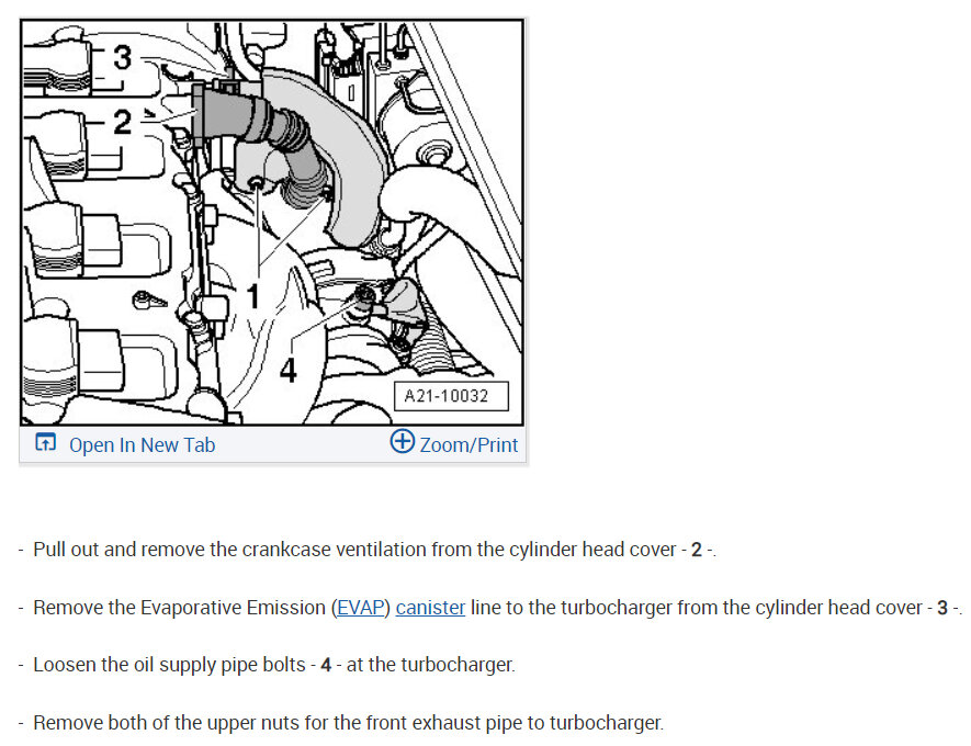

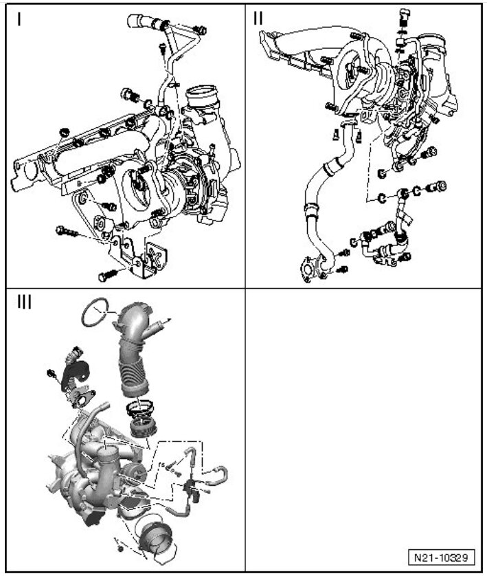

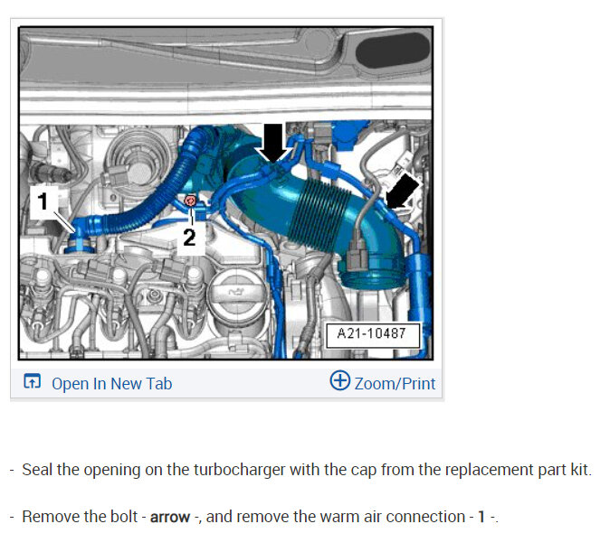

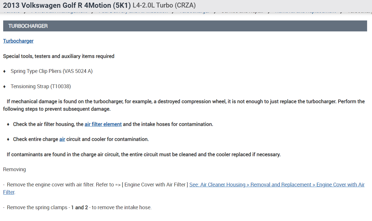

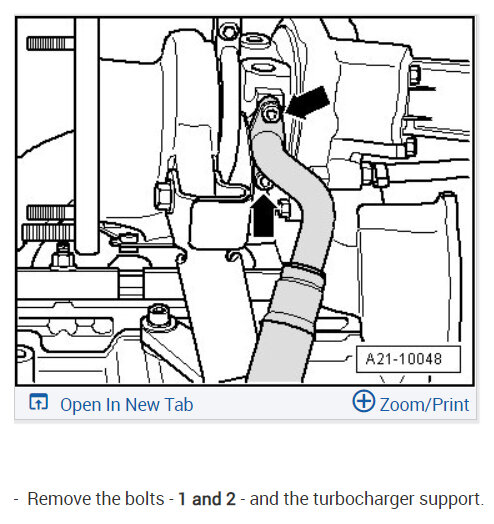

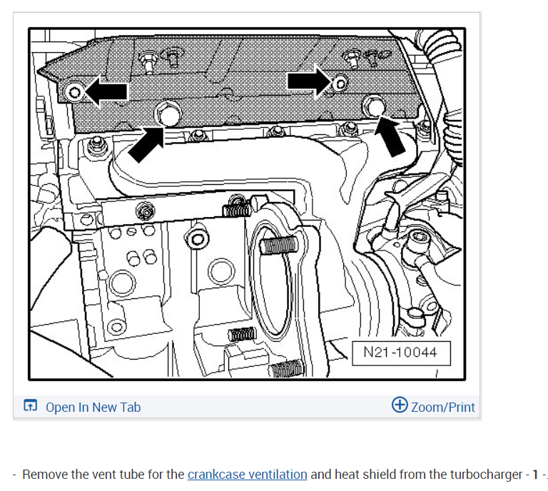

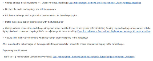

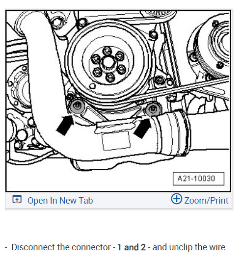

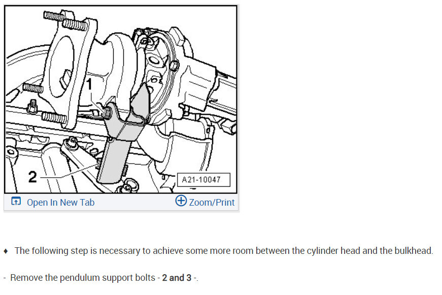

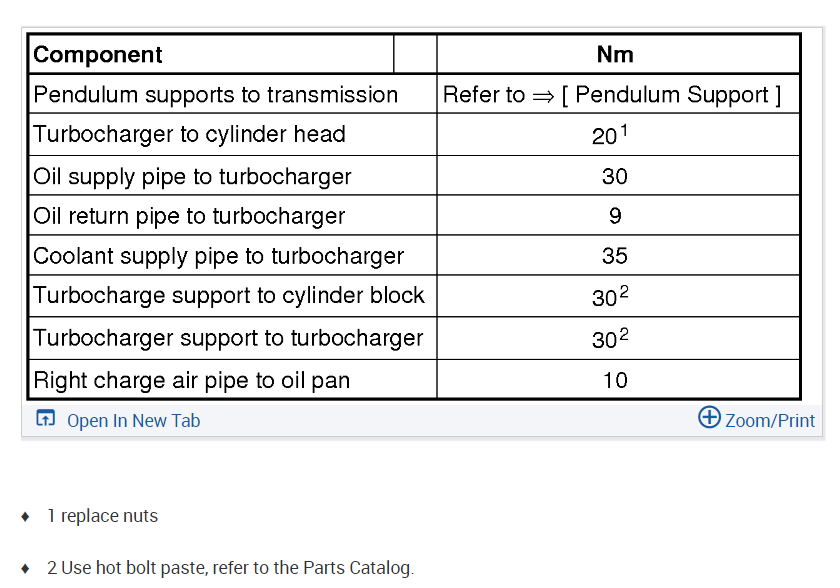

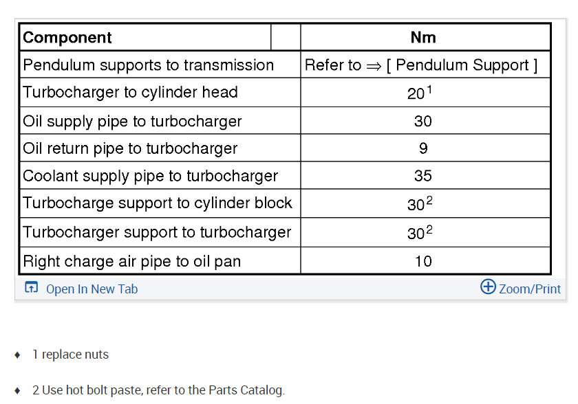

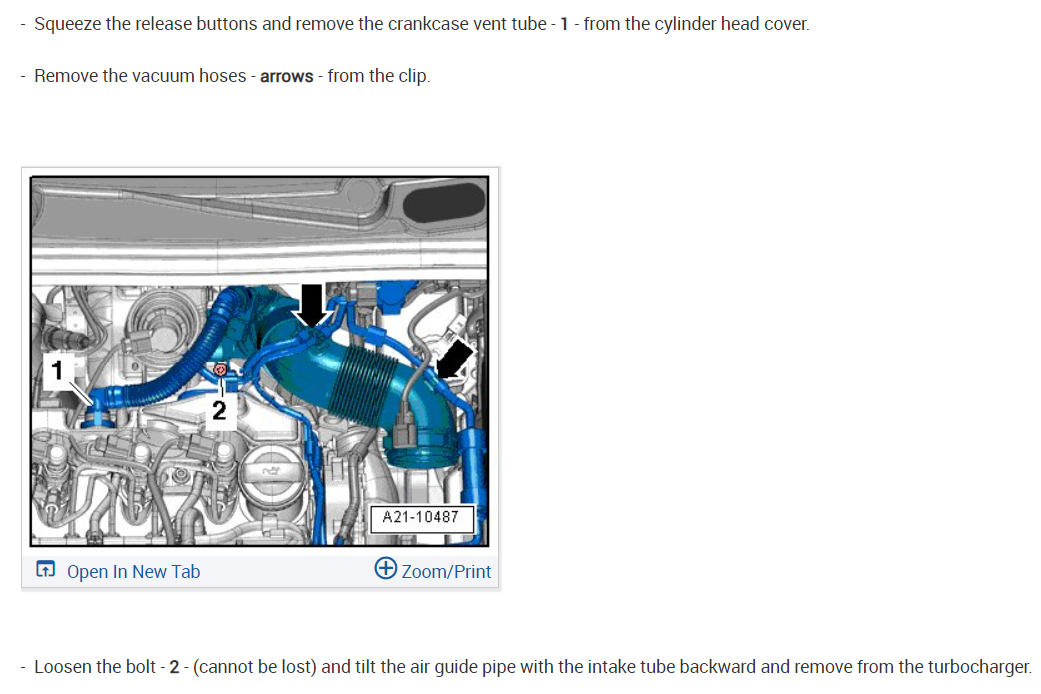

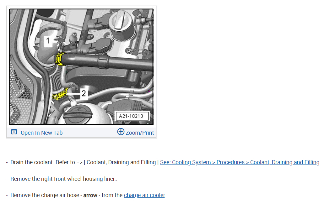

The turbo will boost at low RPM when it goes bad, also if there is engine oil inside the inlet tubes the turbo is bad. Here is how to replace the turbo and check the tubes and endplay. Check out the images (below). Please let us know what happens.

Yep, it sounds like the turbo is no good. It may not have a code for this which is normal. Please check the turbo main shaft endplay which will tell you for sure.

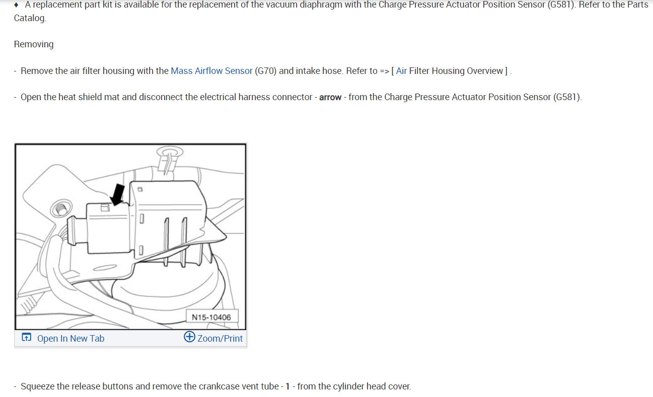

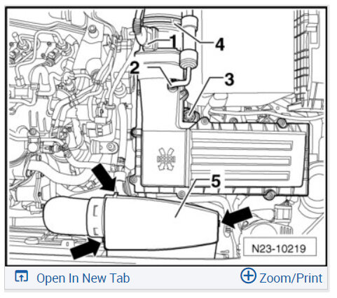

A bad MAF sensor can cause this problem which can happen after a bad turbo, do you have any codes? I would try swapping the sensor out. Here is the location. Check out the images (below). Let us know how it goes.

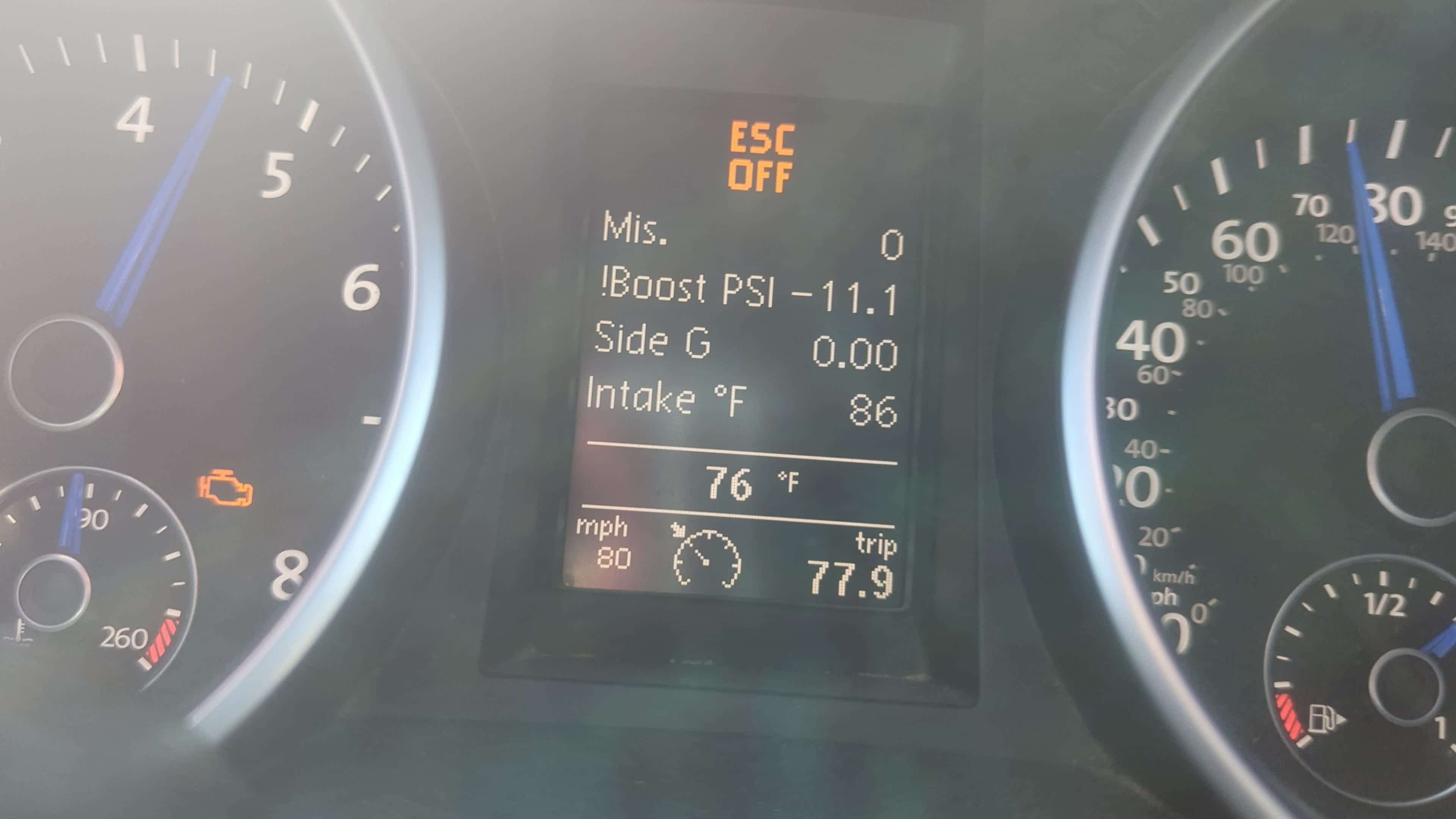

I'm actually driving the car. If I go wide open throttle, I just lose power past 5,000. There are no misfires that happen when this occurs. Feels like the boost is cut and the timing is retarded. I do have a live data feed on my car watching the boost, timing, misfires and more. I can get a video and show you.

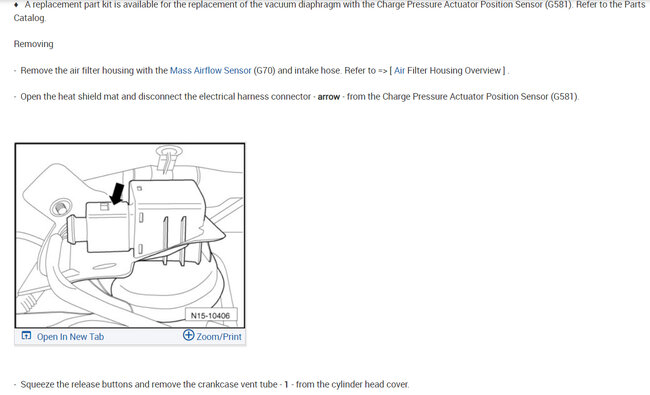

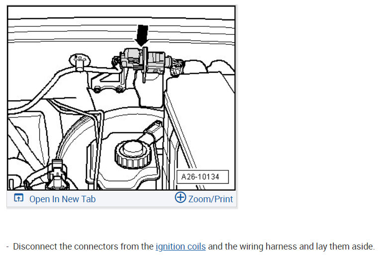

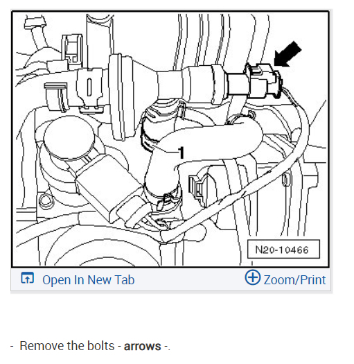

That would be great! This way I can see what's going on. Can you check the vacuum line going to the vacuum diaphragm? I am thinking the vacuum diaphragm could be bad as well, can you please re-run the trouble codes as well? Here is the valve so you can see what I am talking about. You might want to see if it holds vacuum. Check out the images (below). Please let us know what happens.

The only code I have is P0036, and it's for my rear O2 sensor. More specifically, it's a code I'll always have because the wires to that sensor are fried. They shorted on a 300 mile road trip in some deep snow. Otherwise, I have no codes active or pending.

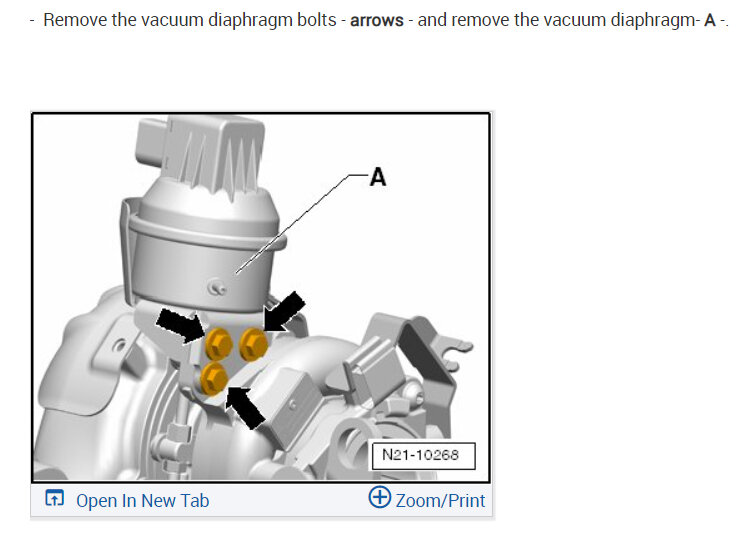

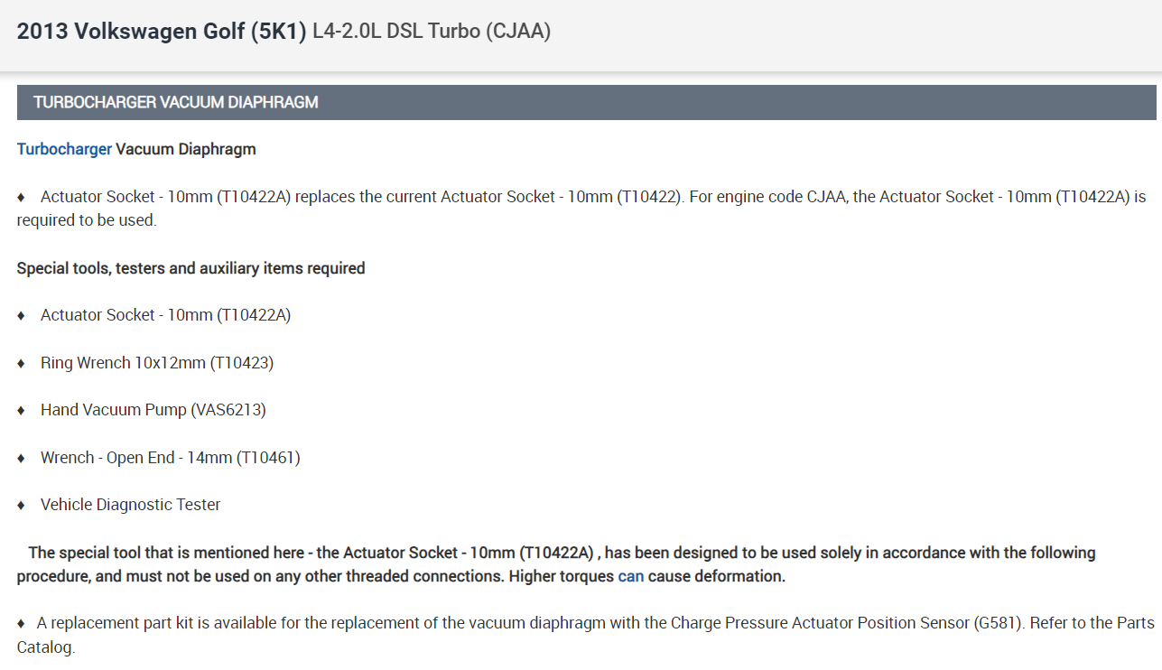

As far as I can tell, the vacuum line is secure and fine. But it looks like the diagrams you gave me are for a MK6 GTI, where I have a MK6 Golf R. It doesn't have the same engine.
And I can go past 5k RPM just fine as long as I'm not trying to floor it. I can go all the way to the red line. I just can't get there by going WOT.

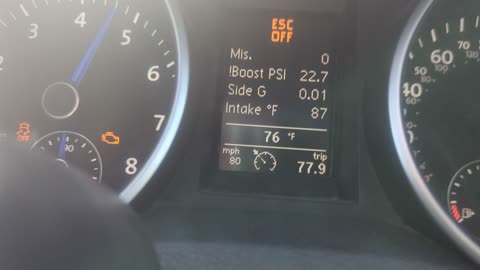

I'm attaching a video showing the live data readout while I'm flooring it.
Feb 19, 2024 at 8:34 AM
BARDOCKOBAMA
  • 17 POSTS
You can hear where I punch it. When the sound stops, I'm not lifting off the throttle. I lift off about a second or so after it stops accelerating.

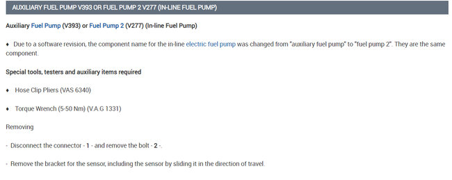

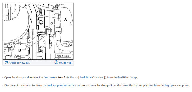

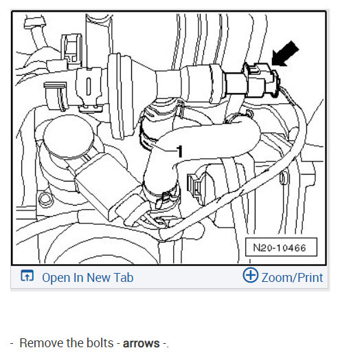

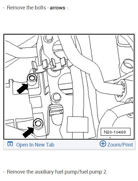

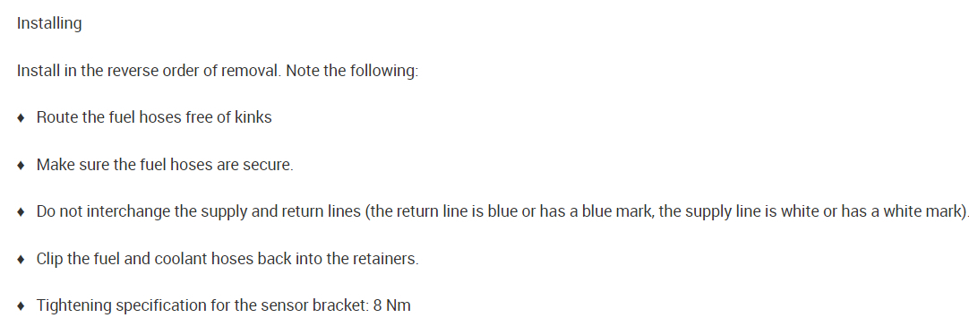

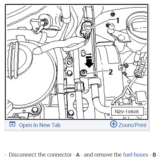

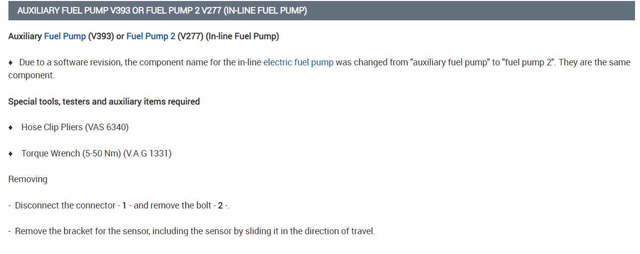

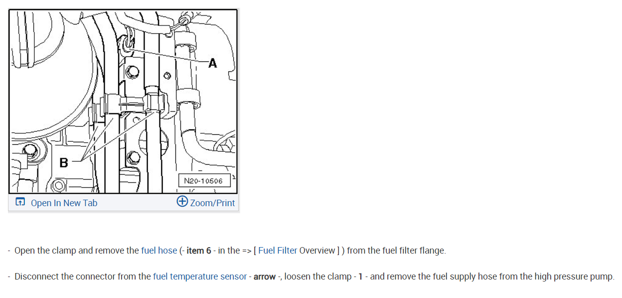

Thanks for the video. It seems like you have a restriction in the air intake of the engine, or the low-pressure fuel pump is getting weak. Is the power okay up to 5,000 RPMs?
Here is a guide to help and instructions for your car in the images below:
Delivery Pressure:
Test Conditions:
The fuses must be okay.
Battery voltage must be at least 12 volts.
All electrical consumers such as, for example, lights and rear window defogger, must be turned off.
Start the engine and run at idle speed.
Close the shut off valve "B" for a maximum of 15 seconds and read the pressure on the Pressure Tester (VAS 6551) :
Specified value .................... 0.5 bar (7.25 psi) minimum
Auxiliary Fuel Pump (In-line Fuel Pump) Pressure:
Test Conditions:
Battery voltage is at least 12.5 volts
The fuel filter is okay.
Fuel tank: Fuel level, min. reserve.
The ignition is off.
Connect the vehicle diagnostic tester and perform the guided function "Check Electric Fuel Pumps".
The fuel pump now runs for 30 seconds.
Let the fuel pump run until the highest fuel pressure is reached.
Specified value .................... at least 3.5 bar (50.7 psi)
Fuel Delivery Quantity:
Test Conditions:
Battery voltage is at least 12 volts
Specified value .................... at least 1000 ml/30 seconds

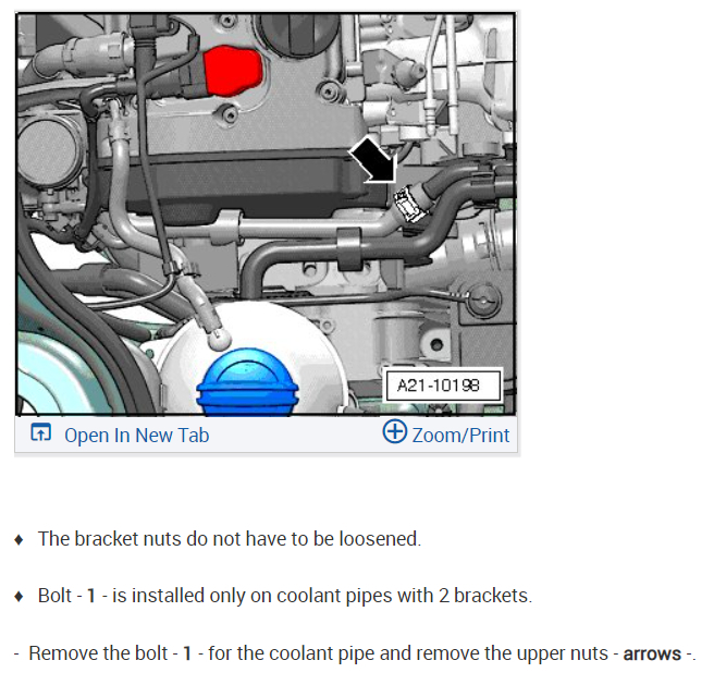

  • 55,709 POSTS

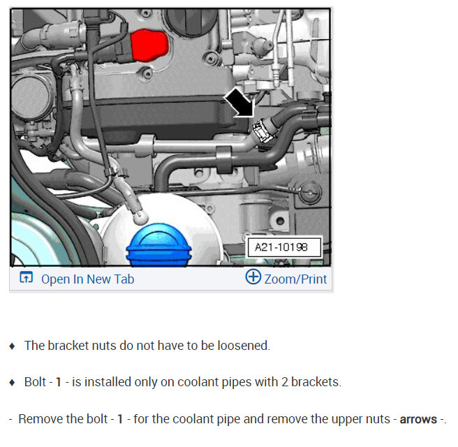

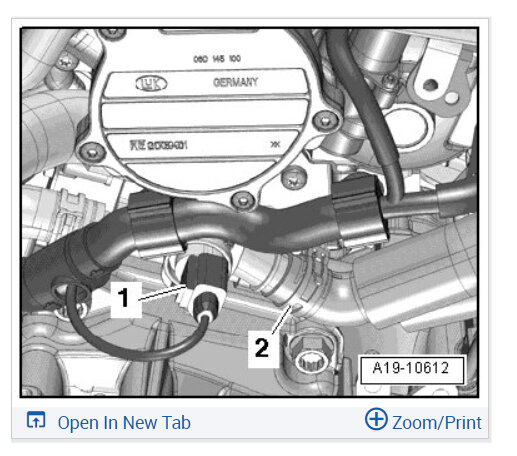

I would rerun the codes to see if any new codes come up, also I have seen engine coolant temperature sensors cause strange problems like this as well. Here is the location if you want to try and swap it out. Check out the images (below). Let us know how it goes.

I have seen worn out MAF sensors cause low power problems and not trigger a check engine light or throw a code. Have you tried a new one?
