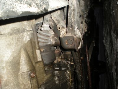

Hi im tring to take off my oil pan rigth now and all the screw ar out if theres hidden one I dont know it juste dont want to comme down do I need to take off extra things out?
or I need to stik a flat screw driver on the side to take it out im I gana damage anything?
thank you for your help :)

What engine size? 1.8L, 1.9L etc?

1.8L

Have you removed the bolts at the flywheel side of the engine? They are pretty hard to get to so many people seem to miss them. If you got those bolts then you may have to lower the subframe to allow the pan to drop

Yes I took out thos 2 bolts neer the flying disk
the pan dont want to move and I dont know nothing about lower the subframe :S
i can put pics on if you want to see
thx.

Remove the stabilizer bar. This should let pan drop down. Would you like stabilizer bar removal steps?

Thx alot for the help but the pan wont move at all do I need to hit it or somting?

The gasket is probably stuck from heat holding it on, yes try using a rubber mallet to budge it loose.

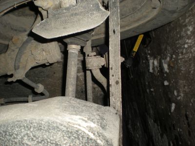

Eee dud I dont have that smal black bar under my car il take pics end send you

Thers no bar under my oil pan well juste a smal one bu theres a liquid in it duno wat wen it will blow il know after :)
