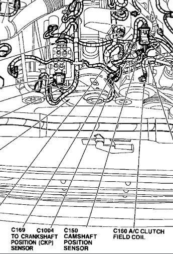

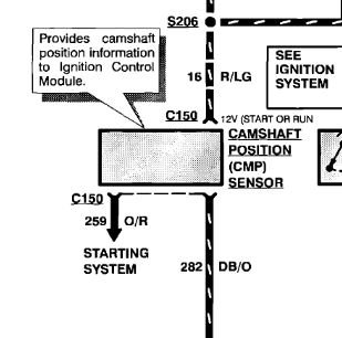

I have to be honest, I don't feel it is a plug wire. Interestingly, in your video there was no backfire after it started running again. If it was a loss of spark, I feel you would have a backfire when the spark returned because the injectors would still be fueling the engine. With that, my next suspect is a camshaft position sensor. I asked your location because the CA emissions ones don't have the sensor. I attached a picture of it. If fuel pressure is good (however you need to confirm what is leaking on the regulator), it seems that something is shutting down injection. That is why leads me to the sensor. The cam sensor on this vehicle signals the ignition module for ignition timing. If I recall correctly, if there is no signal, the injector pulse is lost, too.
I attached two pics. One is location of the cam sensor and the second a portion of a wiring schematic. Locate the sensor and confirm proper connection, eliminate any corrosion, and make sure the pins in the connector are not damaged.
Again, in your video, the engine basically seemed to shut down and then pick back up again. That isn't a loose plug wire.

Ok thank you @joeandnickolas I'll definitely check for a cam sensor I do remember unpluging anything like that on my head or the new head I put on so I will have to see but right now it is raining here an I tested the icm and it is working fine according to the testing

So there wasn't a cam shaft sensor there it's just the distro dummy shaft, but I did notice that my alternator wire was loose and for some reason it drained the battery overnight which I haven't had any problem like that since I bought the truck.
