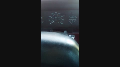

The truck had a bent exhaust valve so I swapped head and now when I accelerate at about 15 mph it feels like it has no power and then at 20 still in first it stalls out and drops speed down to 5 mph. It will go again I would say I have rpm's from idle up to 1,500 to 2,000 while driving and it does it in every gear and it really really really struggles to get past 55 mph. I will add a video later if I need to.

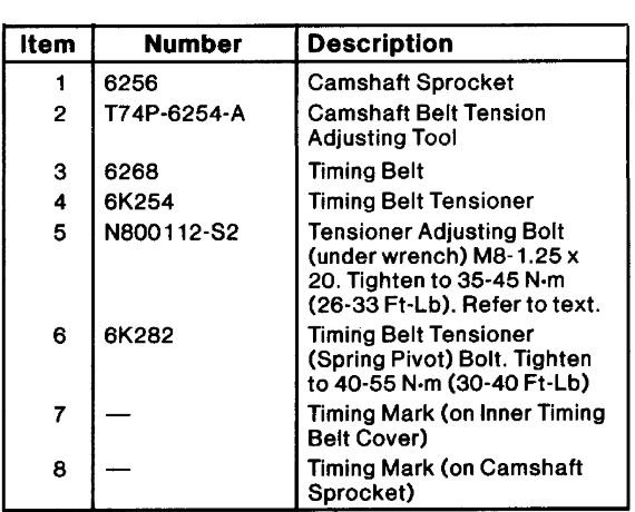

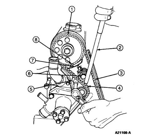

Since you replaced the head, I suspect a couple possible issues. First, are you certain the timing belt was installed correctly? Second, have you checked compression to confirm that the new head and gasket are good? Have you confirmed there are no major engine vacuum leaks? And lastly, are you sure the catalytic converter isn't plugged?
Here are links you may find helpful. Take a look through them.
https://www.2carpros.com/articles/symptoms-of-low-compression
The two pics I attached are related to timing the engine. Confirm that is where the timing marks were when you installed the belt.

Today I'll get a video and show you guys.

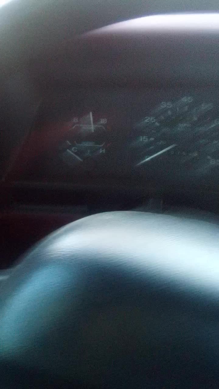

I have to be honest, I don't feel it is a plug wire. Interestingly, in your video there was no backfire after it started running again. If it was a loss of spark, I feel you would have a backfire when the spark returned because the injectors would still be fueling the engine. With that, my next suspect is a camshaft position sensor. I asked your location because the CA emissions ones don't have the sensor. I attached a picture of it. If fuel pressure is good (however you need to confirm what is leaking on the regulator), it seems that something is shutting down injection. That is why leads me to the sensor. The cam sensor on this vehicle signals the ignition module for ignition timing. If I recall correctly, if there is no signal, the injector pulse is lost, too.

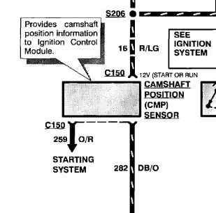

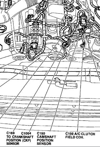

I attached two pics. One is location of the cam sensor and the second a portion of a wiring schematic. Locate the sensor and confirm proper connection, eliminate any corrosion, and make sure the pins in the connector are not damaged.
Again, in your video, the engine basically seemed to shut down and then pick back up again. That isn't a loose plug wire.

Ok thank you @joeandnickolas I'll definitely check for a cam sensor I do remember unpluging anything like that on my head or the new head I put on so I will have to see but right now it is raining here an I tested the icm and it is working fine according to the testing

Sounds like a plan. Let me know what you find. Also, am I correct in saying the engine shuts down for a second or two before it starts picking back up?
Apr 13, 2019 at 1:37 PM
D1DAWG
  • 17 POSTS
Yes you are correct. if I push in the clutch it will come right back to idle but if I just let it do it's thing it will do as you seen it's like it is hitting a spark cut or fuel cut. I have been around cars all my life and I have never seen anything like it. I work at a auto resto and my boss has no idea why it's doing it or what is causing it. he is the one that helped me swap head and he has been in the car business all of his life. so I'm dumb found I really do appreciate everything you guys have suggested, but I can't afford to keep dumping money into the truck.

So there wasn't a cam shaft sensor there it's just the distro dummy shaft, but I did notice that my alternator wire was loose and for some reason it drained the battery overnight which I haven't had any problem like that since I bought the truck.
