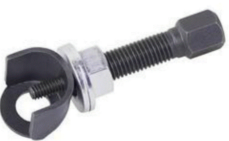

My steering wheel moves all around. I read it's the tilt wheel issue and drop tighten 4 bolts, so I took it apart tightened the put it together didn't fix it. is it dangerous to drive like it is?

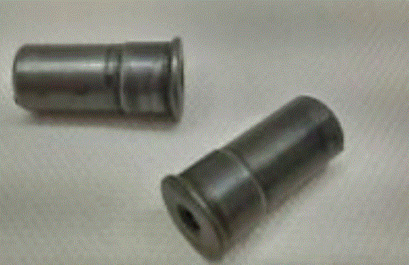

There are two pins in the column that are called pivot pins. They require a special tool for removal. Over time, they can cause the housing they are in to become oval-shaped or damaged. By chance were they replaced or inspected?
Also, the four bolts that you tightened, were they under the turn signal switch, require the removal of the ignition key tumbler, and basically the removal of the pivot pins?
I attached a pic below of the pivot pins I mentioned and the tool for removal.

Yes, I know about the pivot pins. I removed them they're fine. the four bolts I tightened are the ones that have the E torx heads.
