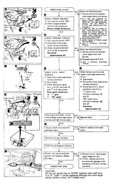

1989 Nissan Pathfinder. After starting it runs ok, then as it gradually warms up it runs rough, sometimes starts to stall while driving, then after about 19-20 minutes it stalls and there is no spark. After sitting for about 30 minutes it will start back up. I have replaced the distributor cap, plug wires, coil and ignition module. Any ideas?

Did you replace the crank sensor which I believe it in the distributor?

Do I have to completely remove the distributor in order to replace it, or can I replace it with the distributor still in the engine? Thank for the information!!

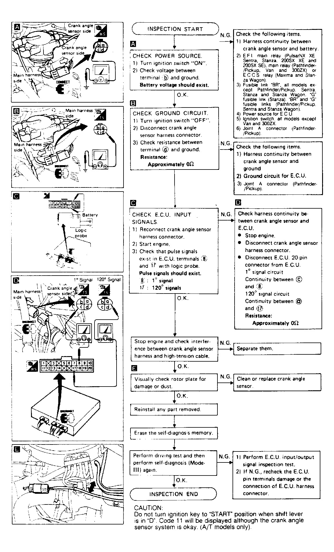

1989 was awhile ago. I don't think it needs removed. My manual doesn't say. Take a look at the attached pic. It walks you through a test procedure. That could save you some time and money.
