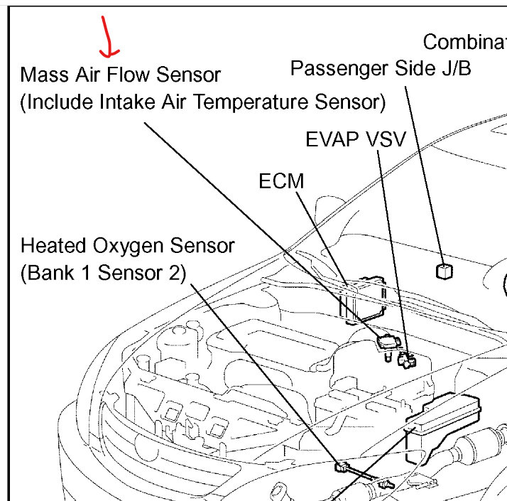

If you can upload an image of the readings that would be great, but from experience I can tell you once the MAF sensor has gone bad for too long cleaning it will not help. I would replace it with a new sensor. This is a main reason for negative number fuel trims. Here is the location of the sensor to make sure we are on the same page. Check out the images (below). Please let us know what happens.
