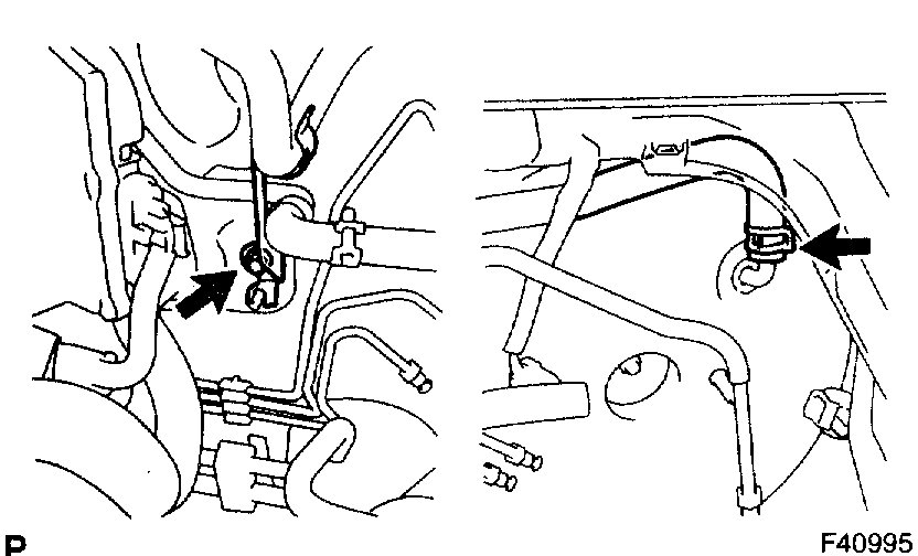

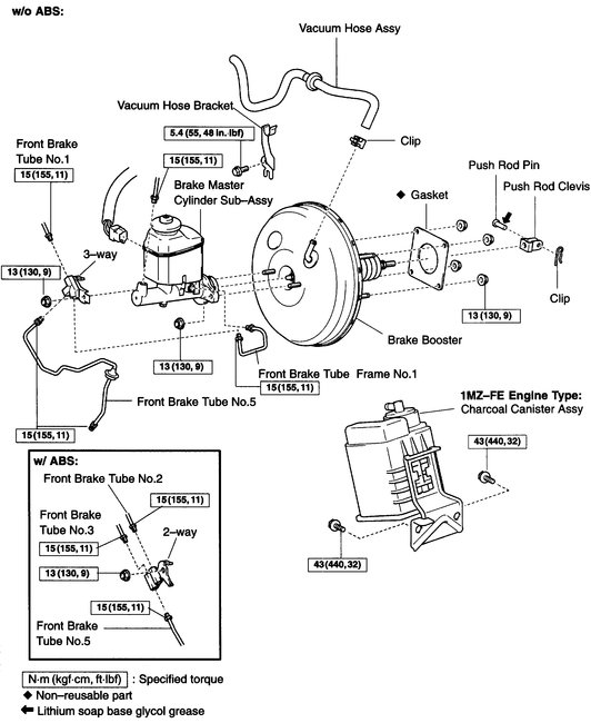

How do I change out my brake booster is it bad.
Nov 7, 2010 at 3:32 AM
  • 110,194 POSTS
Replacing a power brake booster takes a little time, but really isn't too hard to do. I recommend getting a lifetime replacement part so you never have to pay for a new one in the future.
Here are the directions specific to your vehicle. The pics attached below correlate with the directions.
____________________________
2003 Toyota Camry Sedan L4-2.4L (2AZ-FE)
Procedures
Vehicle Brakes and Traction Control Power Brake Assist Vacuum Brake Booster Service and Repair Procedures
PROCEDURES
pic 1
REPLACEMENT
1. DRAIN BRAKE FLUID
NOTICE: Wash off the brake fluid immediately if it comes into contact with a painted surface.

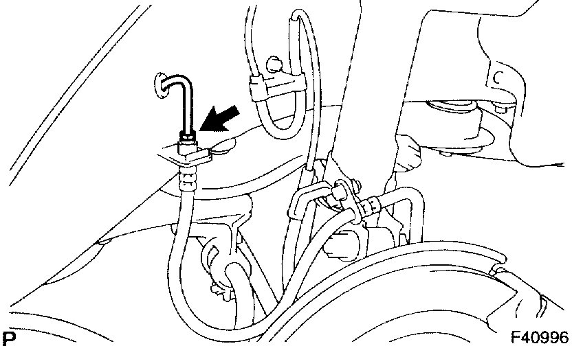

2. REMOVE AIR CLEANER ASSY
3. REMOVE BRAKE MASTER CYLINDER SUB-ASSY
SST 09023-00100

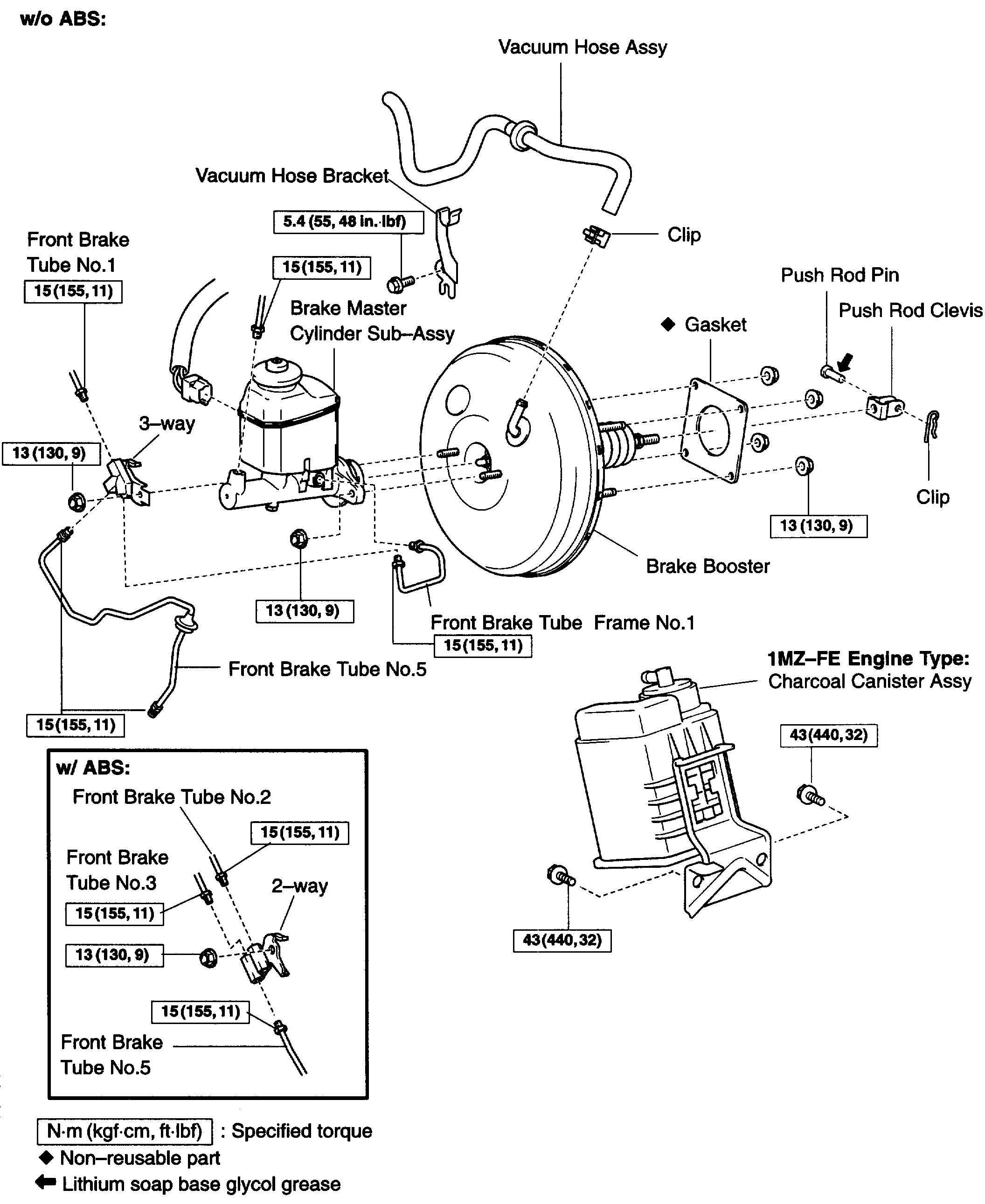

pic 2

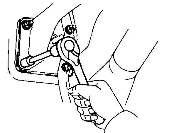

4. SEPARATE CHARCOAL CANISTER ASSY (1MZ-FE ENGINE TYPE)
a. Remove the 2 bolts and separate the charcoal canister from the body.

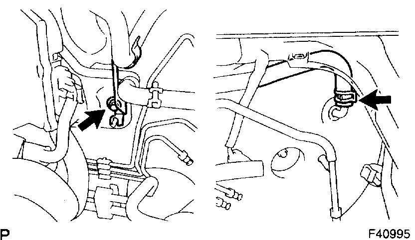

pic 3
5. DISCONNECT VACUUM HOSE ASSY
a. Remove the bolt and separate the vacuum hose from the vacuum hose bracket.
b. Slide the clip and disconnect the vacuum hose from the brake booster.

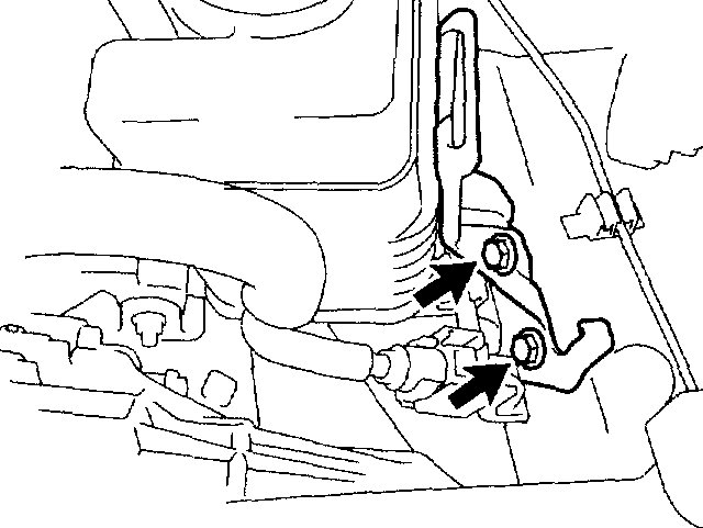

10. REMOVE PUSH ROD PIN
a. Remove the clip and push rod pin.
11. REMOVE BRAKE MASTER CYLINDER PUSH ROD CLEVIS
a. Loosen the lock nut and remove the push rod clevis.
pic 4

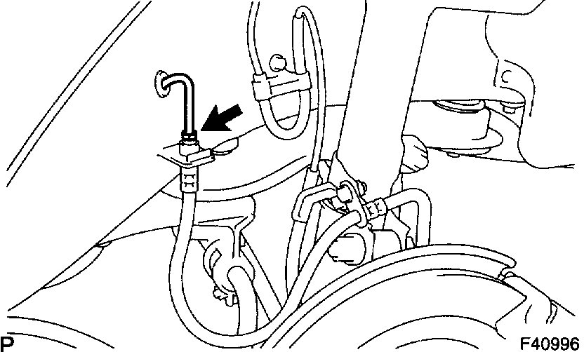

12. REMOVE FRONT BRAKE TUBE NO. 5
a. Using SST and remove the front brake tube No. 5.
SST 09023-00100
pic 5

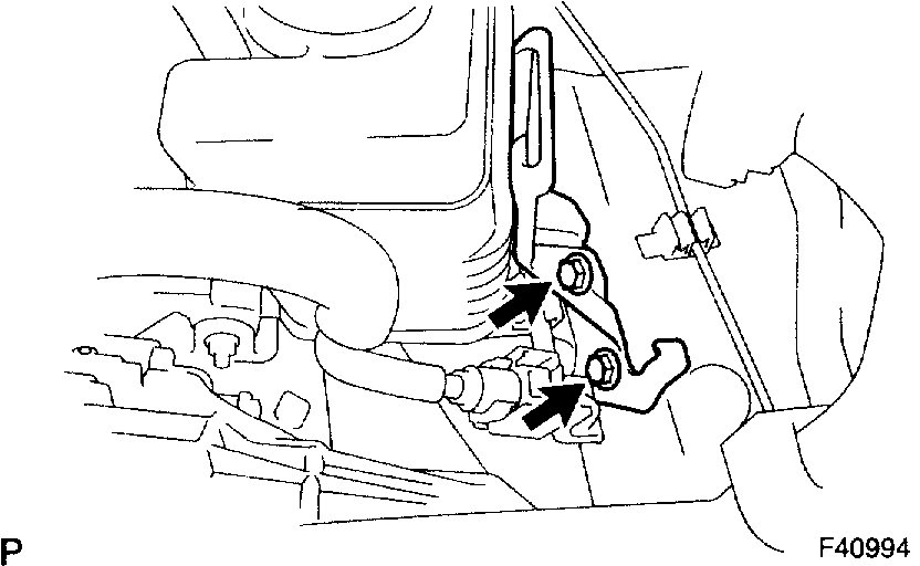

13. REMOVE BRAKE BOOSTER ASSY
a. Remove the 4 nuts.
b. Pull out: the brake booster assy.
14. REMOVE BRAKE BOOSTER GASKET
15. INSTALL BRAKE BOOSTER GASKET
a. Install a new brake booster gasket to the brake booster.
pic 6
