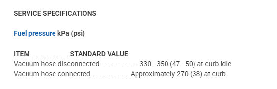

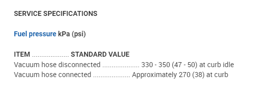

I tried downloading the service manual from E-manual downloads online and didn't go through so I have no resources of how and what numbers should be looking at... Would you know the fuel pressure it should be on?
Apr 22, 2020 at 3:21 AM
I am sorry. I normally attach that. Here it is.
