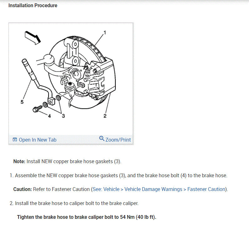

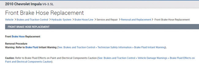

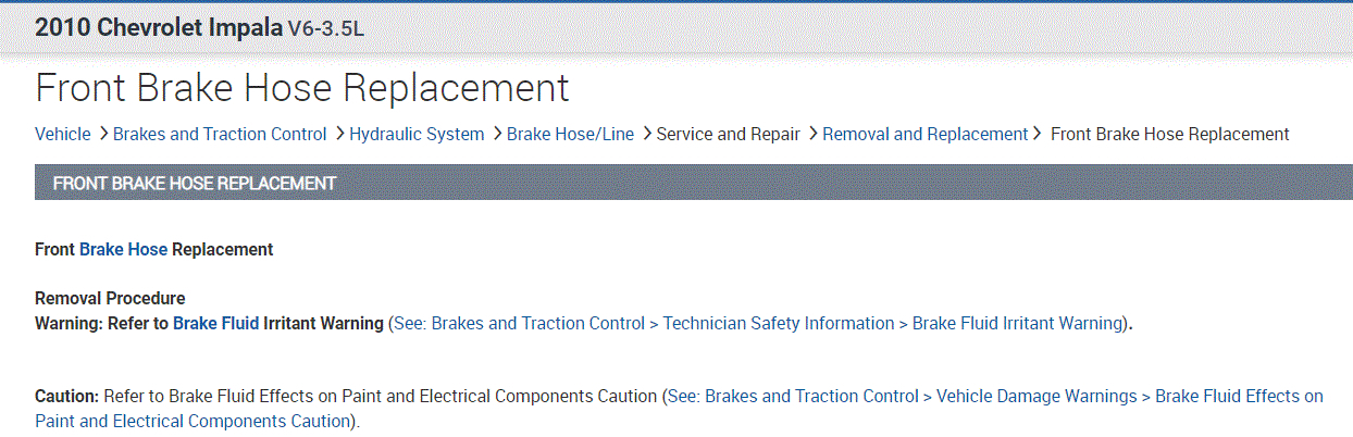

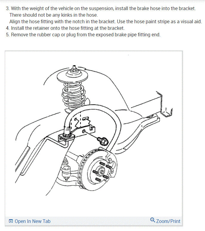

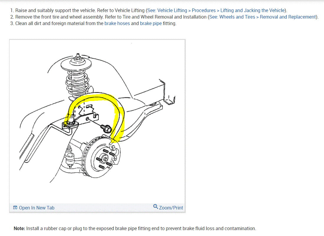

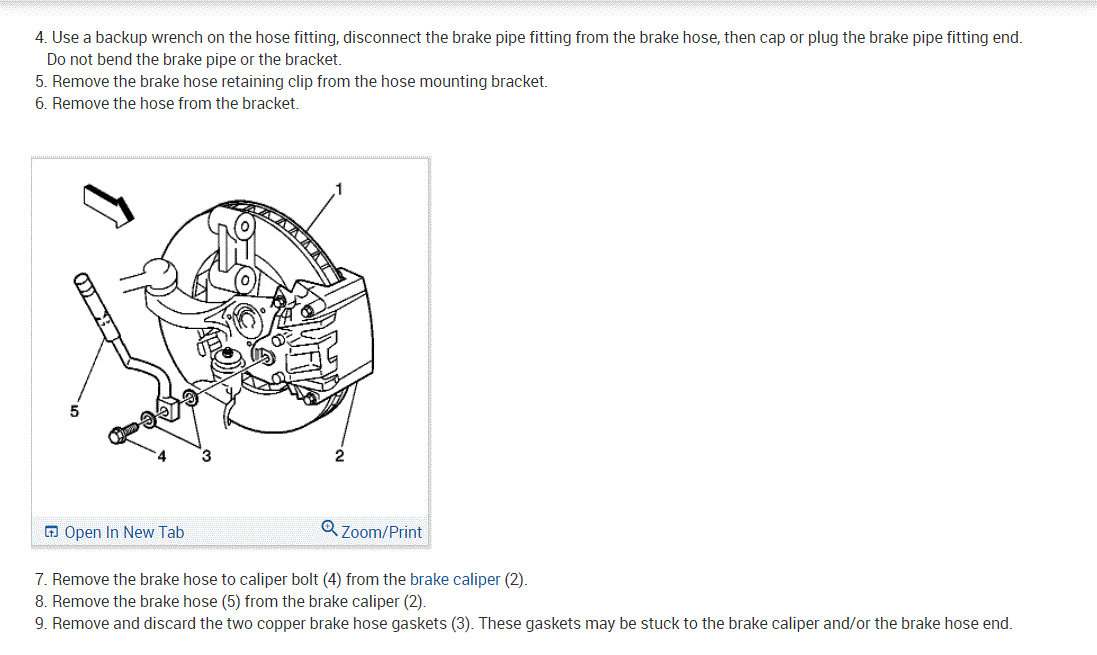

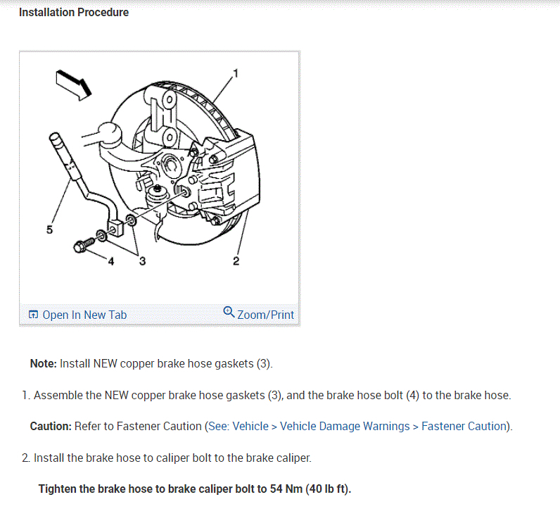

I have a feeling you have a bad rubber brake hose. It is the one that attaches on the rear of the caliper. Over time, they break down internally. As a result, you are strong enough to push fluid through it to actuate the brake, but when you release pressure from the brake pedal, the caliper isn't strong enough to push the fluid back. That is what can cause them to drag or stay engaged.
The easiest thing to do is have a helper press the brake while you have that wheel in the air. When the brake is released, see if you can turn the wheel. If you can't, open the bleeder on the caliper to see if it releases pressure and allows the wheel to turn easily. If that is what happens, it is most likely the hose.
If you look at the attachments below, they provide the directions specific to your vehicle for replacement.

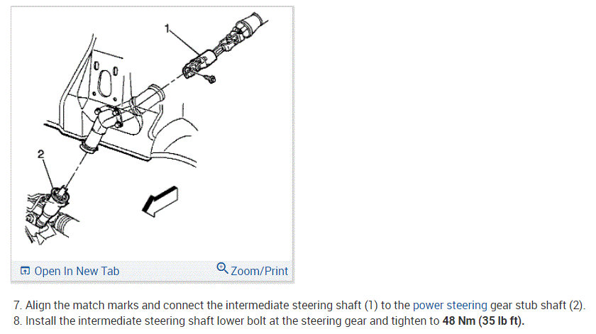

Took it to dealership who said that if was intermediate shaft that is associated with the rack and pinion.
Jun 4, 2021 at 1:17 PM
  • 110,240 POSTS
The intermediate shaft connects the steering column with the rack and pinion. I have no idea how that would cause a power loss or constant grinding. Has the repair been completed and is the problem gone?
Let me know and thanks for the update.
Jun 4, 2021 at 1:27 PM
MZFRAN
  • 6 POSTS
Haven’t been repaired yet, he also stated something about wiring associated with that also.
Jun 4, 2021 at 1:29 PM
MZFRAN
  • 6 POSTS

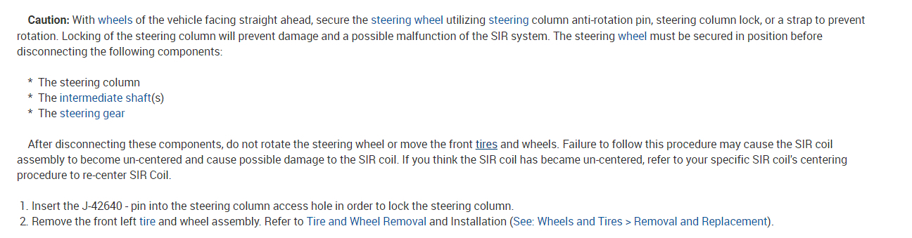

What is the name of the intermediate shaft when trying to purchase it?
Jun 4, 2021 at 1:30 PM

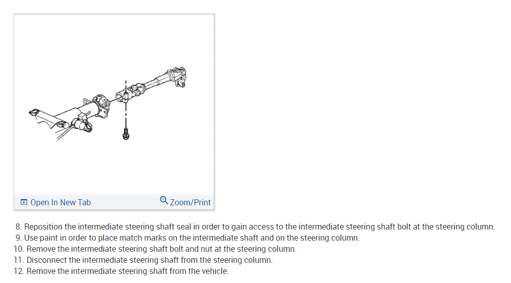

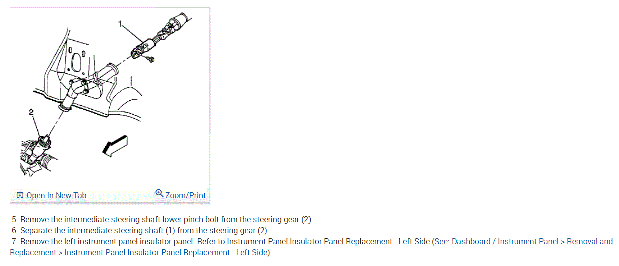

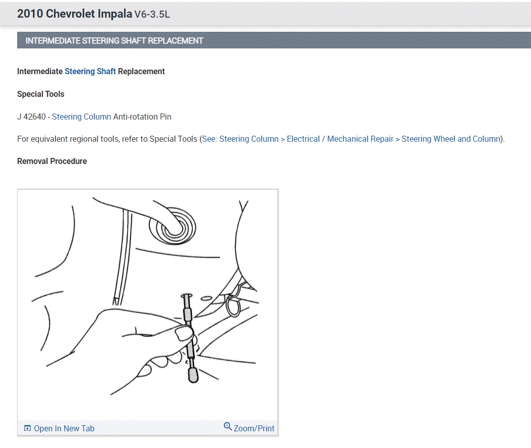

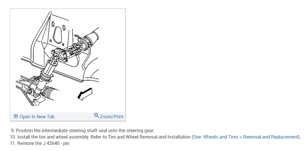

  • 110,240 POSTS

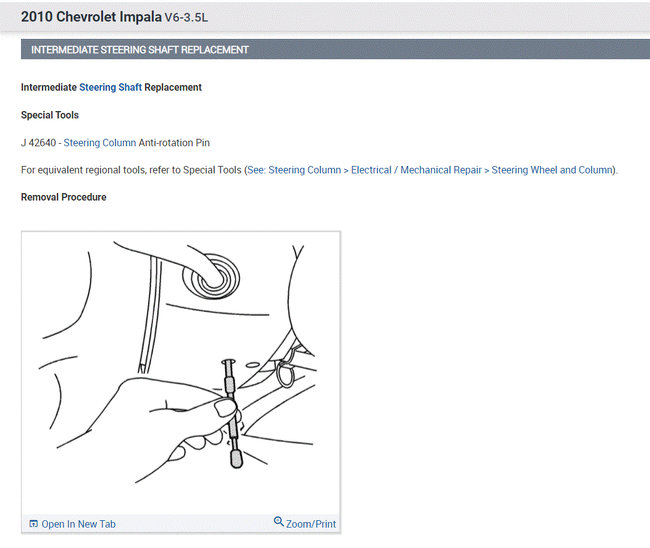

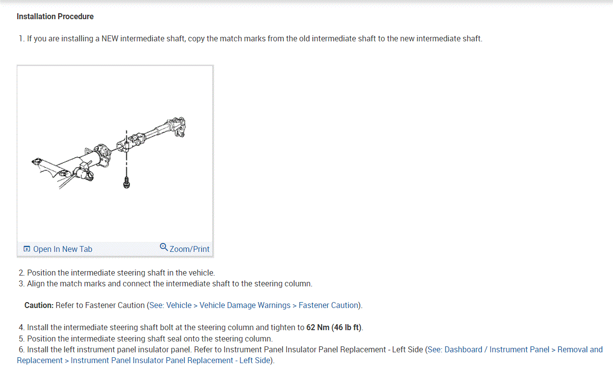

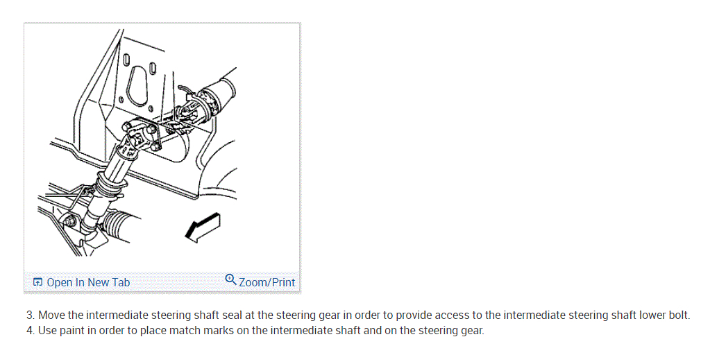

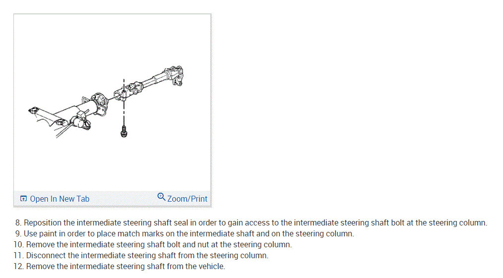

It is the Intermediate steering shaft. I attached the directions for replacement below. Take a look at them and see if you are comfortable doing it. I can help from this end if you run into trouble.
Once you take a look through the directions I provided, I have a feeling you will understand why I don't think it would cause power loss or a constant grinding sound. Usually when the joints go bad, you will hear a clicking sound when turning the steering wheel. I'm not saying it isn't bad, I just don't know how it would affect what you are experiencing.
