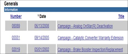

Thanks for your reply! I took it to the dealer, yes it was the catalytic converter, and it was covered under the extended EPA law. Runs like new again! The 2001 and 2002 Impalas are covered for 10 yrs/120,000 miles.
