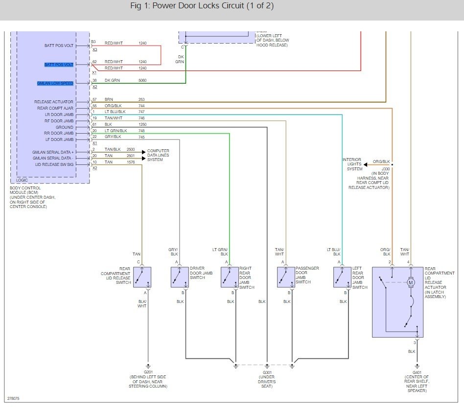

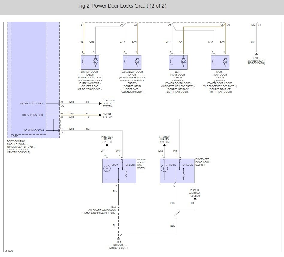

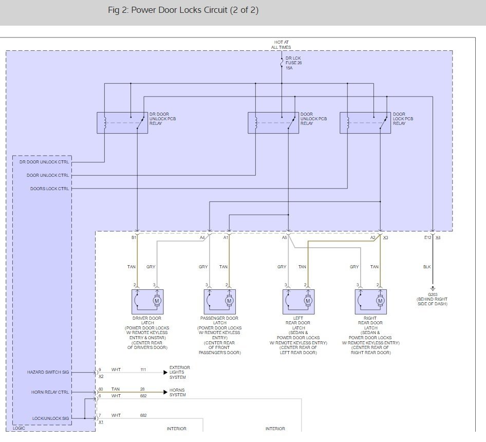

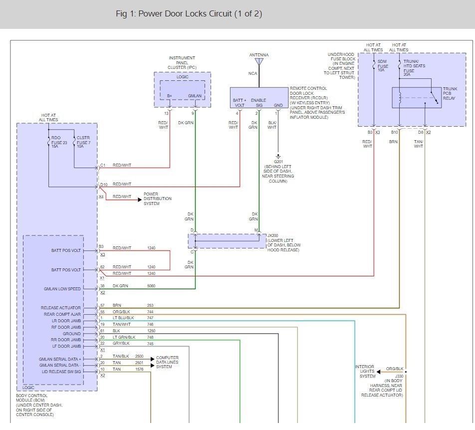

Hello, can you please tell why would the power locking would stop working and would not lock or unlock when press but it will do it on the passage side. Also, the buttons on my remote have stop working, it will not lock or unlock it would not even pop the trunk open. neither set the alarm off. what should I do to fix these problems?
May 9, 2017 at 12:10 PM
  • 55,433 POSTS
It sounds like you have two different problems, first for the key fob its sounds like the battery is weak and needs to be replaced, next for the door locks it sounds like it could be a fuse or the main switch has gone out which is common.
Here are some wiring diagrams and a guide so you can do some testing to get the problem fixed.
and
Please run some tests and get back to us so we can continue helping you.
