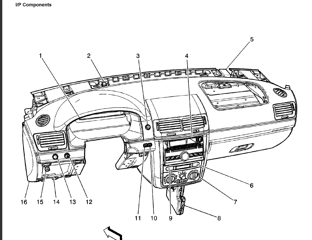

Your problem sounds like it could be a big or little problem (great right?). The little problem would be like a loose or corroded battery terminal. For that fix. Here is a guide to help you:
If that checks out the BCM controls the items you have mentioned which makes me think the BCM is going bad.
Here is its location (below) you will need a shop or dealer to program it for you.
