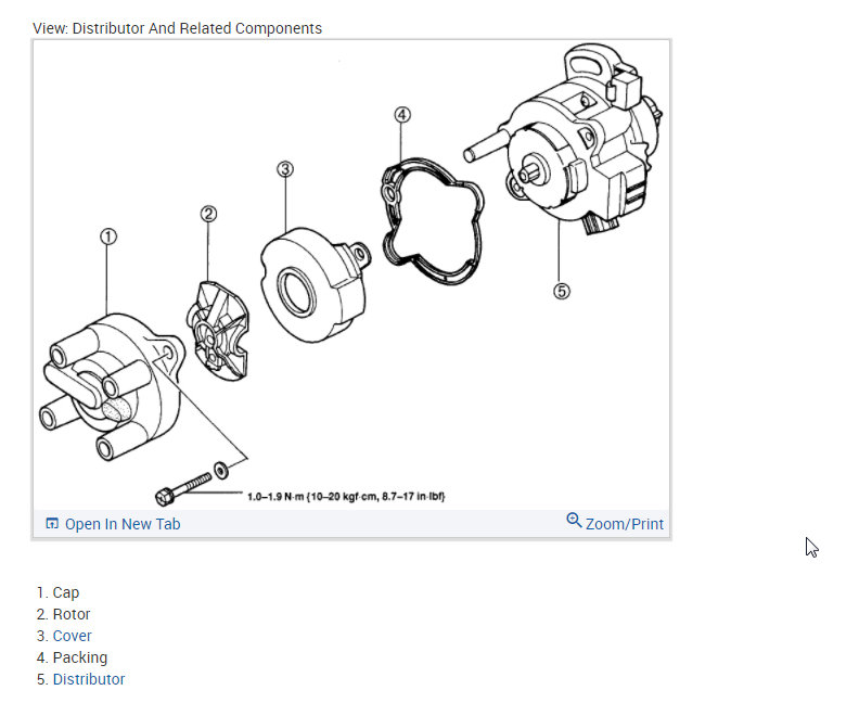

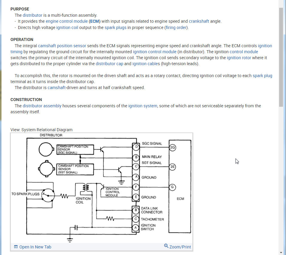

Can not locate where the crankshaft sensor is located. if possible send pictures and details of where it is located, what it is by or under. I have tried forums it was not where anyone has said. if possible show or say where each end goes. I believe connects to side of distributor. please help!
Sep 16, 2017 at 2:50 AM

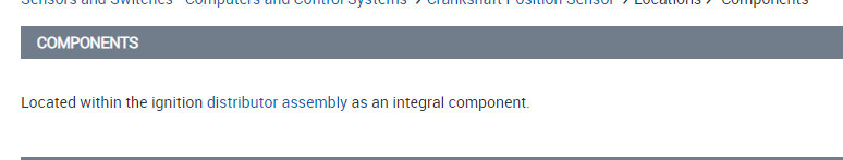

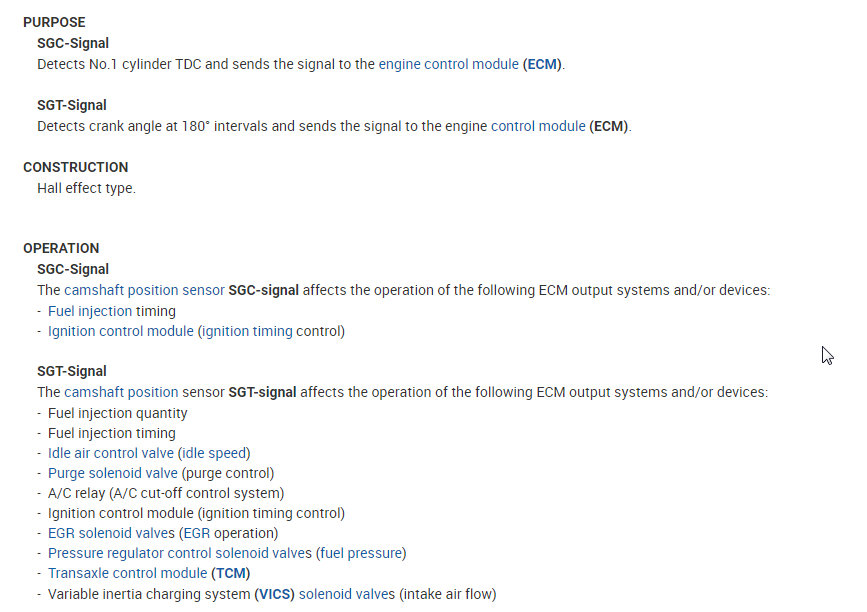

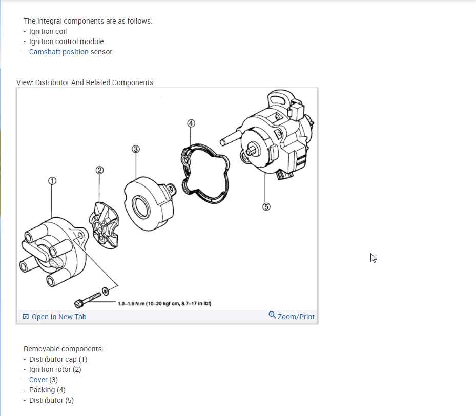

This is internal to the distributor. I am attaching the info that is needed to determine this and all the operation as to how things work.
