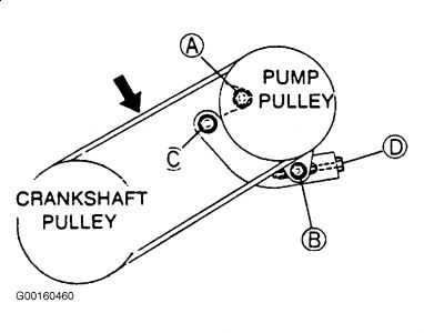

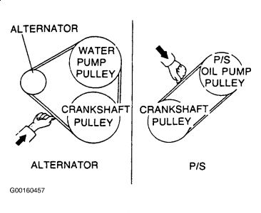

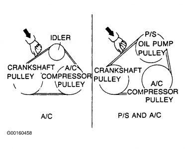

I was wondering how to put this belt on my MX-3, i have been looking for a way to loosen up the belt gears to put it on but i cant find one, is there a bolt i need to losen up and if so where is it ?

Is this on a 1.6L or 1.8L engine?
Jun 16, 2009 at 8:58 AM
SWMAN01
  • 9 POSTS
its a 1.6L 4cyl.
Jun 16, 2009 at 9:06 AM
BLUELIGHTNIN6
  • 16,542 POSTS
Okay. Loosen the bolts and nut and loosen the belt up by turning the adjusting bolt. Pics below should help you identify the correct nuts and bolts.
