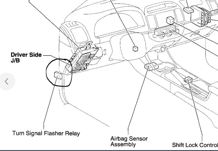

I've searched everywhere and am unable to find the location of the blinker relay. Can anyone help, please?

It is on the left side behind the kick panel. I attached a picture to help.
Let me know if this is what you needed or if you have other questions.

Thank you, JacobAndNickolas! This was a huge help. This panel seemed to only be held on with one hand-screw, so it was very easy to remove and replace. After removing it, the relay was very reachable, simply hanging from a set of wires.
