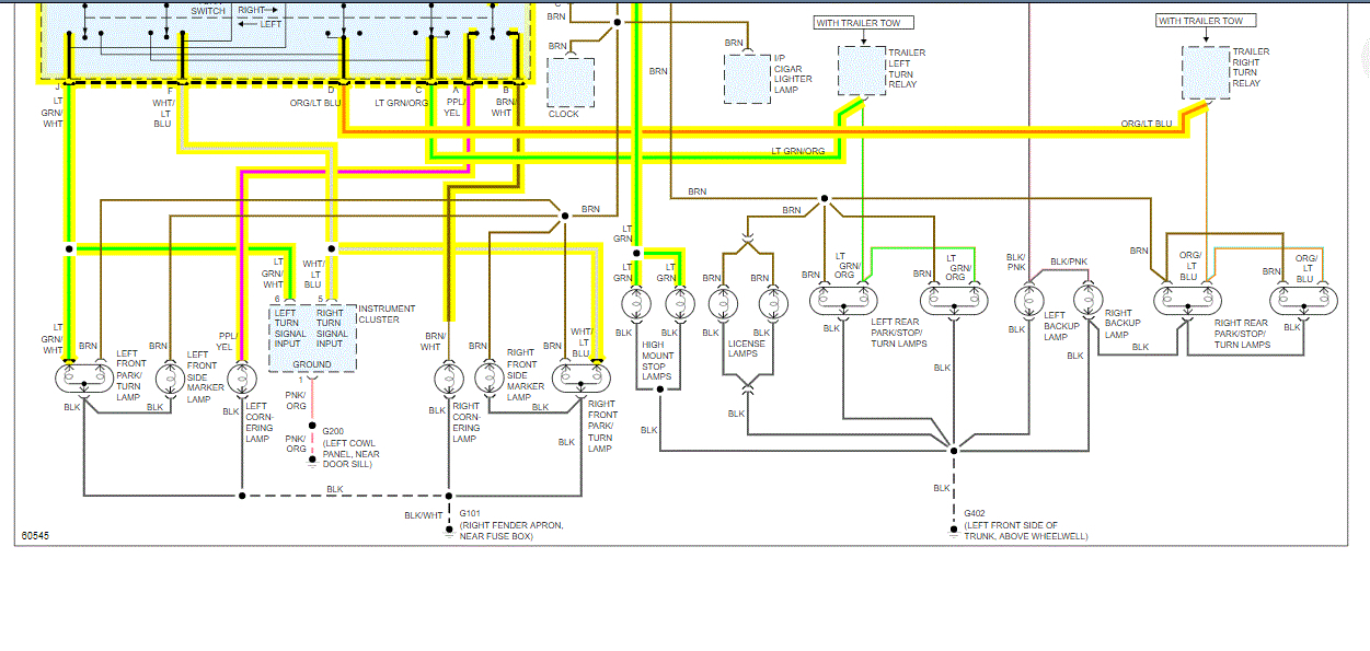

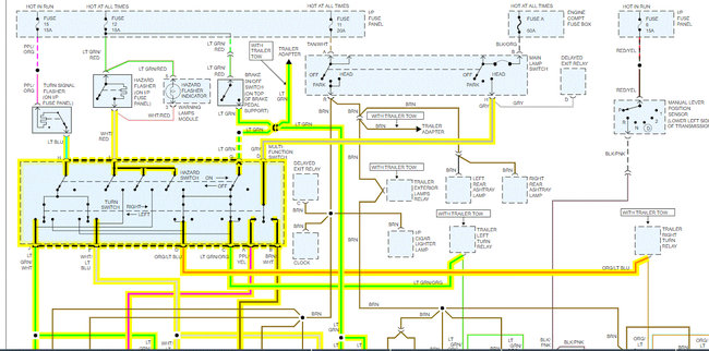

The car listed above is a Signature Series. car sitting in garage, horn started blowing constant and all exterior lights were on constant. Pulled horn fuse. Disconnected battery, re-connected and all exterior lights stay on. Does not have DRL, no auto dimming, but does have Auto Lamp delay lighting. That is off, headlight switch off. Charged battery fully, and problem went away. Reoccurs periodically. Lighting module? Headlight switch? Any ideas?

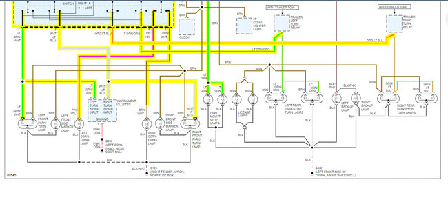

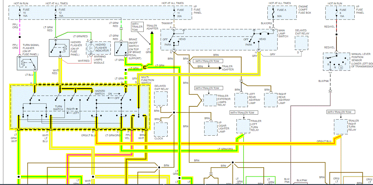

If you look at the diagram, the headlight switch sends a signal to the multi function switch and that sends the power to the all the lights.
To be sure, you need to test the gray wire to the switch for power when you turn off the lights. See if it has power when the lights are commanded off.
