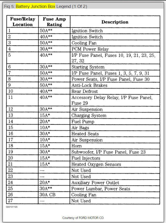

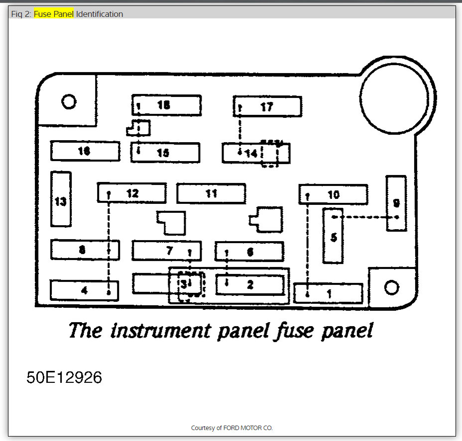

Have Headlights, have brake lights, however no tail lights or markers? Checked every fuse under dash. Check fuses and relays under hood. Looked for a fusible link under driver side door threshold. Looked for a trouble code with an OBD scanner, found nothing?

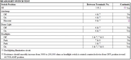

When the switch is disconnected from the wiring harness I should have all lights controlled by the switch on. Headlights are on, Lights On Bell is ringing no tail lights? I've tried auto position as well as every other position.I've switched the light switch with a known working switch, same make & model. Apparently, the switch is not the issue?
Please advise-Thanks

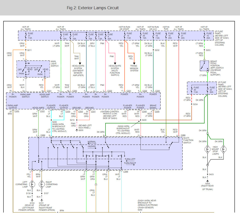

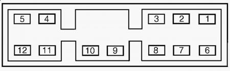

HEADLIGHT SWITCH Disconnect headlight switch harness connector. Continuity should be as specified between terminals with switch in specified position. See HEADLIGHT SWITCH TEST table. See Fig. 2 . If continuity is not as specified, replace headlight switch.

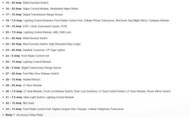

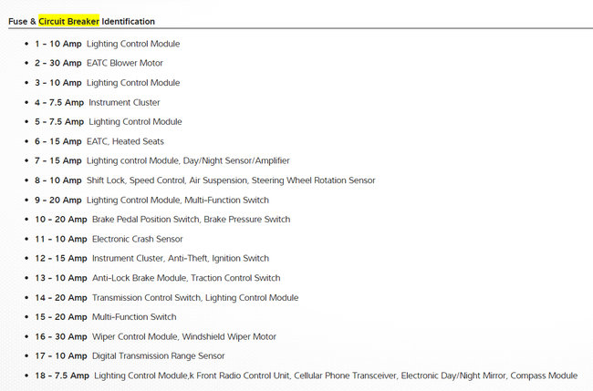

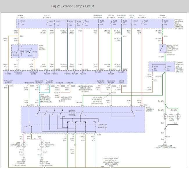

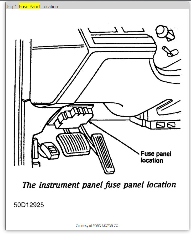

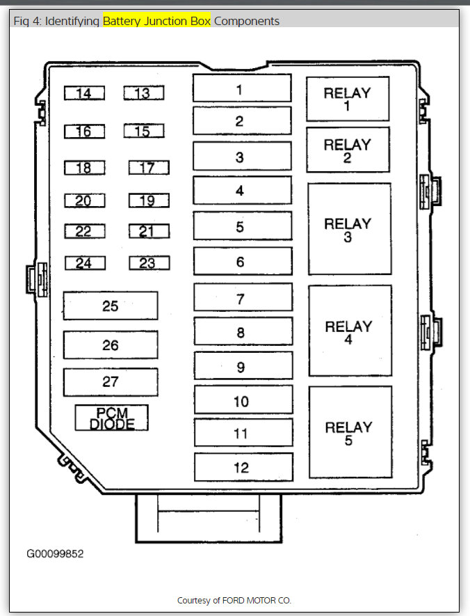

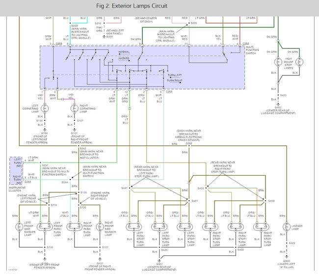

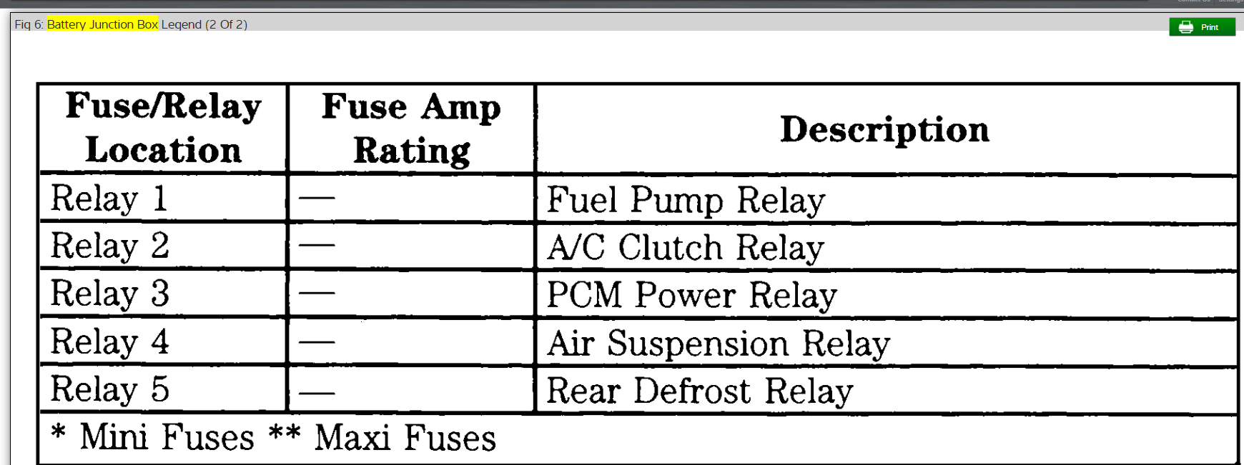

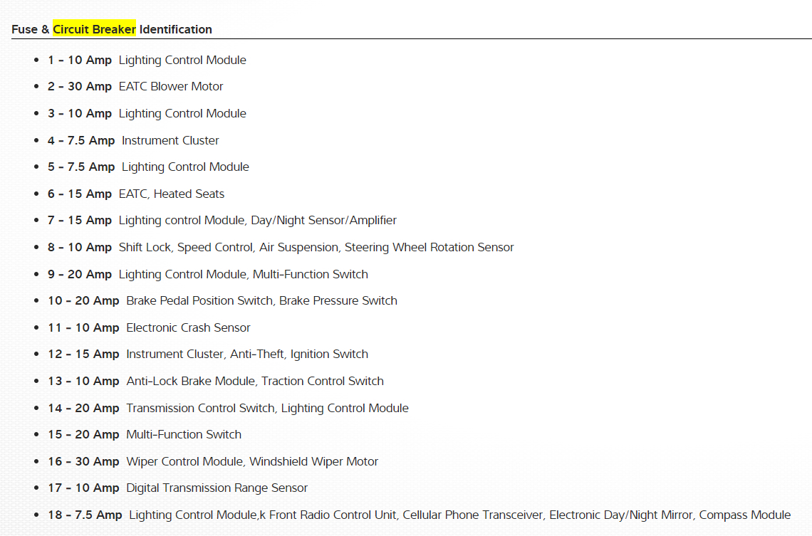

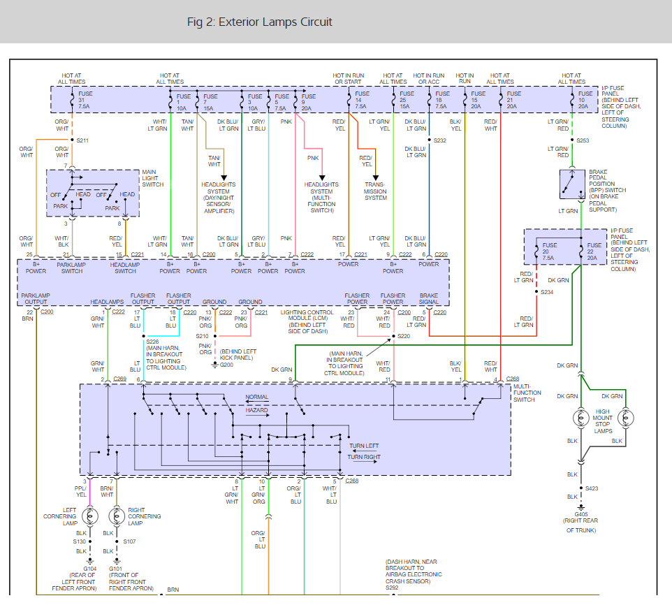

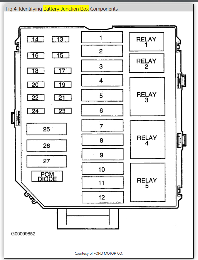

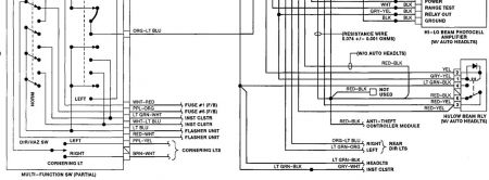

There is a handful of fuses that need to be checked, also there is a lighting module that can be out as well.
Trace the wires shown in the diagram use an ohm meter, it should read below 5 ohms, if it reads high or OL, it is shorted to ground, this should blow the fuse for the tail lights. Have you checked that?
Or a wire may have corrodes inside the plastic, and this will not blow the fuse. Don't forget to check the ground!
Here are some wiring diagrams for you.

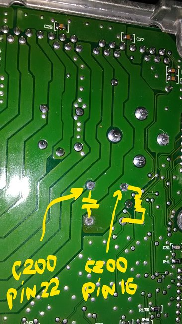

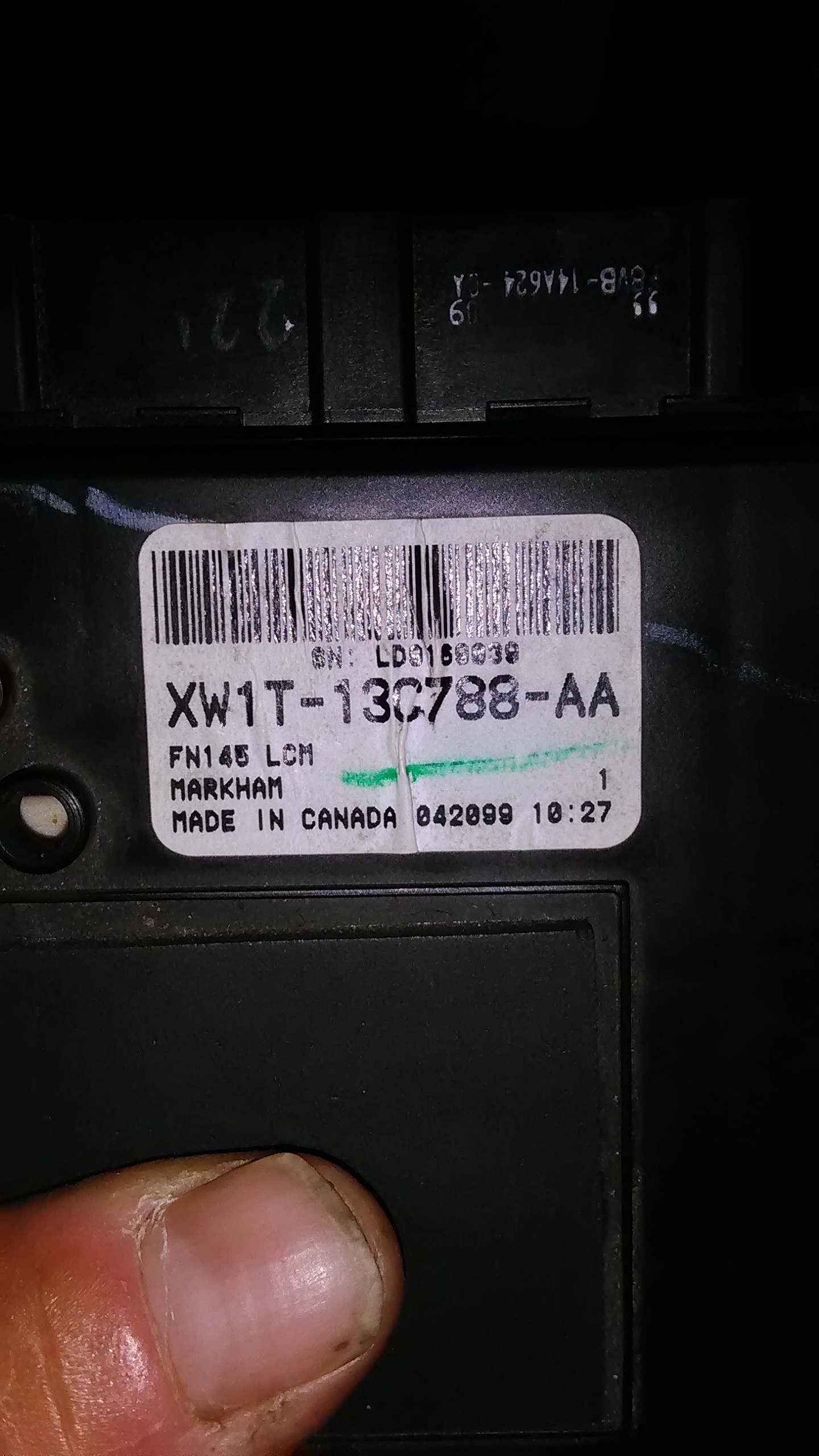

Old post, maybe someone is having the same problem, just want to add some more help. No tail lights or front markers on my 1999 Lincoln town car. I could hear the relay clicking, measured 2.8 Vdc on brown wire connector C200 pin 22. Opened case, cold solder and burnt pad bellow relay, re flow solder, got B+ on that pin. If you can not hear the relay, check for B+ at pin 21 on connector C221, if no voltage, problem from light switch to that connector. Check fuse 31 under the dash. Check pics. Remember to disconnect battery terminals before removal, clean the pad before soldering (it has some clear isolating epoxy on from factory, be gentle to not damage board traces and pads), use a good soldering iron and flux, clean with alcohol and cover with dielectric grease, you should be fine.

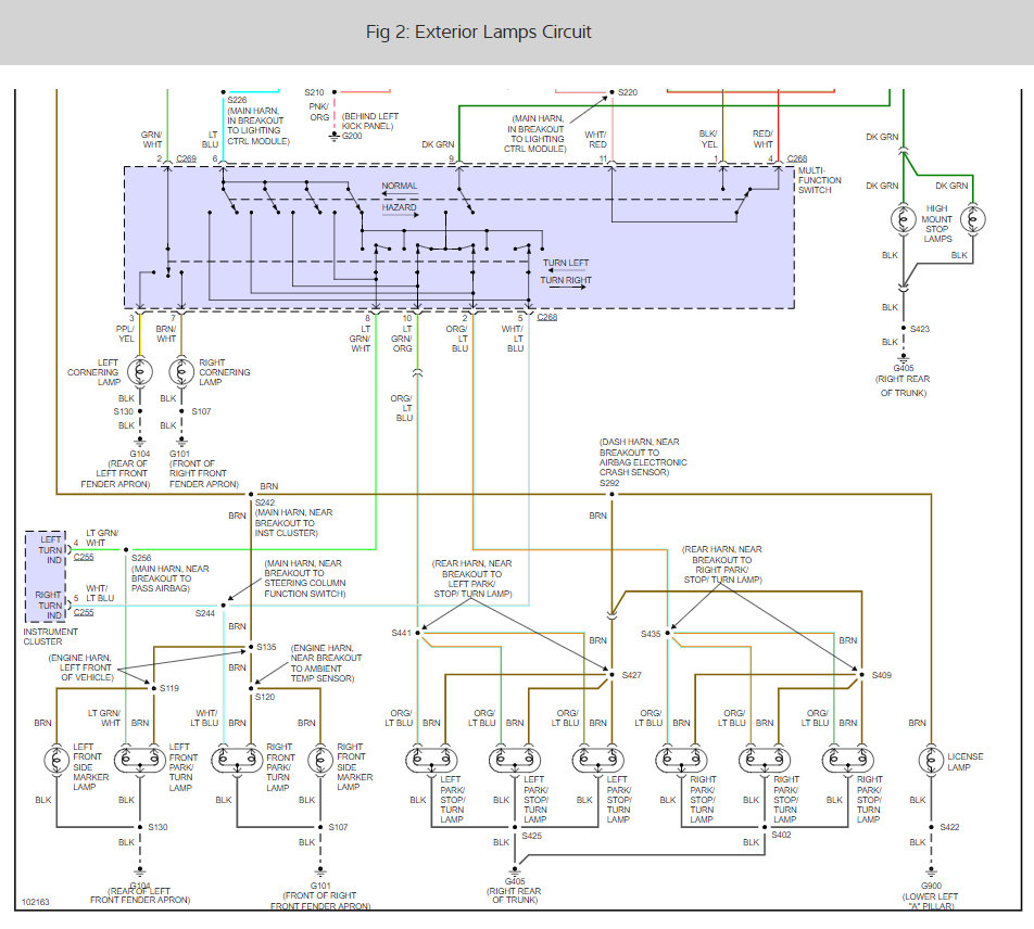

You'll need to check for power on the tan wire running to all of the taillights. This same circuit runs to all the parking lights also does the front parking light illuminate when switched on? Does the license plate light come on when head lights are switched on? If none of these lights come on and the bulbs are good (it unlikely all bulbs are bad) then the LCM light ting control module is faulty ( its located behind the dash in the center area).

O.K. have a wiring problem possible S292 a splice connection of a Brown wire that carrys volts to rear tail and license. Located dash harness Breakout to Air bag Electronic Sensor. Sensor under right side dash in front of air recirculation duct.

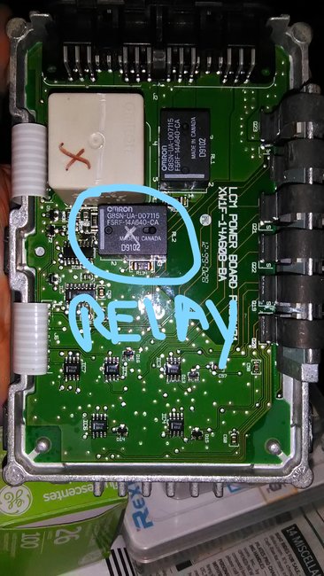

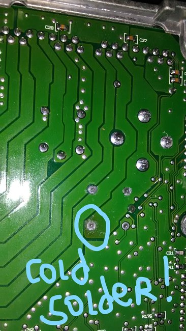

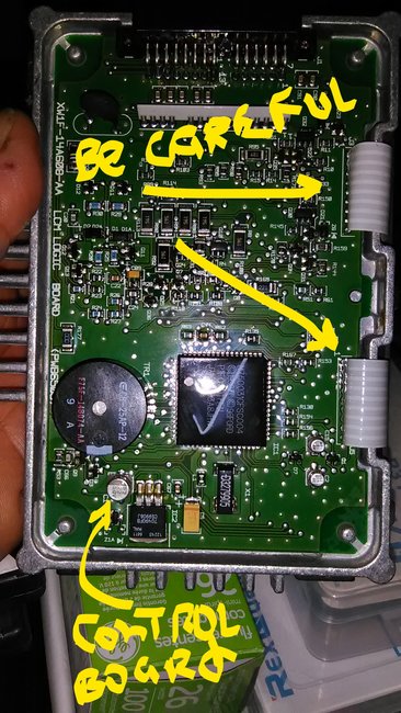

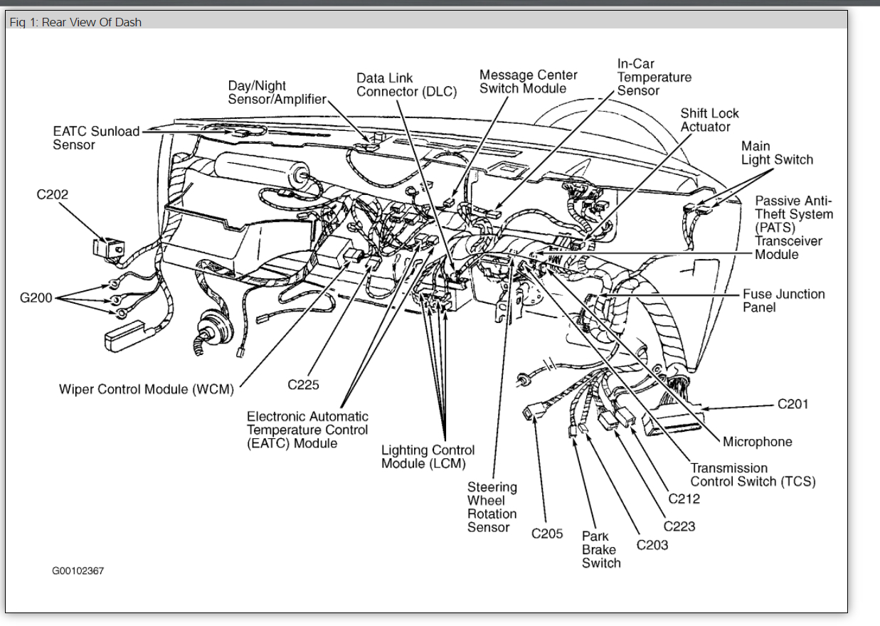

The exterior and interior lights are controlled by the LCM(lighting control module) and will have a "B" codes stored for the problem, You need to scan for B codes with a capable scan tool. This is your starting point.

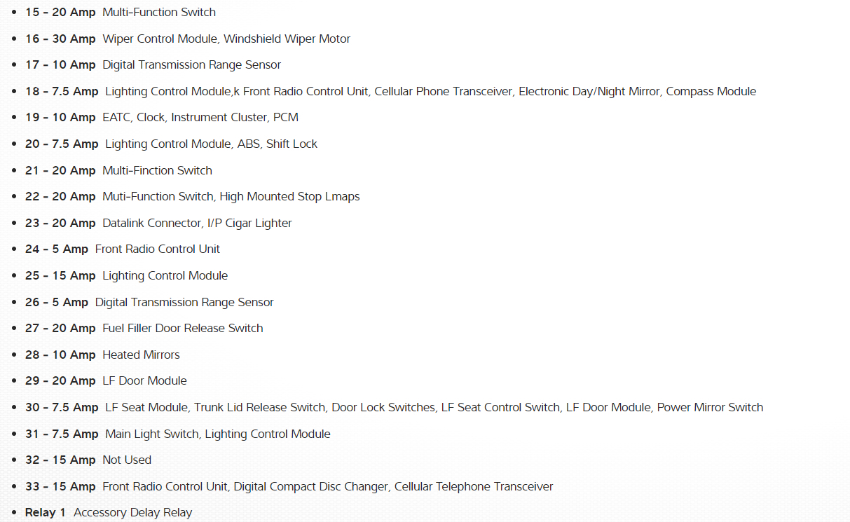

There is a bunch of fuses and a lighting module located under the dash that goes bad. Here is some guides and some wiring diagrams (below) so you can see what Im talking about and how to fix the problem. Also test through the switch as well.
and
Please let us know what happens so it will help others.
Cheers, Dave
Jun 1, 2020 at 6:30 AM (Merged)
DERRICK 01
Thanks you so much, it was the lighting control module that went out, got it fixed saved me a ton. Thanks 2Carpros kick ass wbesite

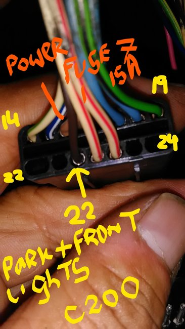

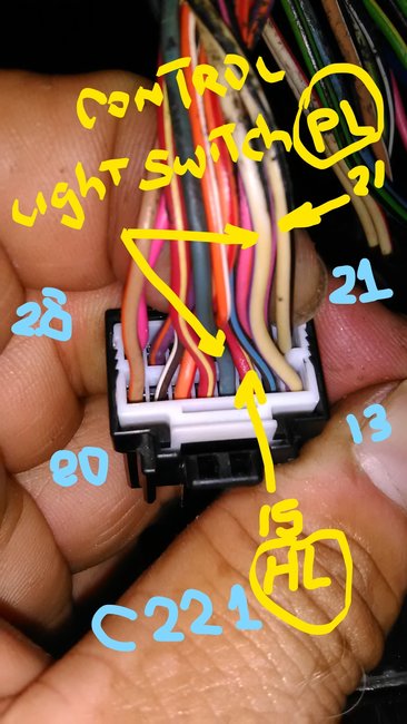

CARL RANEY
no exterior lites working, checked all bulbs, replaced head lite switch, still no exterior lites.While replacing head lite switch all running lites came on temporary . After relacing head lite switch only one front running lite works.Tested orange/black incomeing power wire ok.Pin H on lite switch has power when switch is on, no power when turned off. What do I do now? Please HELP me. Carl
Jun 1, 2020 at 6:31 AM (Merged)
BMRFIXIT
  • 19,053 POSTS

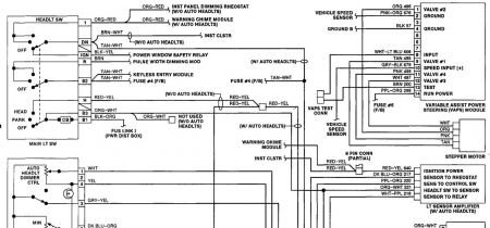

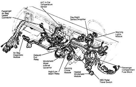

Crown Victoria, Grand Marquis & Town Car Potentiometer is attached to headlight switch. Unplug potentiometer connector. Connect self-powered test light between connector circuit No. 57 (Black wire) and switch bracket. If continuity does not exist, replace potentiometer. If continuity exists, go to next step. Continuity should exist between connector circuits No. 220 (Dark Blue/Orange wire) and 57 (Black wire) after rotating autolamp control switch knob from OFF to ON position. Measure resistance between circuits No. 217 (Dark Blue/Orange wire) and No. 57 (Black wire) while rotating switch from OFF position to maximum time delay. Resistance should gradually increase from 2500-4500 ohms (OFF position) to 140,000-260,000 ohms (maximum time delay). If test results are not as specified, replace potentiometer assembly.
https://images.2carpros.com/forum/automotive_pictures/99387_lin_1.jpg
Unplug connector at autolamp relay. Connect test light between ground and Red/Yellow wire. Voltage should be present with switch in ON position. If voltage does not exist, repair Red/Yellow wire to headlight switch and to high-low beam relay
https://images.2carpros.com/forum/automotive_pictures/99387_li_1.jpg

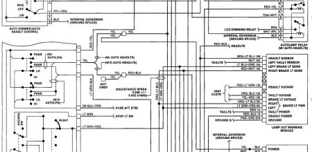

BMRFIXIT
  • 19,053 POSTS
https://images.2carpros.com/forum/automotive_pictures/99387_link_1.jpg
https://images.2carpros.com/forum/automotive_pictures/99387_link1_1.jpg
https://images.2carpros.com/forum/automotive_pictures/99387_link2_1.jpg

try looking Behind left side of instrument panel, above steering column
If cannot locate the short replacing the wire would be the easiest to do
