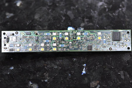

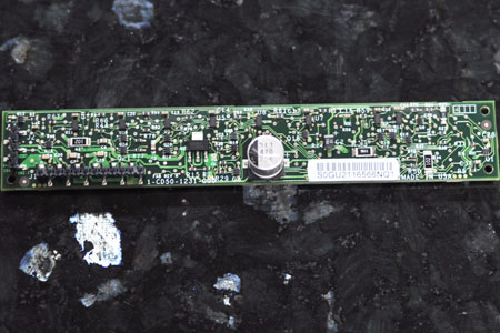

Here are some pictures... The first is The bottom of the board.
https://images.2carpros.com/forum/automotive_pictures/162390_bottomboard_1.jpg
The second is the top of the board.
https://images.2carpros.com/forum/automotive_pictures/162390_topboard_1.jpg

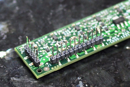

The third is the pins for the connectors.
https://images.2carpros.com/forum/automotive_pictures/162390_pins_1.jpg

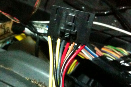

The fourth is the first set of wires with connector still attatched. 8 wires total.
https://images.2carpros.com/forum/automotive_pictures/162390_wires1_1.jpg

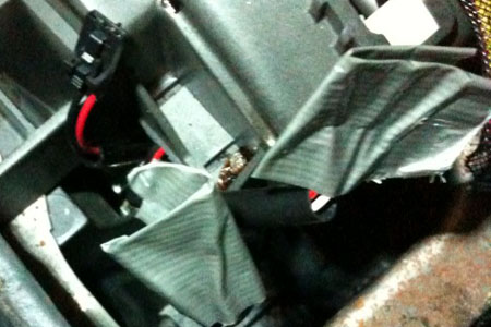

The last is the wires that were detatched from their connector. On the left is a three pin connector but it only had two wires. I don't know if that's the order they go in. On the bottom there is a tube with a white wire and a black wire and another tube with a black, white, and red wire. These seem to go to the brake switch solenoid. They've been taped so they don't short.
https://images.2carpros.com/forum/automotive_pictures/162390_wires2_1.jpg
These last five wires go on a single connector to the pins on the left side of picture number 3. the connector that is still intact plugs into the board with the red wire on the right of the harness to the leftmost pin on the long set of pins when the piece is placed correctly.

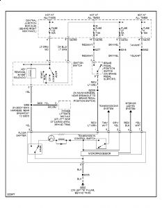

The only wiring diagram for the shift lock system my software has is this one
https://images.2carpros.com/forum/automotive_pictures/1639_lincoln_3.jpg

You think you could mail it to me? the small print isnt very clear. Thanks

I dug a little deeper. Maybe this will help. The red and black wire on the left side go down into the vehicle (transmissiin I assume). The black and white on the bottom go to the brack lock solenoid. An the red white and black wires go to a switch on the shifter casibg that detects whether the shifter is in tge D6 or D4 position (D6 the switch is closed, D4 the switch is open). So I assume that is to a) turn on the indicator on the board and b) send the transmission the signal tu turn overdrive off. Unforunayely just looking at the circuit board doesnt help me much. Maybe i should go trial and error. (I know that when i first tried that it blew the number 5 fuse)

Having issue swith my email right now, can receive but cant send, I will get all the diagrams I can find for the trans range selector and the shift lock system when I get home. Dont go trial and error just yet.lol

I have been looking, but they dont alwyas show every connector in the software.Did you get the one I sent for the shift lock? I will send you the interior lights diagram, and the ones for 4wd and 2wd transmissions.My software breaks the wiring down into systems instead of just the entire schematic that I can search through, so it omits some things that are needed from time to time
