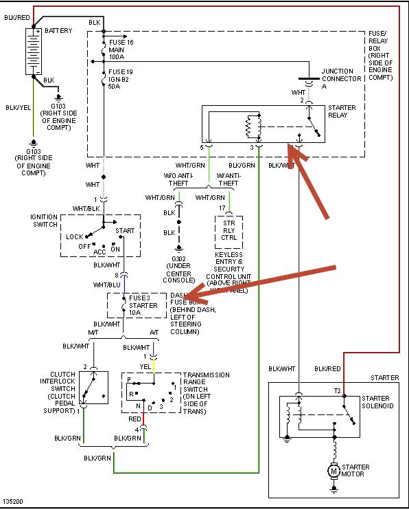

I have a 2000 Honda Passport. Whenever I crank it all my lights come on but the car won't crank/turn over. I've had the car for a little over a year & this makes the 3rd time this has happened. In the past, all I had to do was shove the car in park & it would start but this time that little trick isn't working and hasn't worked in about 2wks. Please help me!

check the things I've pointed out in pic as well as battery condition including load test. you can switch a like relay to se if that is the problem. if still not starting if you can get an assistant try to start then hit he body of the starter with a hammer and if it starts you need a starter.

Thank you for responding! & what pic?

looks like I forg ot it sorry...here it is........
