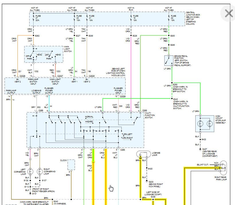

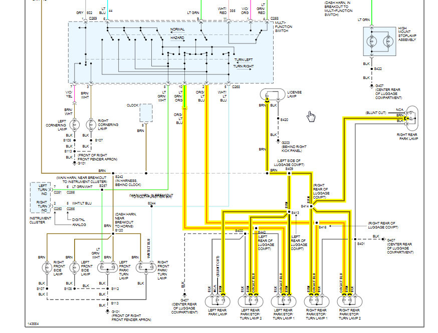

Headlights are on but i have no tail lights. The brake lights works and no turn flasher when i turn.
Jan 8, 2021 at 3:48 AM
More then likely this is the multi function switch but I included the wiring diagram to confirm this. We just need to turn them on and then test voltage on each coming out of the switch. However, I am pretty sure this is the issue because the brake lights doesn't pass through the switch. That has a separate circuit.

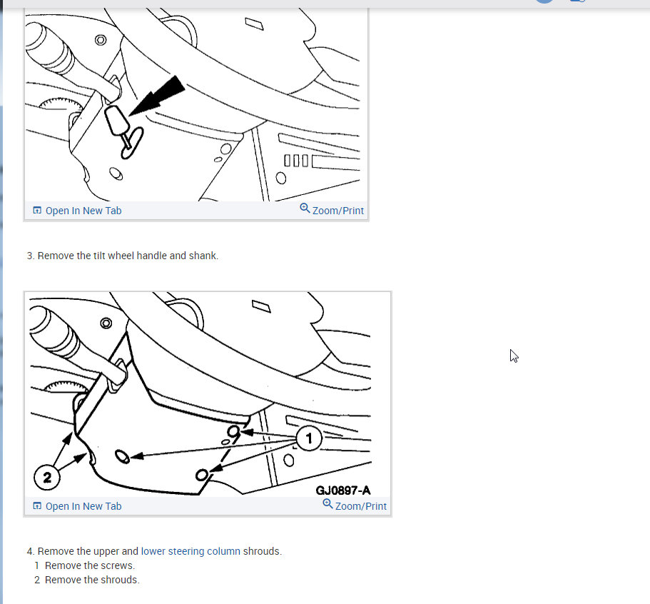

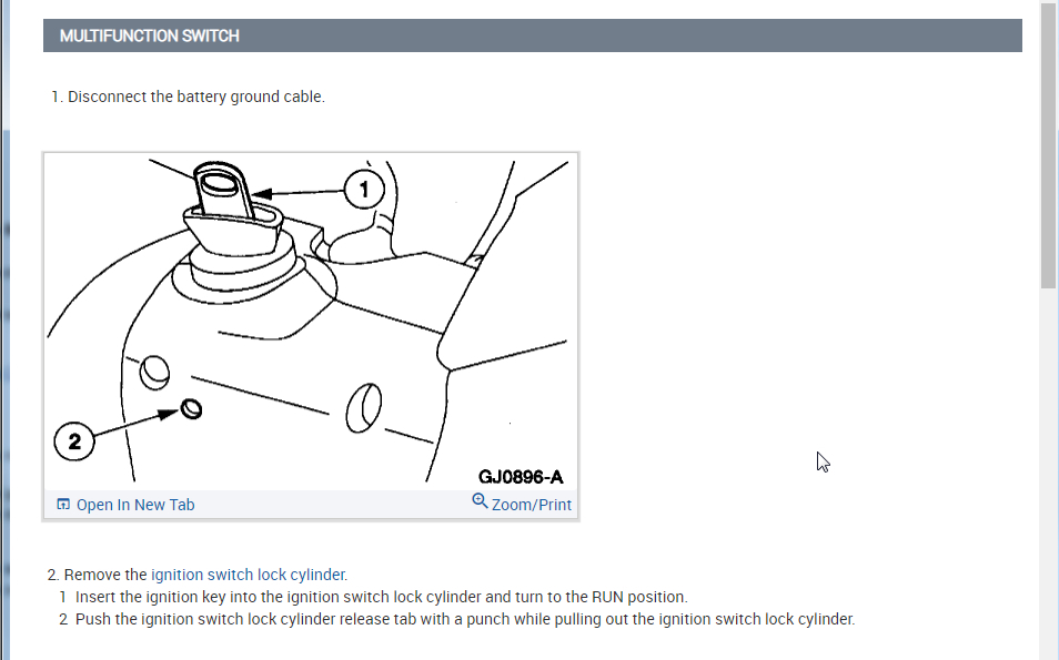

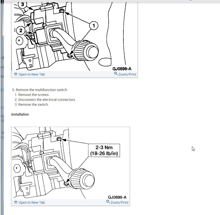

Also, I included the process on how to replace the switch if this proves out.
