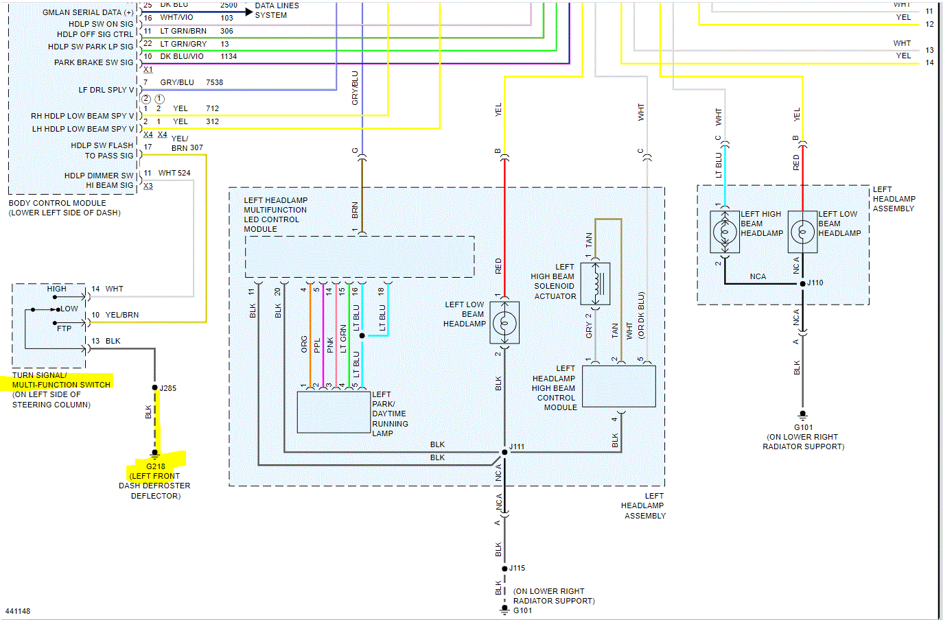

I just looked through all the schematics related to the headlamps, horn, and exterior lighting. The only thing they all have in common is the body control module. If you are certain that all fuses are good and are receiving power, there are two things I would check.

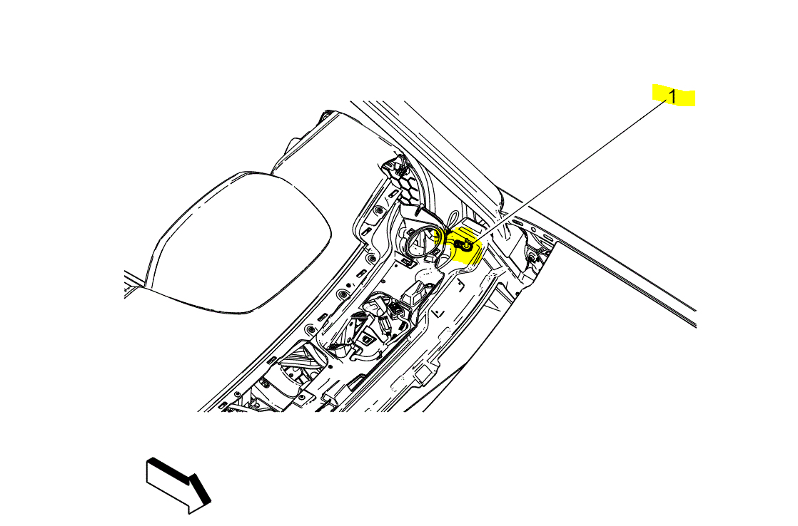

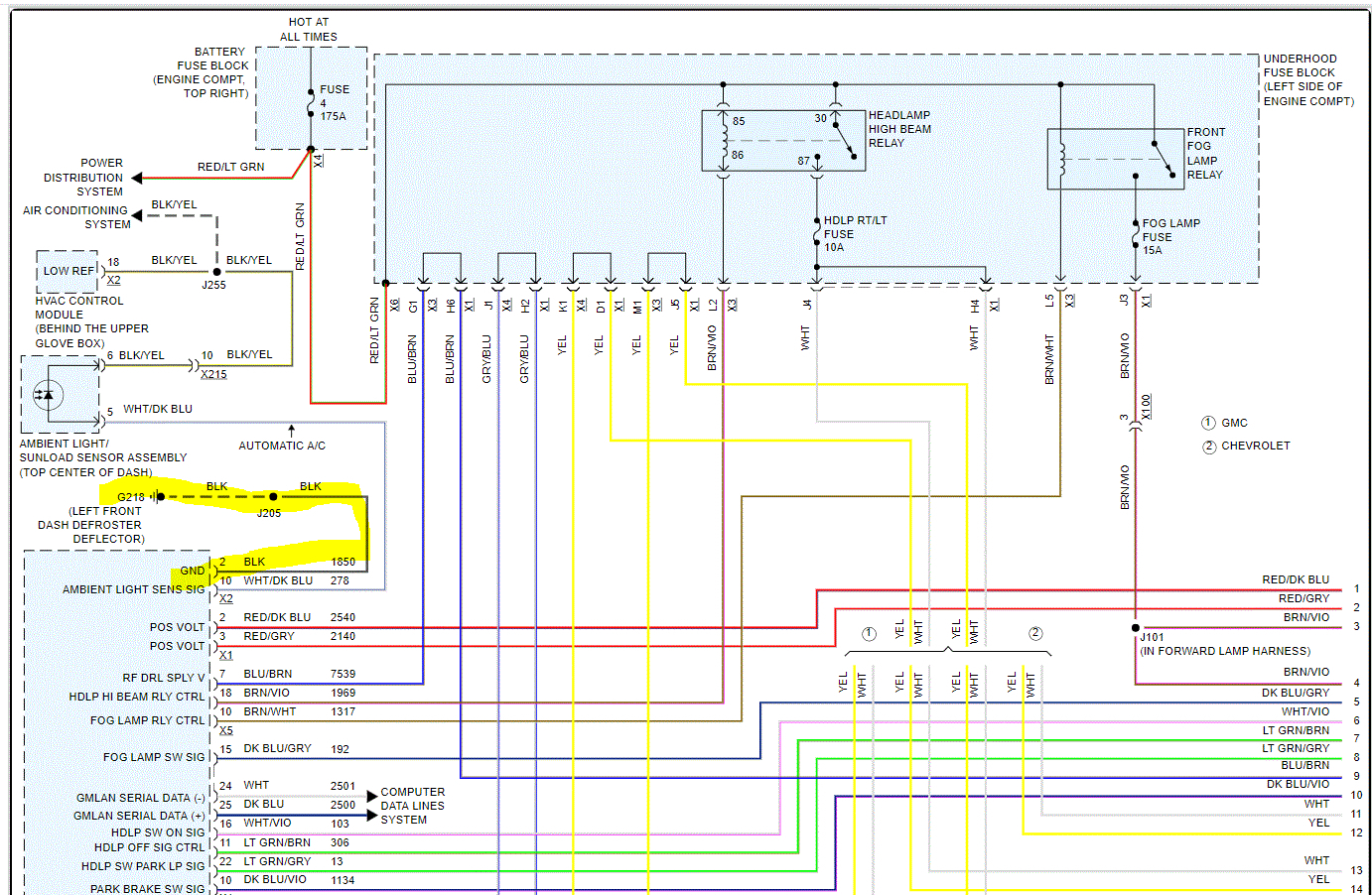

First, the body control module ground is located under the dash on the left side. See pics 1 and 2 below. Note that the ground is for the BCM and includes the lights you are having trouble with. Check that ground to confirm it hasn't been damaged. The last pic below shows its location.

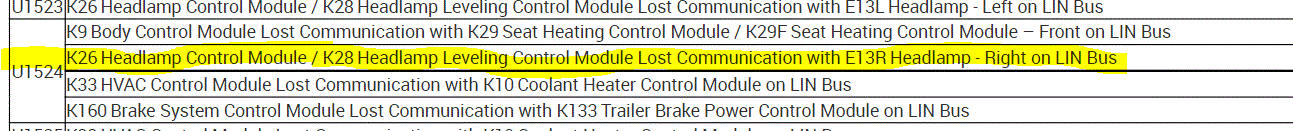

Joe, I checked the ground and the fuses everything is good. I am going to send a copy of the codes that came up and after it was cleared the codes with a star next to it are the ones that reappeared immediately. Thank you for your help.

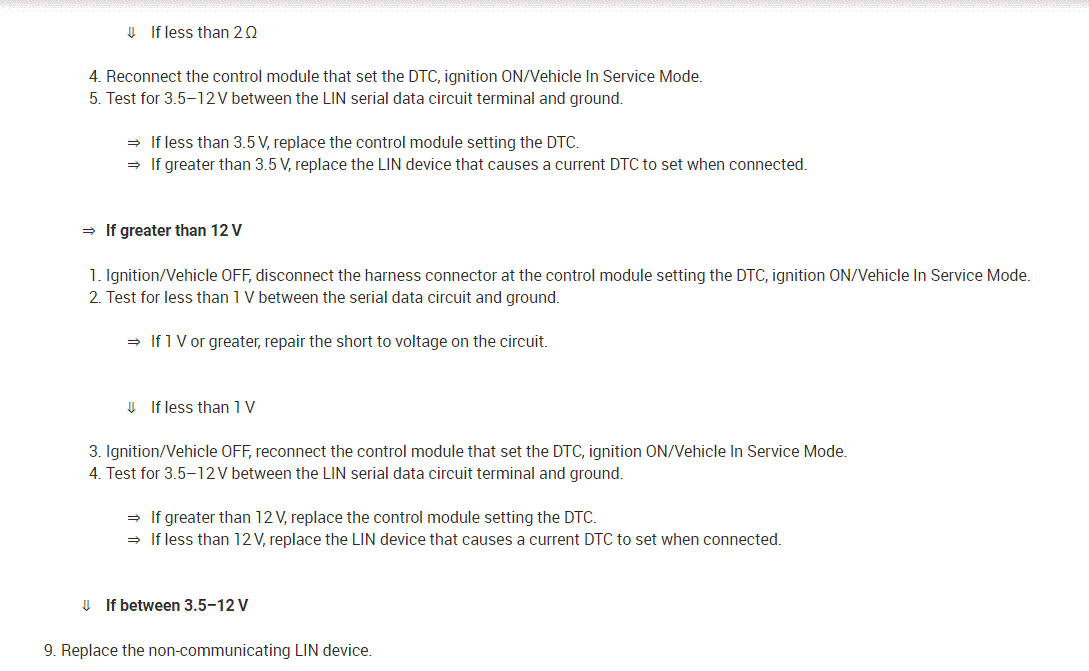

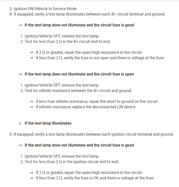

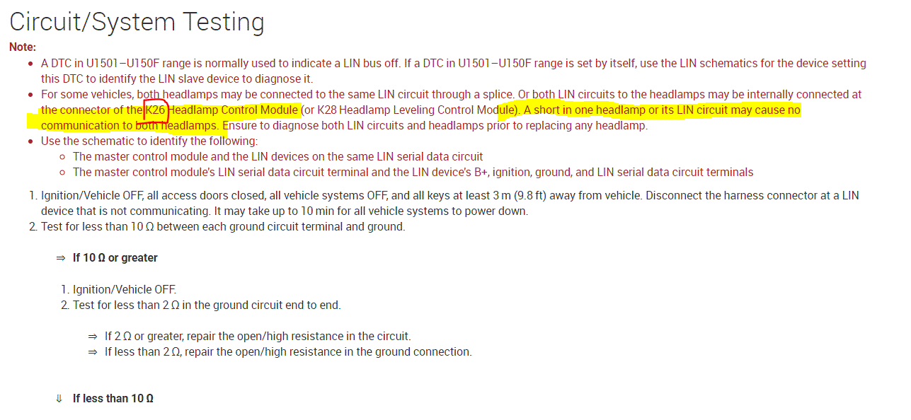

Looking at the list of codes, the first one that got my attention was the U1524 (can lost communication). The Local Interconnect Network (LIN) Bus consists of two wires between the body control module and the headlamp control module. This is where we need to start.
The headlamp control module is in the headlamp assembly. With this code, the focus is between the BCM and the right headlamp control module.

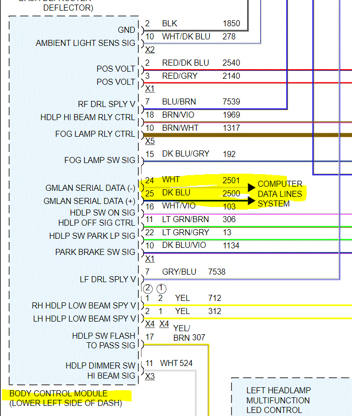

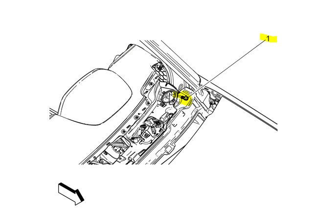

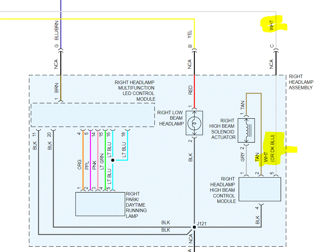

If you look below, pic 1 describes the code you provided. Pic 2 shows the BCM and the two wires related to the CAN, dark blue and white. I need you to start by locating those two wires and inspect them for damage or corrosion.

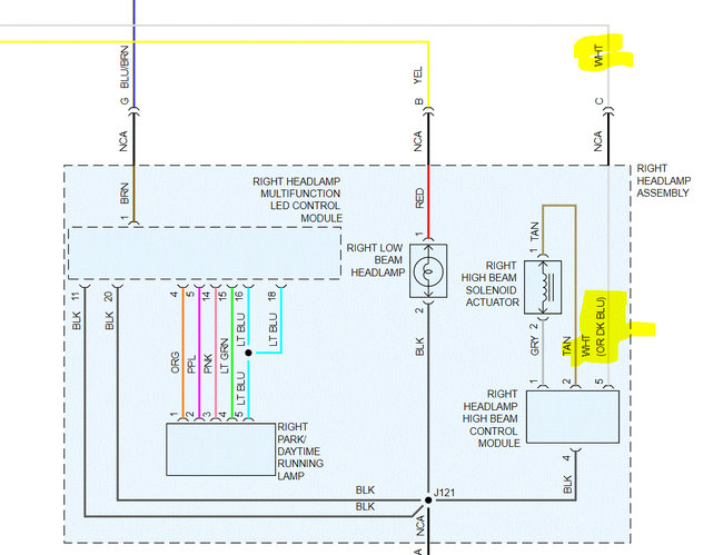

Next, go to the right front headlamp assembly (passenger side) and locate one of the two wires, either dark blue or white. In the schematic, it indicates it could be either-or. Inspect that wire for damage, corrosion, or a weak connection. See pic 3
If that looks good, then you need to check the wire for continuity to make sure there is no open in it.
Now, the code seems to focus on the B+ which is the dark blue wire. With that, I suspect the wire at the right headlamp will be dark blue. That will need to be determined.

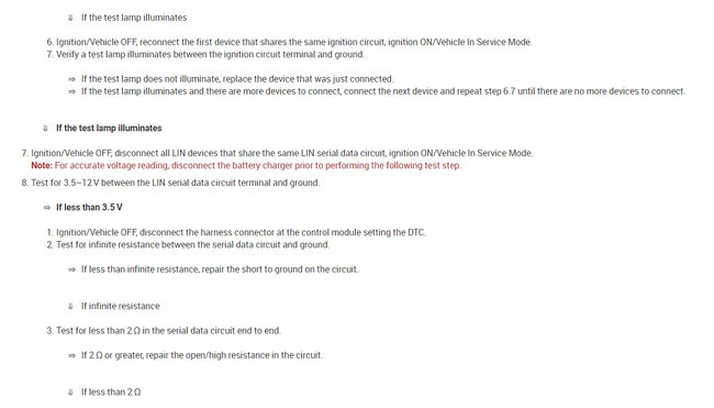

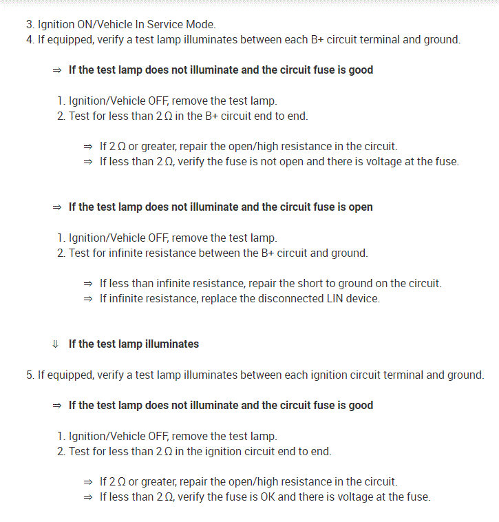

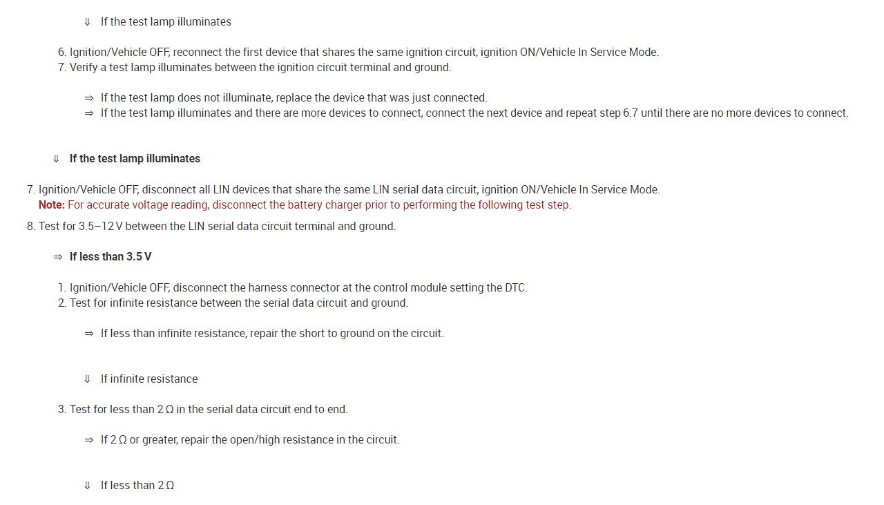

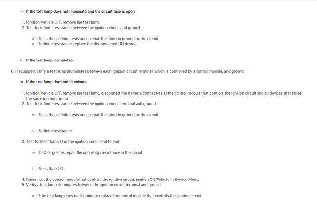

If everything checks good, I attached diagnostics for you to follow starting with pic 4.
