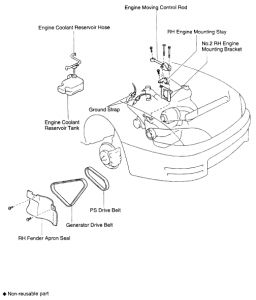

Planning to change the timmung belt myself. Have had replaced twice before but think I can do ir myself. Any special tips you can give. A picture of the process would help. Any special tools?

REMOVAL AND INSPECTION
https://images.2carpros.com/forum/automotive_pictures/12900_tb1_3.jpg
https://images.2carpros.com/forum/automotive_pictures/12900_tb2_3.jpg
TIMING BELT COMPONENTS FOR REMOVAL TIMING BELT REMOVAL 1.Remove engine coolant radiator reservoir 2.Remove right hand front wheel 3.Remove right hand fender apron seal 4.Remove generator drive belt
https://images.2carpros.com/forum/automotive_pictures/12900_tb3_1.gif
5.Remove power steering pump drive belt *Loosen the 2 bolts. and remove the drive belt.
https://images.2carpros.com/forum/automotive_pictures/12900_tb4_1.gif
6.Disconnect ground strap connectors 7.Remove right hand engine mounting stay, engine moving control rod and no.2 right hand engine mounting bracket 8.Remove no.2 generator bracket (a) Loosen the generator pivot bolt. (b) Remove the nut and bracket. 9.Remove crankshaft pulley (a) Using SST, remove the pulley bolt. SST 09213-54015(91651 -60855). 09330-00021

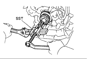

(b) Using SST. remove the pulley. SST 09950-50010(09951 -05010,09952-05010. 09953-0501 0.09953-05020, 09954-05020)

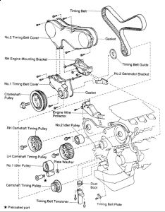

10.Remove no.1 timing belt cover Remove the 4 bolts and timing belt cover. 11.Remove timing belt guide 12.Remove no.2 timing belt cover
https://images.2carpros.com/forum/automotive_pictures/12900_tb7_1.gif
(a) Remove the bolt, and disconnect the engine wire protector from the No.3 timing belt cover. (b) Disconnect the engine wire protector clamp from the No.3 timing belt cover. (c) Remove the 5 bolts and timing belt cover. 13.Remove engine right hand mounting bracket Remove the 2 bolts, nut and mounting bracket.

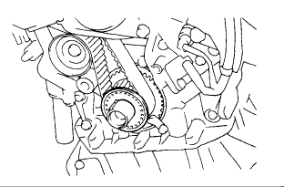

14.Set no.1 cylinder to TDC/compression (a) Temporarily install the crankshaft pulley bolt to the crankshaft. (b) Turn the crankshaft, and align the timing marks of the crankshaft timing pulley and oil pump body.
https://images.2carpros.com/forum/automotive_pictures/12900_tb9_1.gif
NOTICE: Always turn the crankshaft clockwise. (c) Check that timing marks of the camshaft timing pulleys and No.3 timing belt cover are aligned. If not, turn the crankshaft 1 revolution (3600).
https://images.2carpros.com/forum/automotive_pictures/12900_tb10_1.gif
(d) Remove the crankshaft pulley bolt. 15.If reusing timing belt, check installation marks on timing belt (a) Check that there are 3 installation marks and front mark on the timing belt.

Alternately loosen the 2 bolts, and remove them, the tensioner and dust boot. 17.Remove timing belt 18.Remove camshaft timing pulleys

(a) Remove the bolt and timing belt plate. (b) Using SST, remove the crankshaft timing pulley. SST 09950-50010(09951 -05010,09952-05010, 09953-05010, 09953-05020, 09954-05010) NOTE: Do not scratch the sensor part of the crankshaft timing pulley. TIMING BELT INSPECTION 1.Inspect timing belt NOTE: *Do not bend, twist or turn the timing belt inside out. *Do not allow the timing belt to come into contact with oil, water or steam.

Protrusion: 10.0 - 10.8 mm (0.394 - 0.425 in.) If the protrusion is not as specified, replace the tensioner. TIMING BELT INSTALLATION: 1.Install crankshaft timing pulley
https://images.2carpros.com/forum/automotive_pictures/12900_TBELT1_1.gif
(a) Align the pulley set key with the key groove of the timing pulley, and slide on the timing pulley. (b) Install the timing pulley, facing the sensor side inward. NOTE: Do not scratch the sensor part of the crankshaft timing pulley. (c) Install the timing belt plate with the bolt. Torque: 8 N.m (80 kgf.cm, 69 in.lb) 2.Install no.1 idler pulley Adhesive: Part No.08833-00080, THREE BOND 1344, LOCTITE 242 or equivalent (a) Using a 10 mm hexagon wrench, install the plate washer and idler pulley with the pivot bolt.
https://images.2carpros.com/forum/automotive_pictures/12900_tbelt2_1.gif
Torque: 34 N.m (350 kgf.cm, 25 ft.lb) (b) Check that the pulley bracket moves smoothly. 3.Install no.2 idler pulley (a) Install the idler pulley with the bolt. Torque: 43 N.m (440 kgf.cm, 32 ft.lb) (b) Check that the idler pulley moves smoothly.
