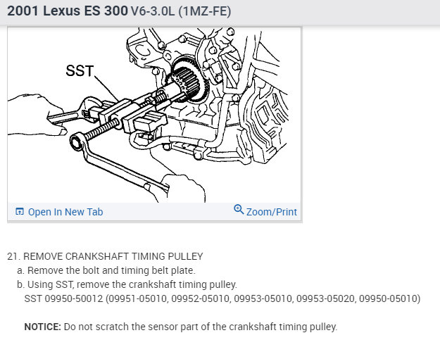

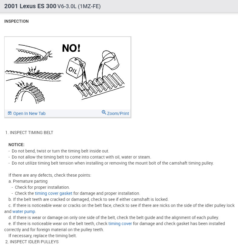

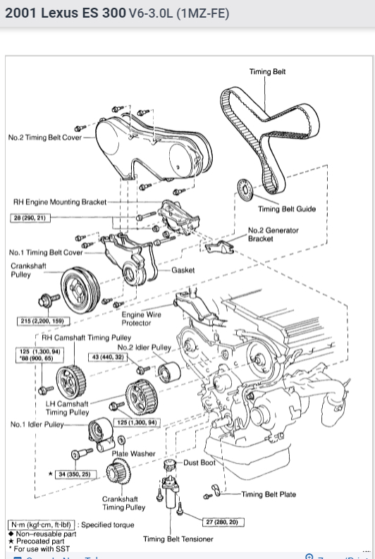

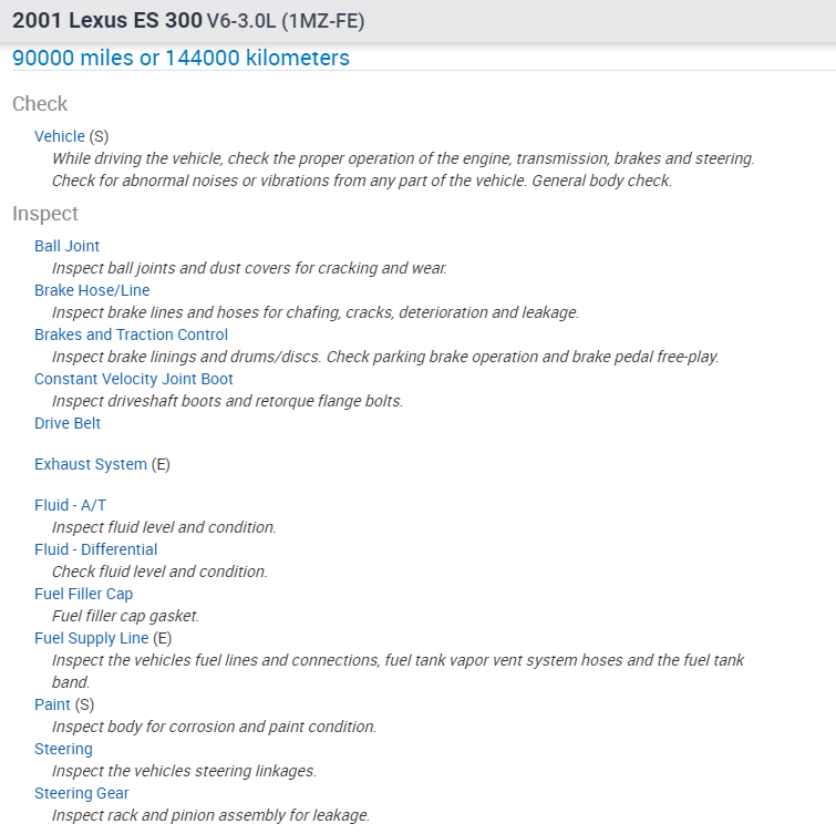

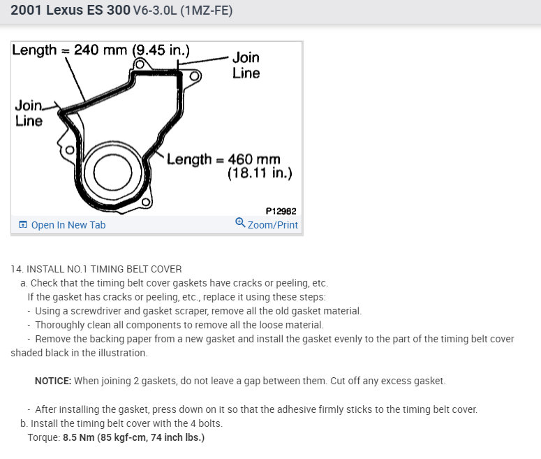

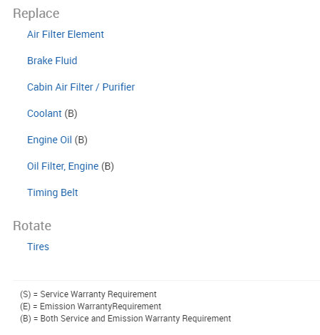

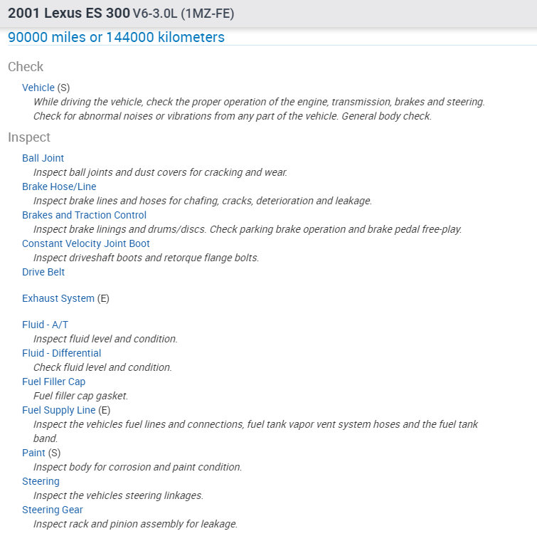

just purchased vehicle and wonder if I should replace belt/chain.
Mar 29, 2009 at 11:06 AM
SQM
Experienced Mechanic
6,383 POSTS

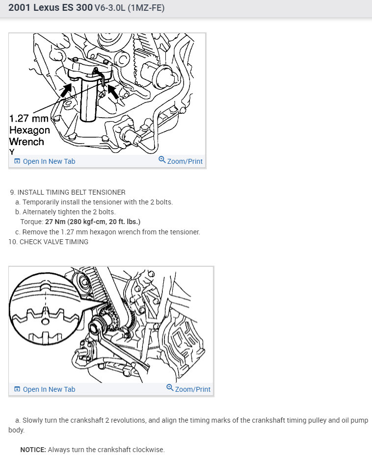

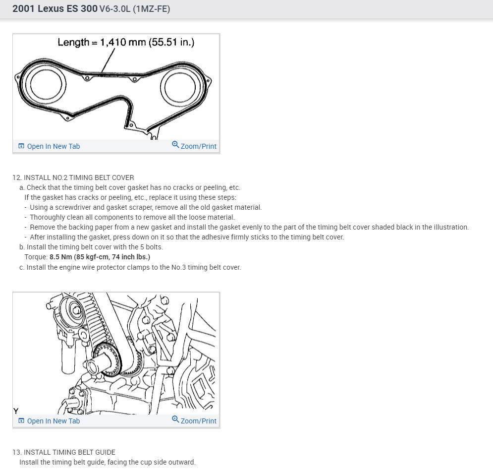

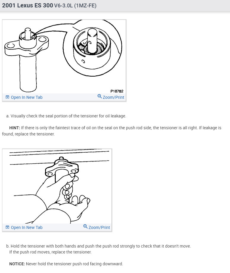

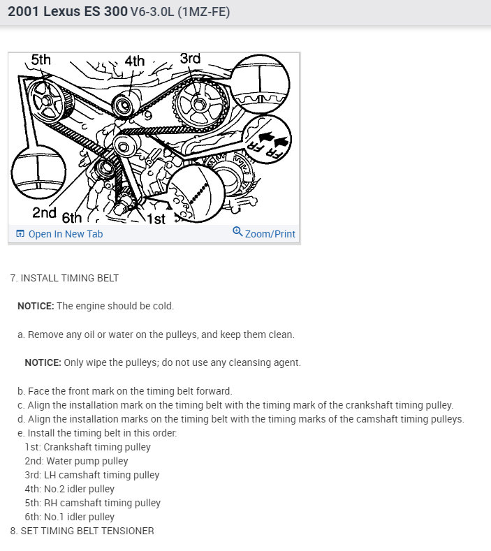

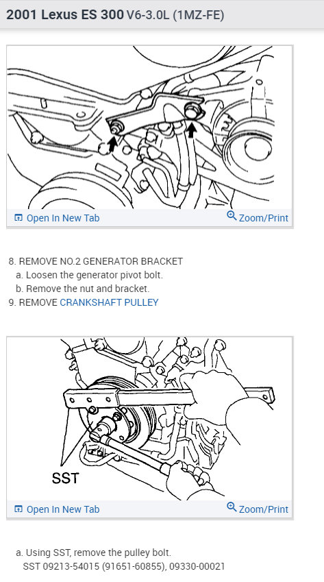

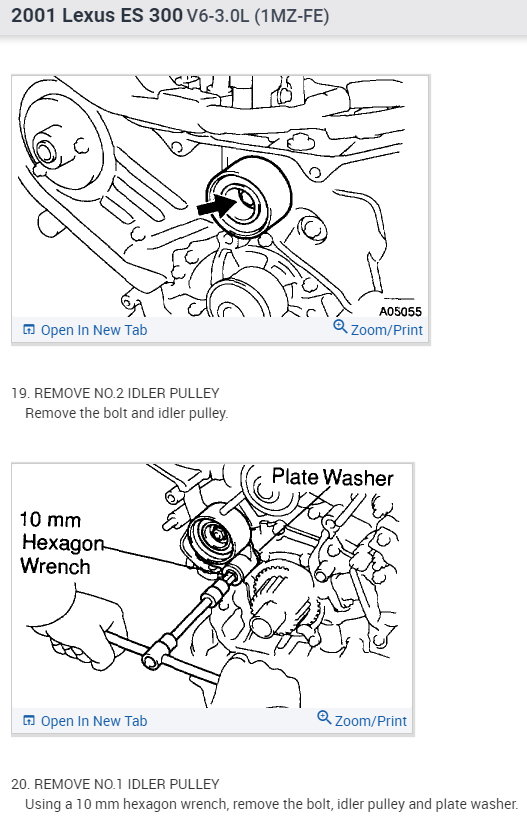

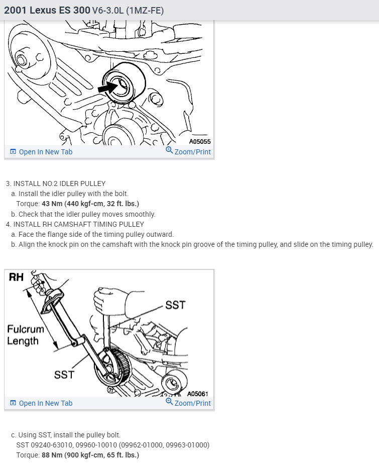

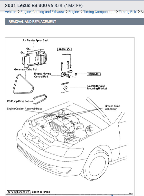

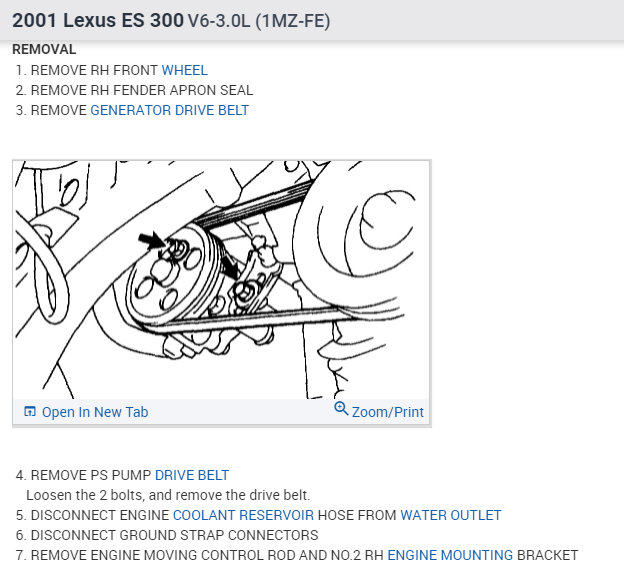

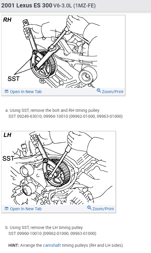

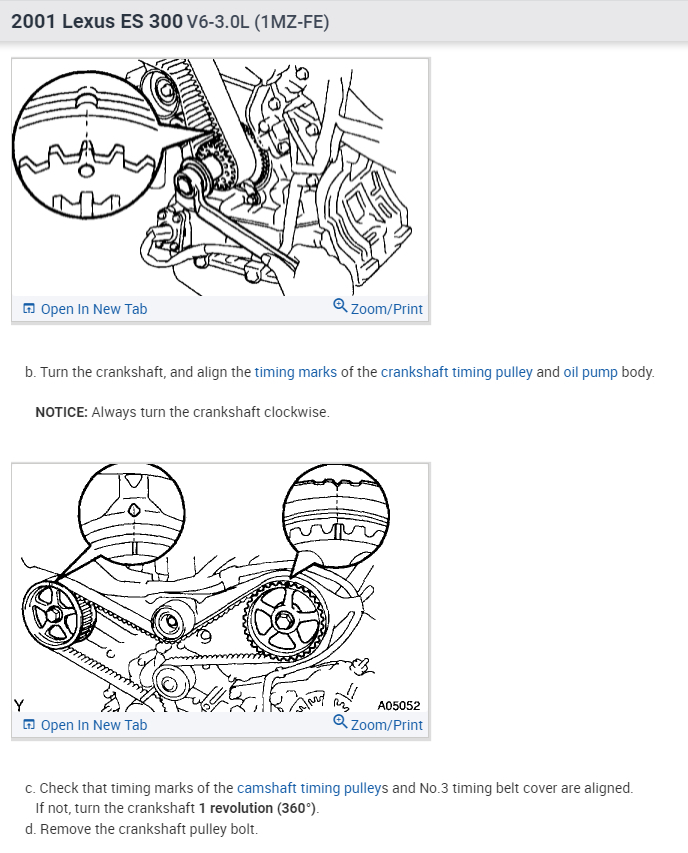

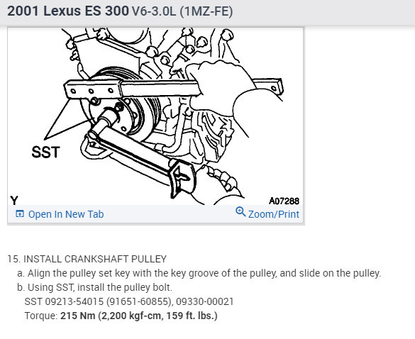

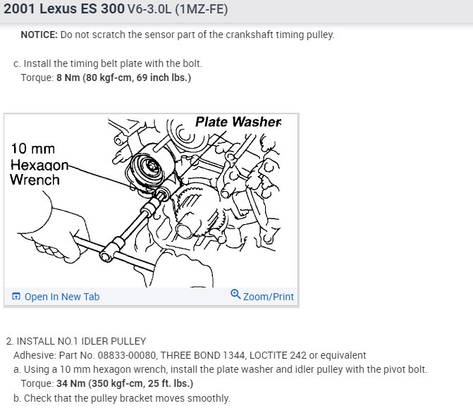

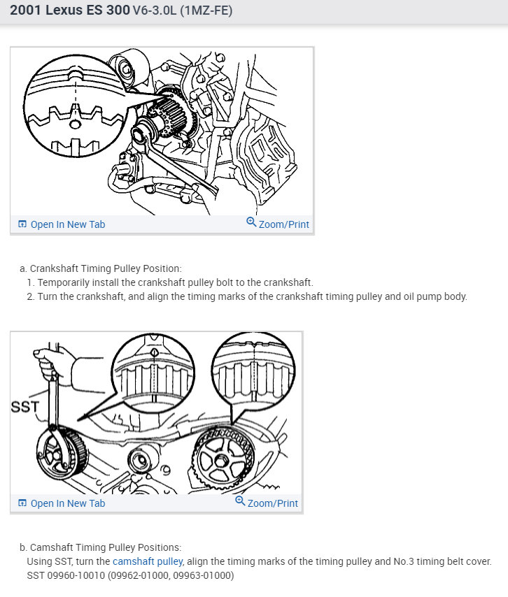

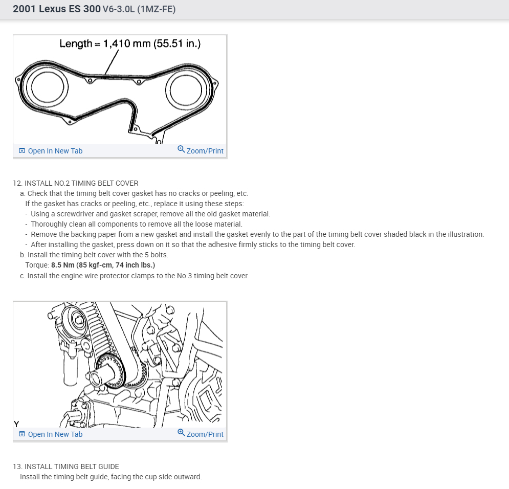

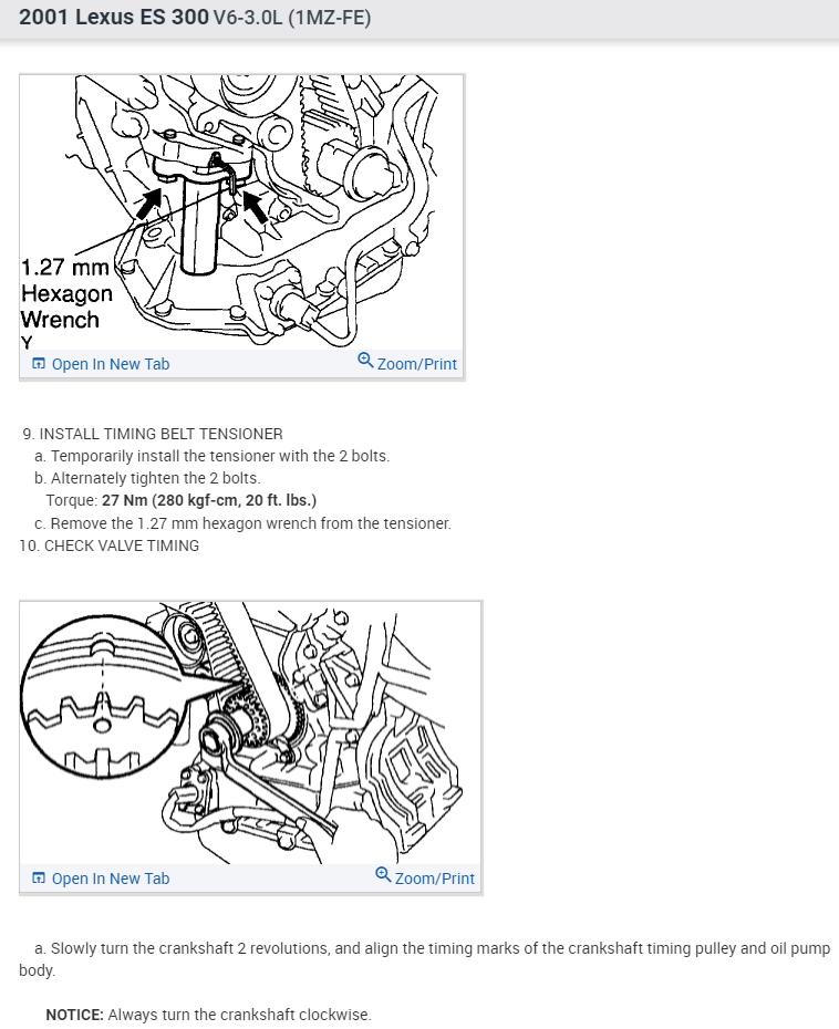

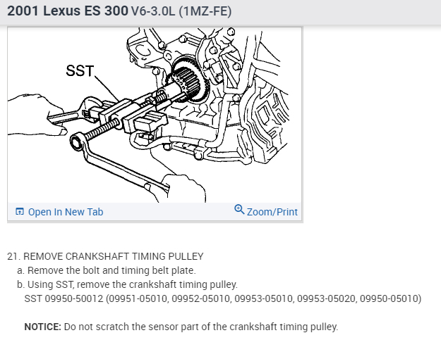

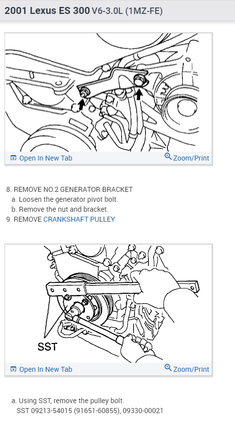

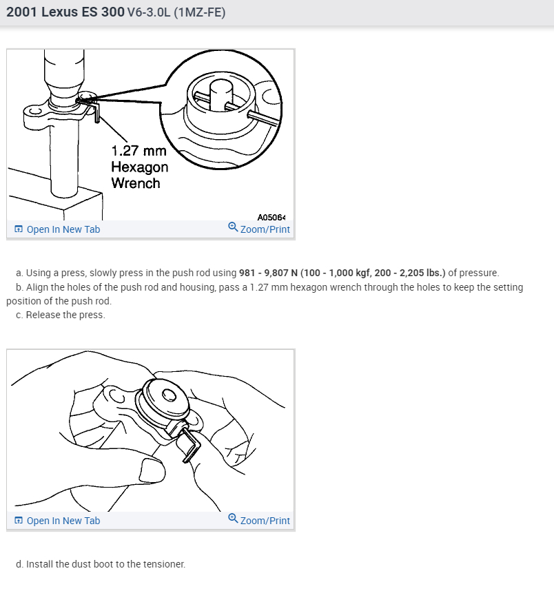

It is recommended to change the timing belt every 90,000 miles on this vehicle.
https://www.2carpros.com/articles/how-a-timing-belt-works

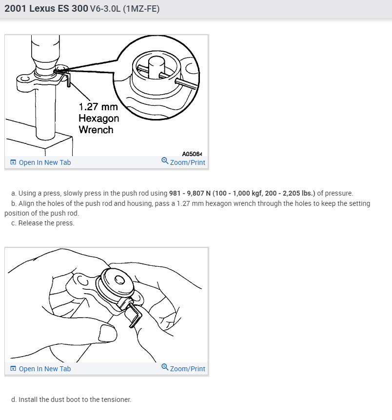

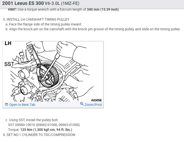

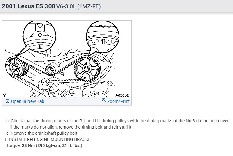

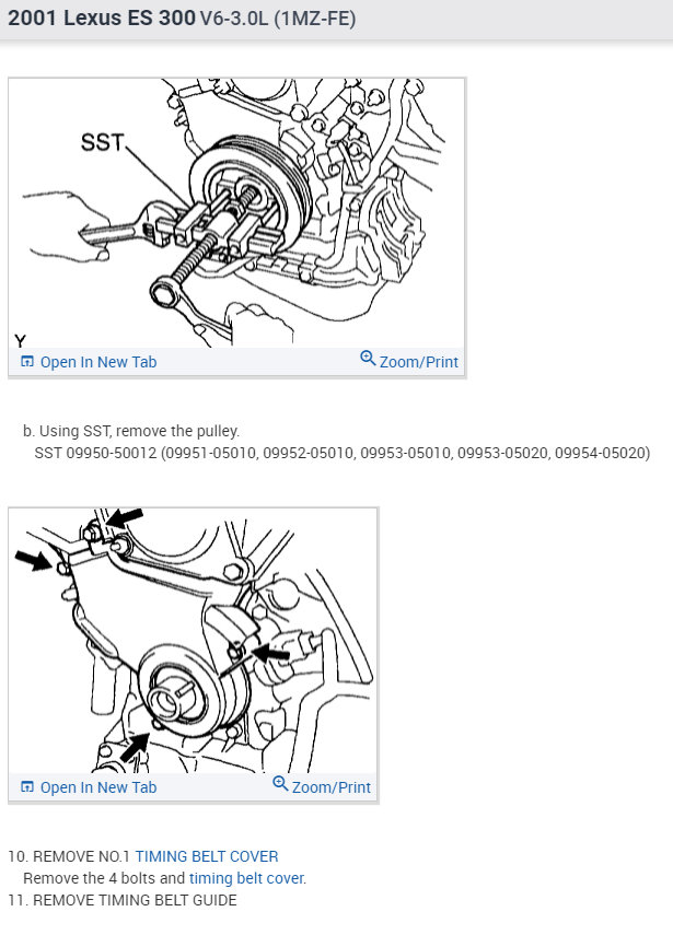

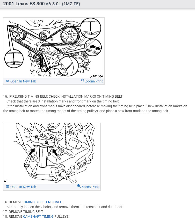

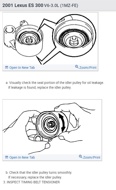

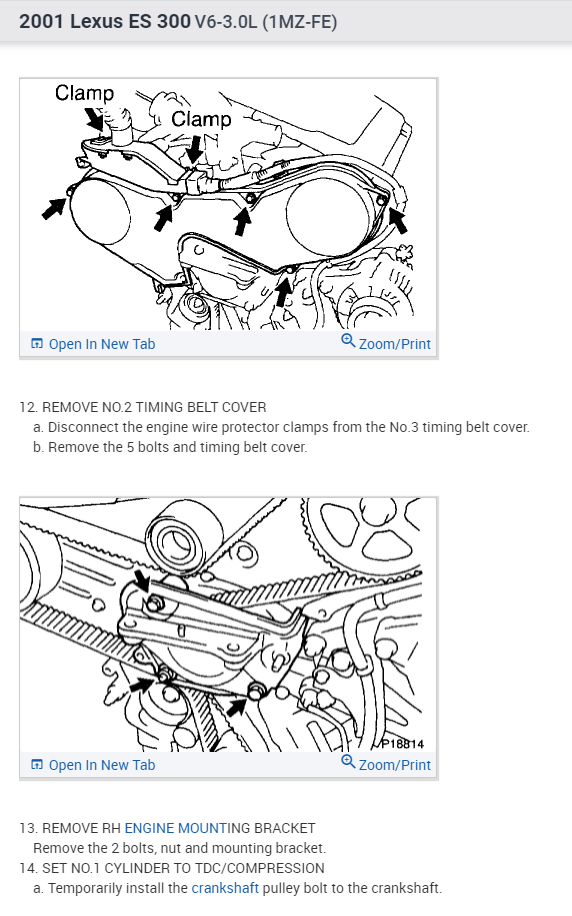

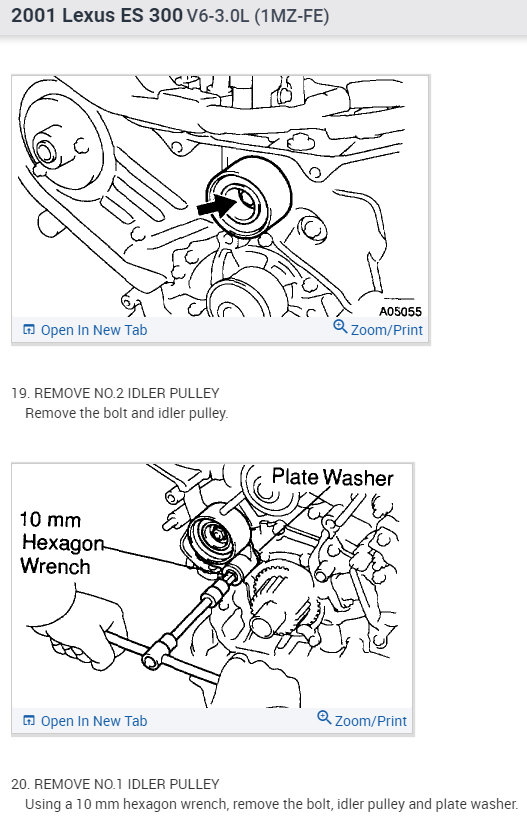

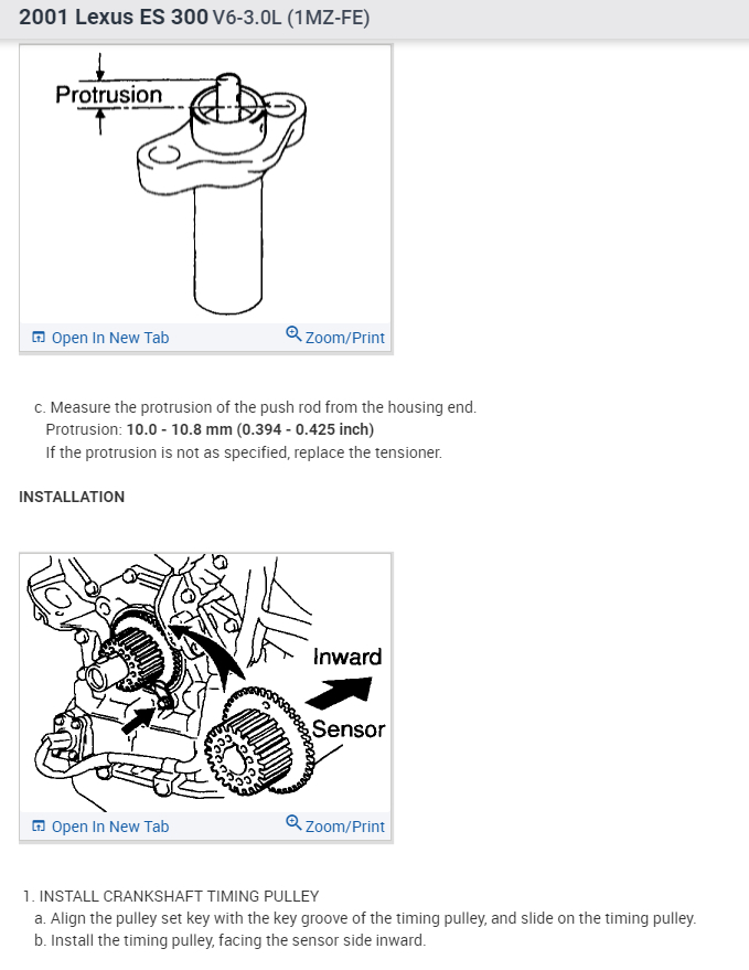

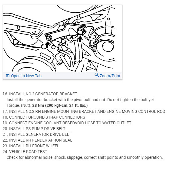

I have attached the replacement instructions below.
