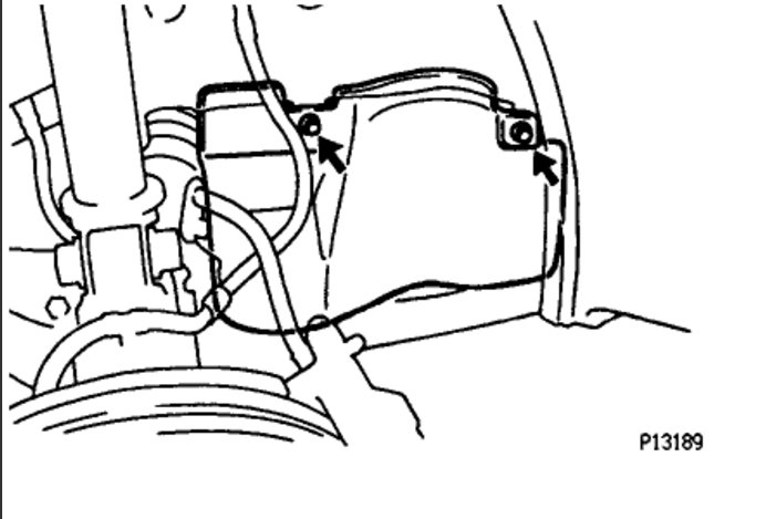

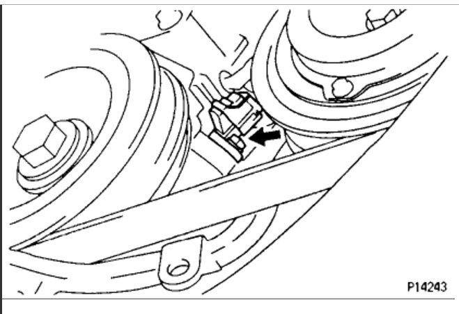

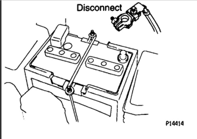

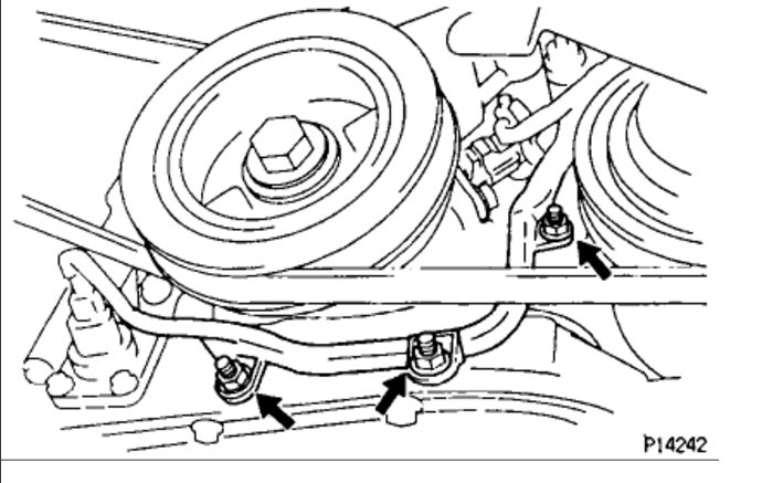

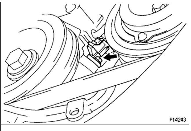

Help i have a problem with my 1994 Lexus Ls400. So i start it up runs fine then i hear rattling. Hesitates when i step on the gas nothing hesitates, then it speeds up so very high like it has a mind of its own. When ignition coil gets overheated it cuts off mechanics help
Aug 21, 2017 at 1:21 PM
  • 55,561 POSTS
It sounds like the crankshaft angle sensor is going bad and the IAC valve needs to be serviced.
Here are a couple guides to show you what you are in for when changing and cleaning to get the car fixed.
and
I would also run the codes to see what come up.
Here is how it is done in your car (below)
