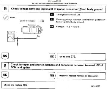

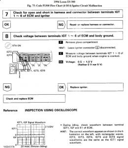

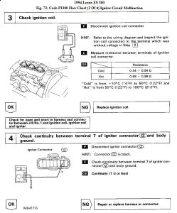

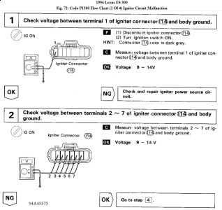

Here are the diagnostic work flow. Go through them and see if you can come up with anything.
https://images.2carpros.com/forum/automotive_pictures/192750_P1300Flow94ES300Fig72_1.jpg
https://images.2carpros.com/forum/automotive_pictures/192750_P1300Flow94ES300Fig73_1.jpg
https://images.2carpros.com/forum/automotive_pictures/192750_P1300Flow94ES300Fig74_1.jpg
https://images.2carpros.com/forum/automotive_pictures/192750_P1300Flow94ES300Fig75_1.jpg

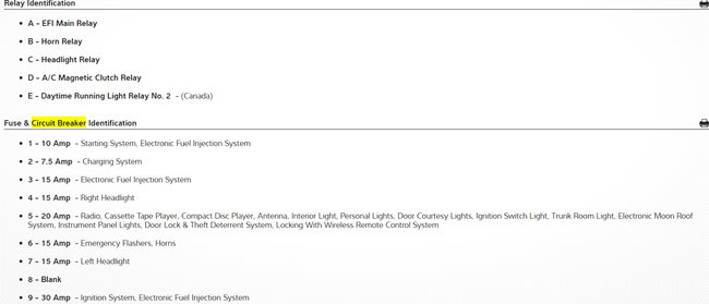

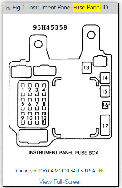

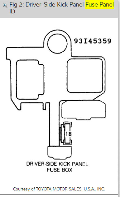

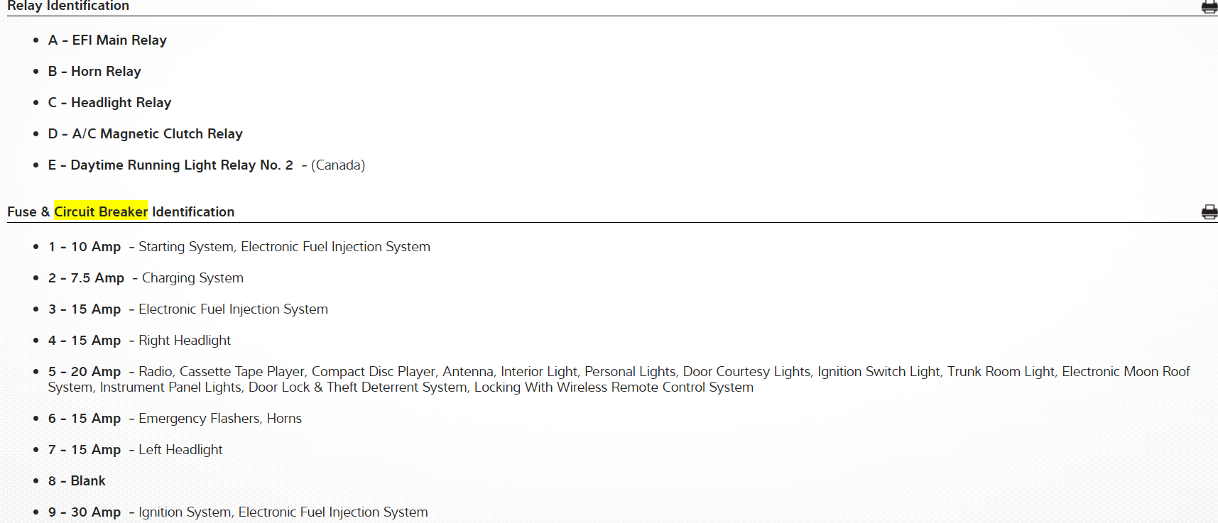

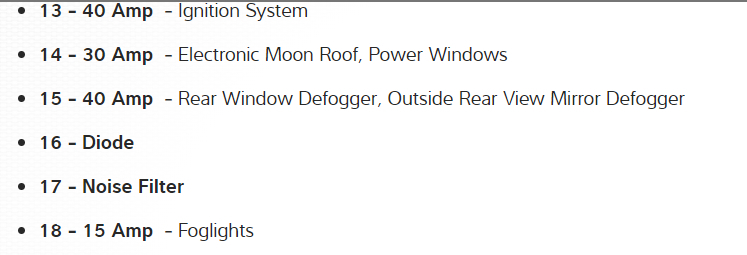

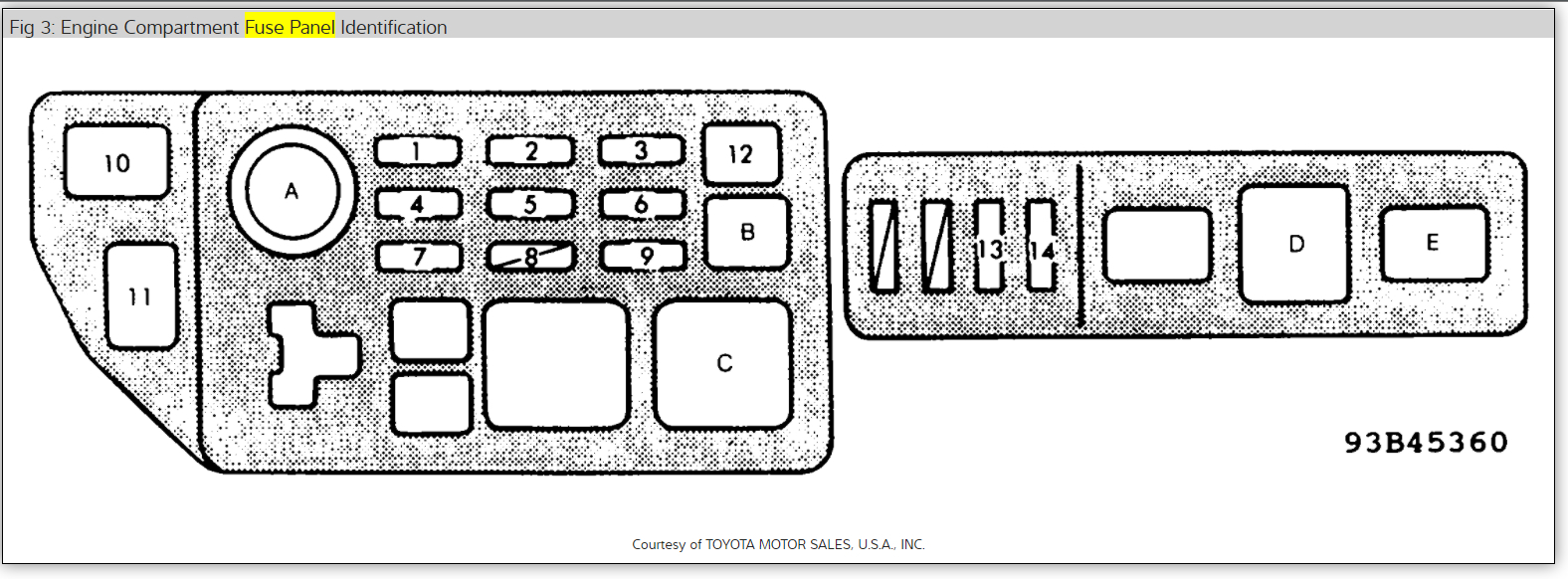

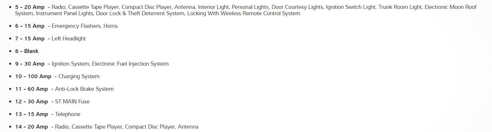

I think the relay he was talking about was the EFI relay which I have seen problems with. Here is a guide to test and the location of the relay.
