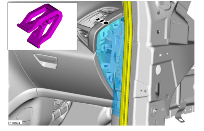

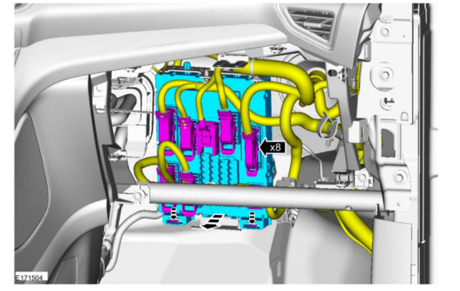

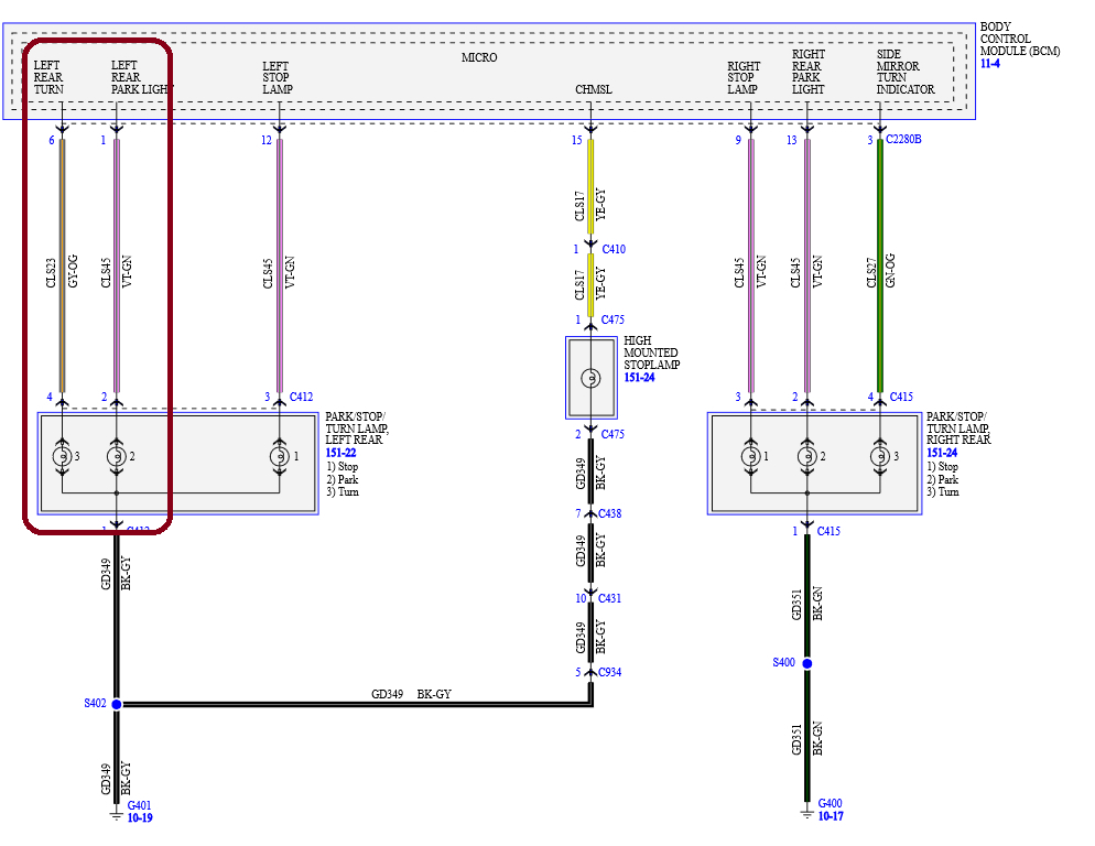

With key out of ignition. Car was parked for about 2 hours when it was noted to me that the left side turn lamps, front and rear, were on.
Steps taken: Turned off DRL Started it up, right side turn signals and hazard flashers work fine. Left side flashes fast however all outside lamps are lit. Turned off, left turn lamps still on. Disconnect battery, wait several minutes, reconnected, same lights on.
Dec 8, 2019 at 8:20 AM
BMDOUBLE
  • 1,139 POSTS
The body control module controls the turn signal operation. There is a short to power either internal to the module, or possibly in the wire harness or aftermarket alarm (if equipped).
Dec 9, 2019 at 6:40 AM

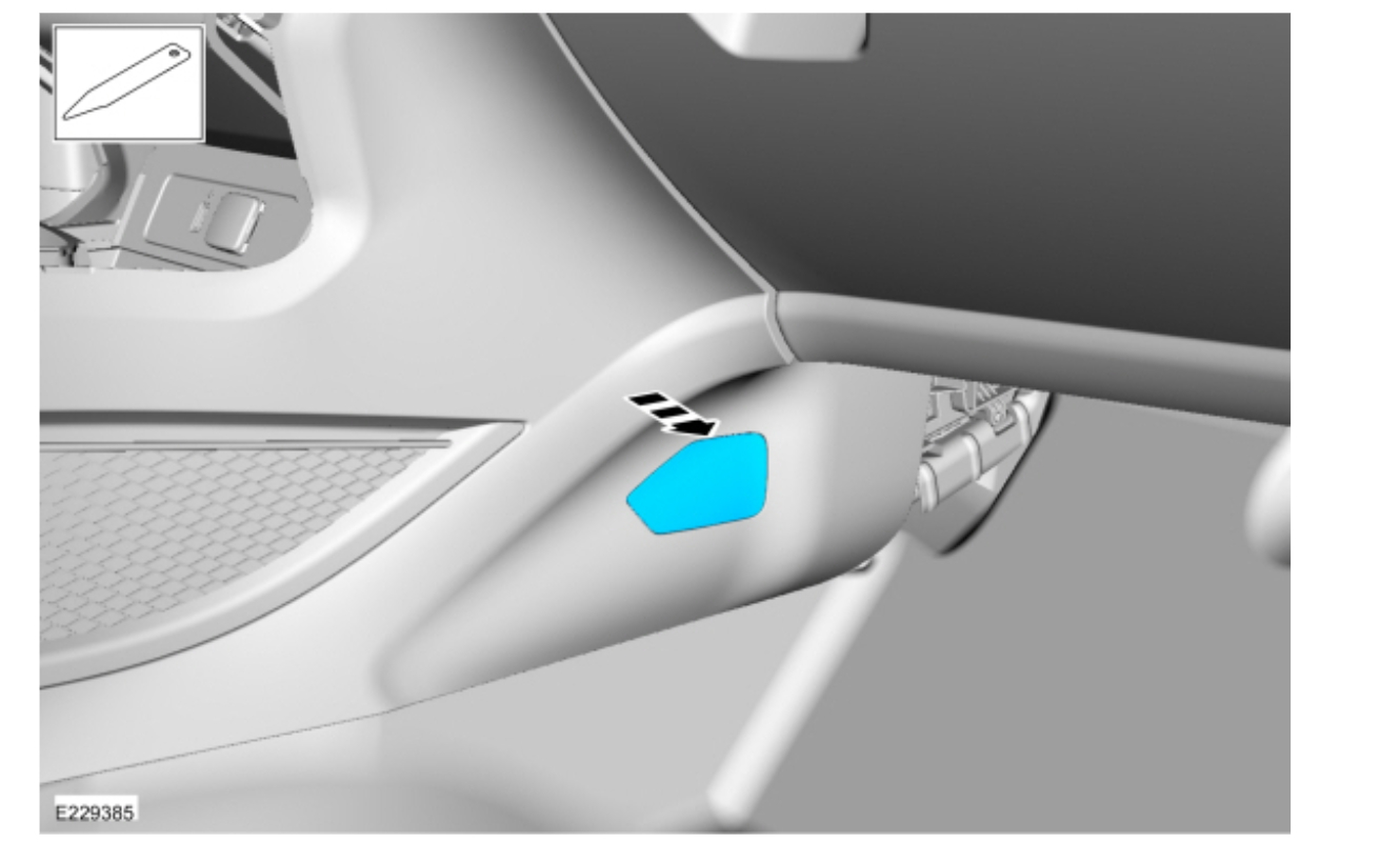

Good morning,
The body control module controls the turn signals based on input from the turn signal switch itself.
When you turn off the key, the only function that should work is the 4 way flashers. That does indicate that there is a fault in the BCM itself.

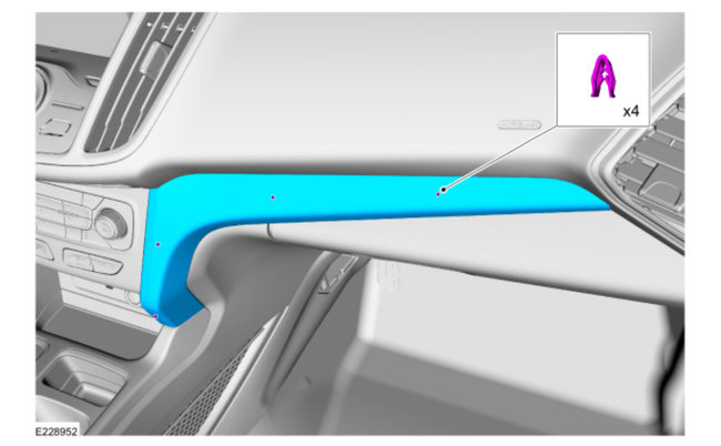

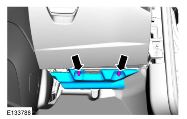

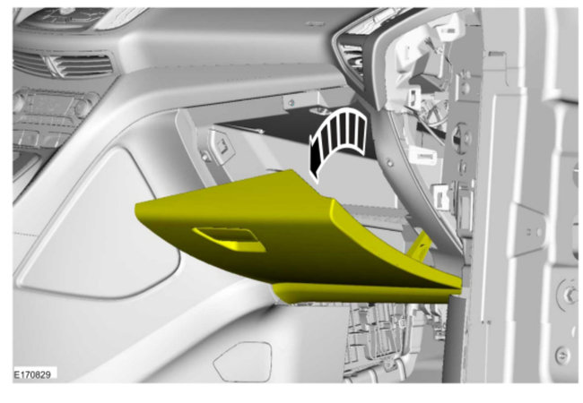

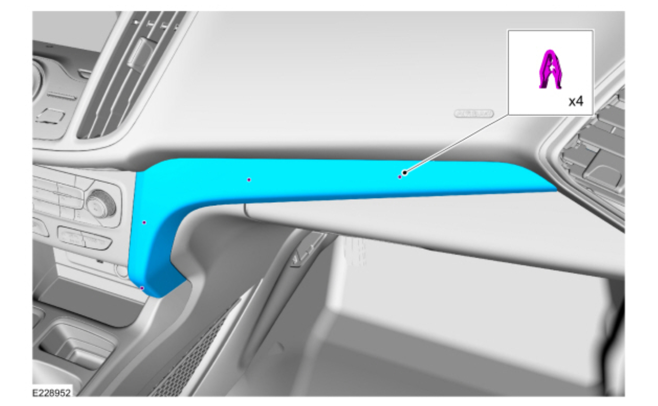

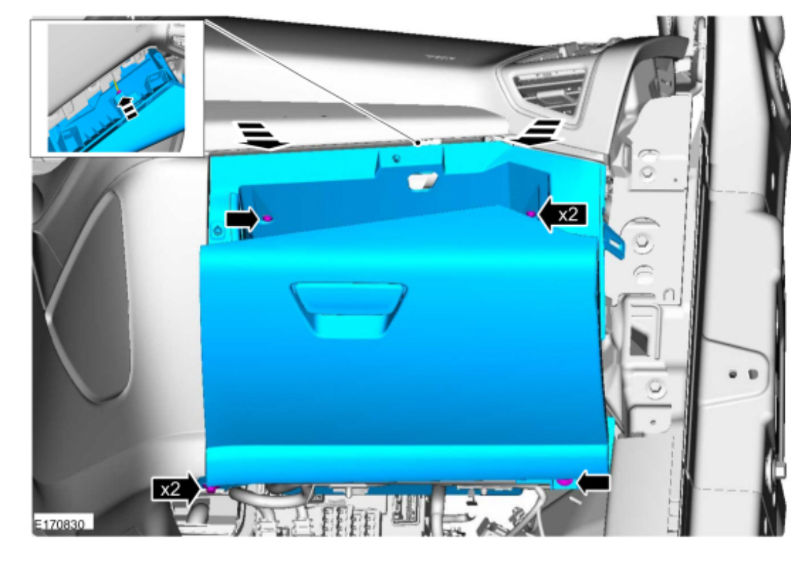

I attached the location and the procedure for the replacement. You will need the Ford IDS scan tool to program the module.
The BCM will have to be replaced and programmed.

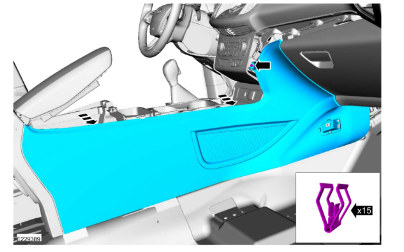

Removal
NOTE: If installing a new BCM , verify at least 2 of the vehicle keys are available prior to carrying out this procedure.
NOTE: If installing a new module, it is necessary to upload the module configuration information to the scan tool prior to removing the module. This information must be downloaded into the new module after installation.
Upload the module configuration information from the BCM into the scan tool by following the scan tool on-screen instructions.
Refer to: Module Configuration - System Operation and Component Description (418-01 Module Configuration, Description and Operation) .
Remove the 2 instrument panel insulator retainers and the instrument panel insulator.
Position the front door weather-strip aside and remove the instrument side trim panel.
Detach the clips and remove the RH instrument panel lower finish panel.
Remove the RH cover.

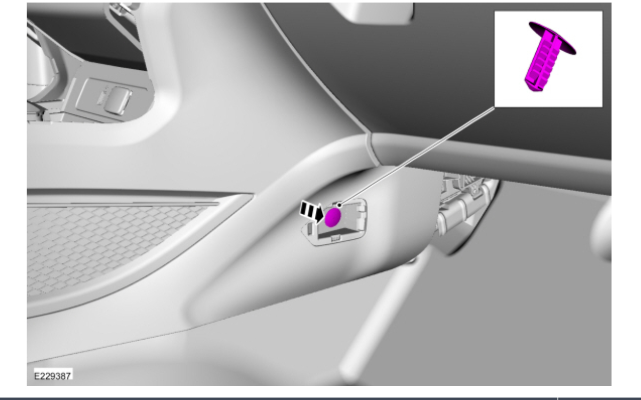

Remove the RH push pin.
Remove the bolt, release the clips and remove the RH floor console finish panel.
Torque : 22 lb.in (2.5 Nm)
Open the glove box door.
Remove the screws and the glove compartment.
Disconnect the electrical connector.
Torque : 18 lb.in (2 Nm)
Disconnect the BCM electrical connectors and remove the BCM .

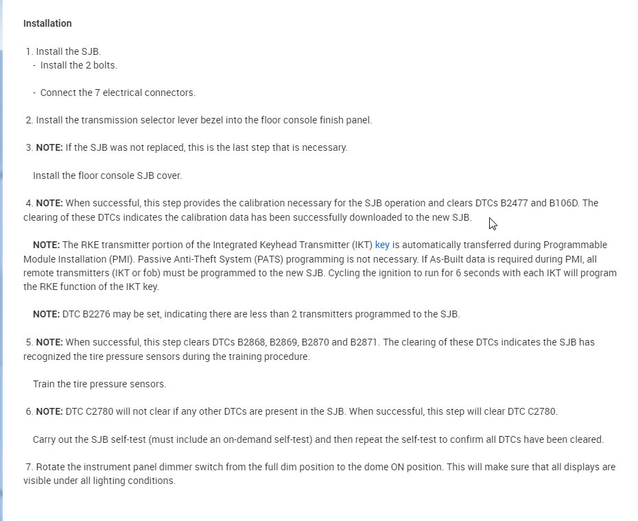

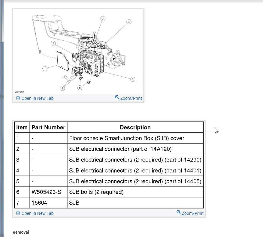

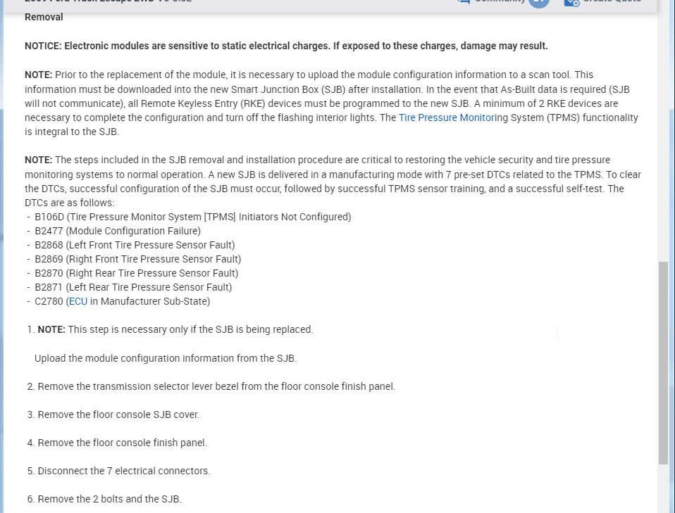

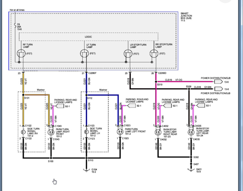

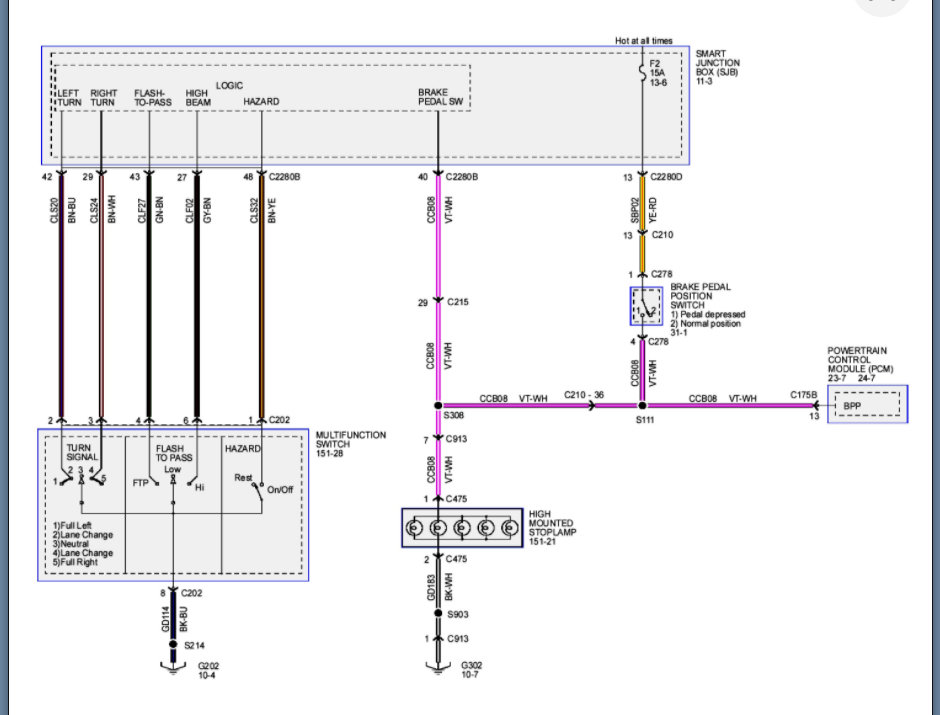

Right rear blinker won't work. New bulb and fuse put in. Lights up when lights are turned on but not with 4-way flasher. New to this site. Could it be a relay? But doesn't the relay work both sides of the blinkers on the same relay? Please help
Nov 26, 2020 at 1:08 AM (Merged)
You actually don't have a flasher for this vehicle. You have what is called a smart junction box. As you can see the SJB controls the operation of this so if the flashers are the only thing not working but the bulb does the SJB is most likely the issue.
I attached the info that you need but I would suggest just testing voltage from the switch to the SJB when you turn the flashers on and just make sure the switch is sending the input to turn them on. If it is then the SJB is not sending the signal to operate that side. You can assume it is since you have the other side operating.

It's not just the turn signals that don't work--the flashers and interior dome light also do not work. We replaced the 25A fuse for turn signals and dome lights listed for this area with no change. We replaced the column switches with no change. All other lights are working properly as do the windows, door locks, radio, etc. We're looking now for a short or grounding problem. Would appreciate helpful feedback.
Nov 26, 2020 at 1:09 AM (Merged)
  • 110,244 POSTS

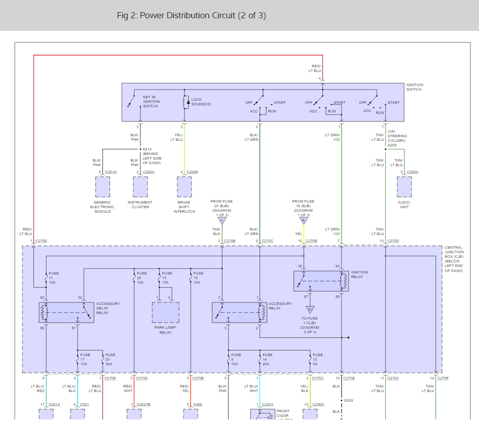

There is a fuse #2 and #3 that need to checked for power. Here is a guide to help us get started and the blinker wiring diagrams so you can see how the system works.
If you have power it sounds like the smart junction box has gone bad.
Check out the diagrams (Below). Please let us know what you find. We are interested to see what it is. Cheers

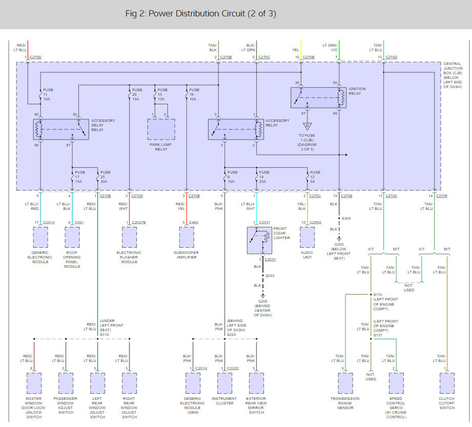

RACHAL JOSSEY

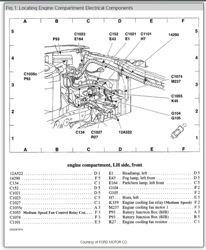

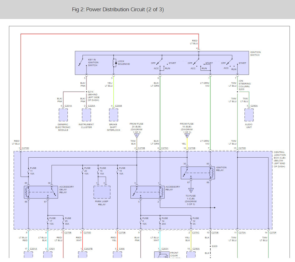

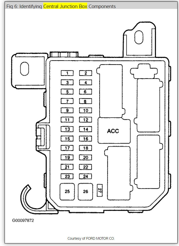

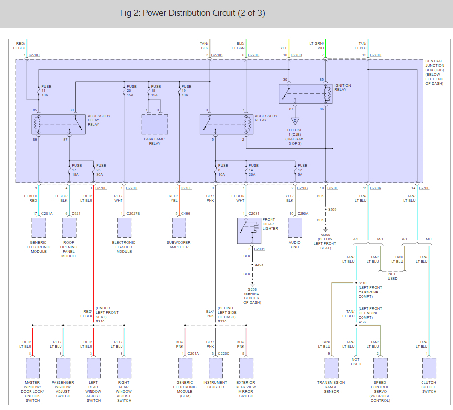

The turn signals, the blower on the AC/heater, and a couple other things like the cigarette lighter only work sometimes. The will cut on and off sometimes or not work at all. They do not work more than they do. Any advice as to where to start. I have tried looking up the electrical diagrams but have not had much luck.
  • 55,433 POSTS
There is an accessory relay that goes bad in these cars which will cause the problem you have described.
Here is its location and a guide to help confirm the failure.
(Accessory Relay) In central junction box.
Here are some diagrams to help locate the relay (below)
Please let us know what happens, we are interested to see what it is.

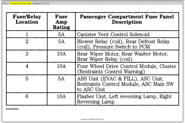

TJASKA
My turning signal on the left side does not work I checked the fuse that is fine.
The light in the dashboard goes on but does not flash.
As I put on the hazard lights it does flash inside but that is all.
I also checked the flasher fuse that is fine too.
What am I missing.

JIS001
  • 3,412 POSTS
Either your flasher has gone bad or you have a bad turn signal switch. Wiggle the turn signal switch around and see if that will make it flash.

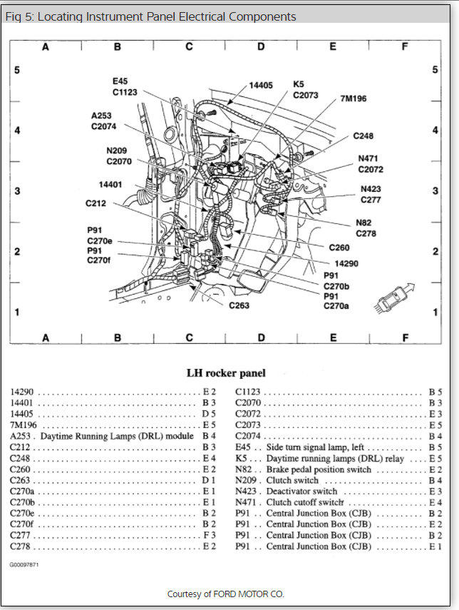

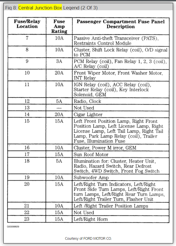

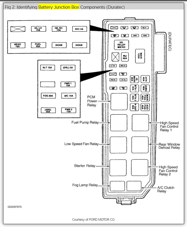

ALSHEPARD5
I have a 2001 Ford Escape. When the headlights are on the left turn signal light on the dash is illuminated. The left turn signal does not work at all when the headlights are on. When the lights are off and the left turn signal is used the clock and dash lights flash with the turn signal. Both of the front turn signals flash along with the brake lights in the back when the left turn signal is used and the headlights are off. The right turn signal is working fine.
HMAC300
  • 48,601 POSTS
check for either a bad bulb with the filaments touching each other or a bad ground on both front turn signals
